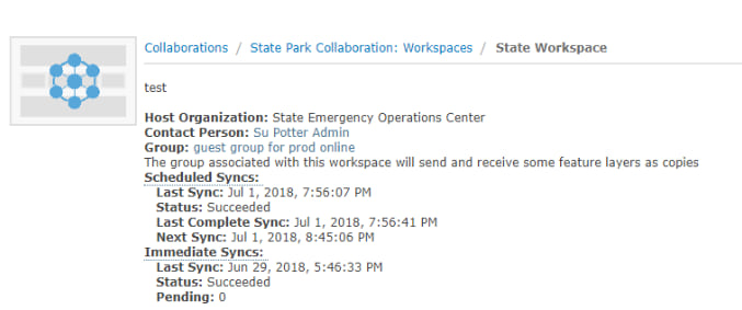

The Sync Workspace option will be available within each collaboration workspace, for all guest participants. The results of the synchronization can be viewed in the Sync Status Report:
![Sync Status Report page in the portal Sync Status Report page in the portal](https://www.esri.com/arcgis-blog/wp-content/uploads/2018/07/sync2-1.png)

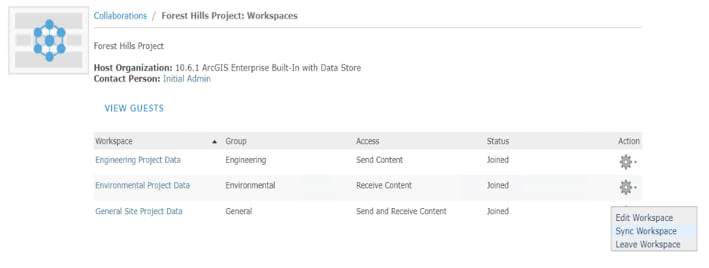

- Navigate to Organization > Edit Settings > Collaborations. Click on the target collaboration’s name, then click on the applicable workspace name.
- Click the Action cog to the right of the workspace. The drop-down list will include the Sync Workspace option, as shown below:
![Sync Workspace option Sync Workspace option](https://www.esri.com/arcgis-blog/wp-content/uploads/2018/07/sync3.png)

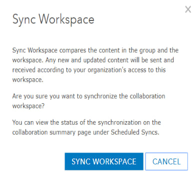

Click Sync Workspace, and on the resultant dialog, select Sync Workspace to begin synchronizing your content.

To view the status of the on-demand synchronization, review the Scheduled Syncs section of the Sync Status Report for the collaboration workspace. The Sync Workspace option will be greyed out until the synchronization job completes.
