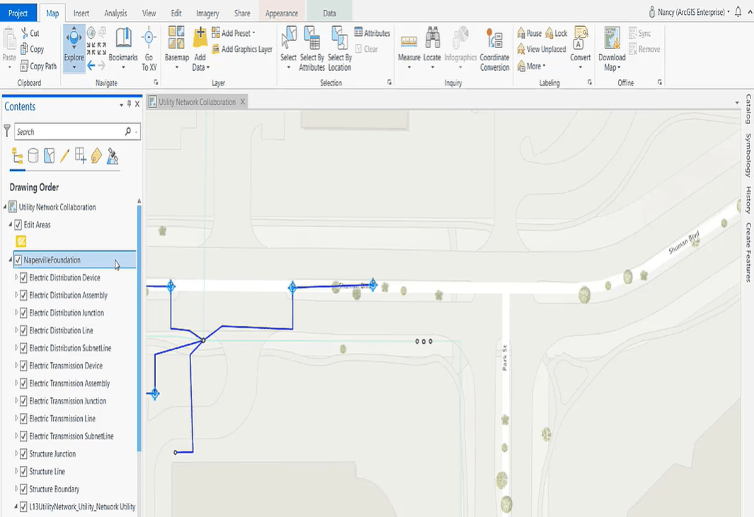

Frist, Daniel, as a GIS administrator, created a project in ArcGIS Pro that referenced the Naperville Foundation Utility Network service with the demo SOI extension enabled on it. The project also included a collaboration layer labeled Edit Areas.

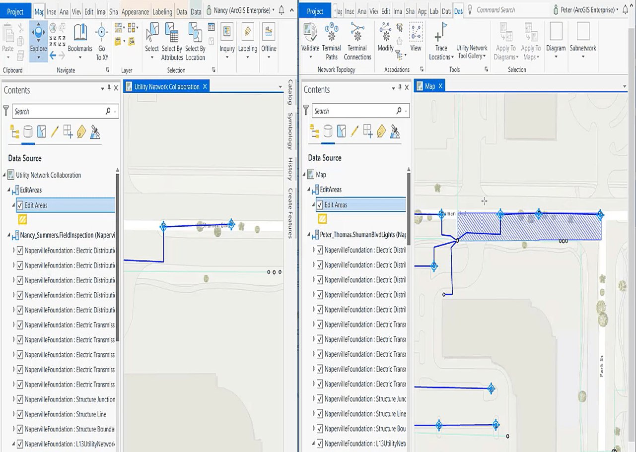

Next, he showed the workflows of two fictitious GIS users in his organization—Peter and Nancy—working on the same portion of the network but in different branch versions. Peter was designing an extension of the low voltage line to add more streetlights along the boulevard, and Nancy was integrating data gathered from a field inspection.
On Peter’s map, the areas highlighted in blue represent dirty areas, which are created automatically when users edit features that are part of a utility network. Dirty areas indicate potential changes to the network that have not yet been reflected in the network topology.

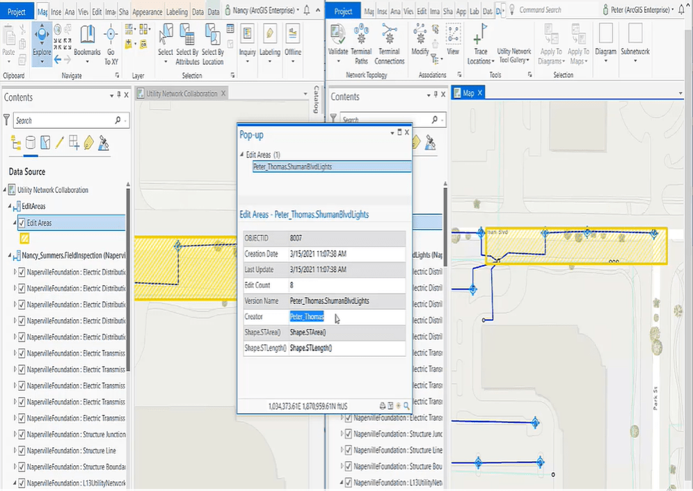

After making the required edits, Peter clicked the Validate command in the Network Topology group, which triggered the demo SOI to intercept the request made to the REST operation and invoke the processing of the dirty areas.
The SOI instantaneously populated the Edit Areas collaboration layer with a new edit area highlighted in yellow on Nancy’s and Peter’s maps. This lets Nancy know that another GIS user is making edits in the same area simultaneously.
The edit areas remained on both maps until Peter’s version was deleted. The demo SOI then intercepted a subsequent request to process the removal of the edit areas from the “Edit Areas” feature class.

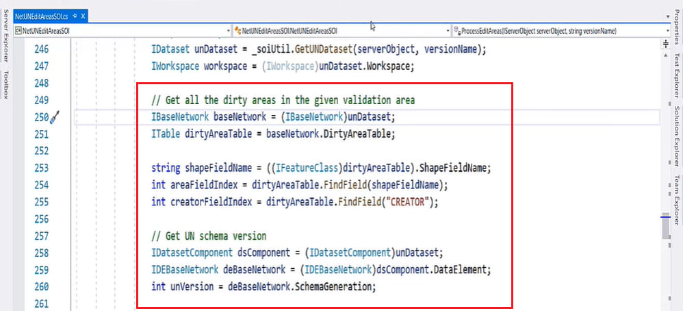

Finally, Daniel highlighted the two Utility Network API interfaces that powered the demo SOI: the IBaseNetwork interface and the IDEBaseNetwork interface.
