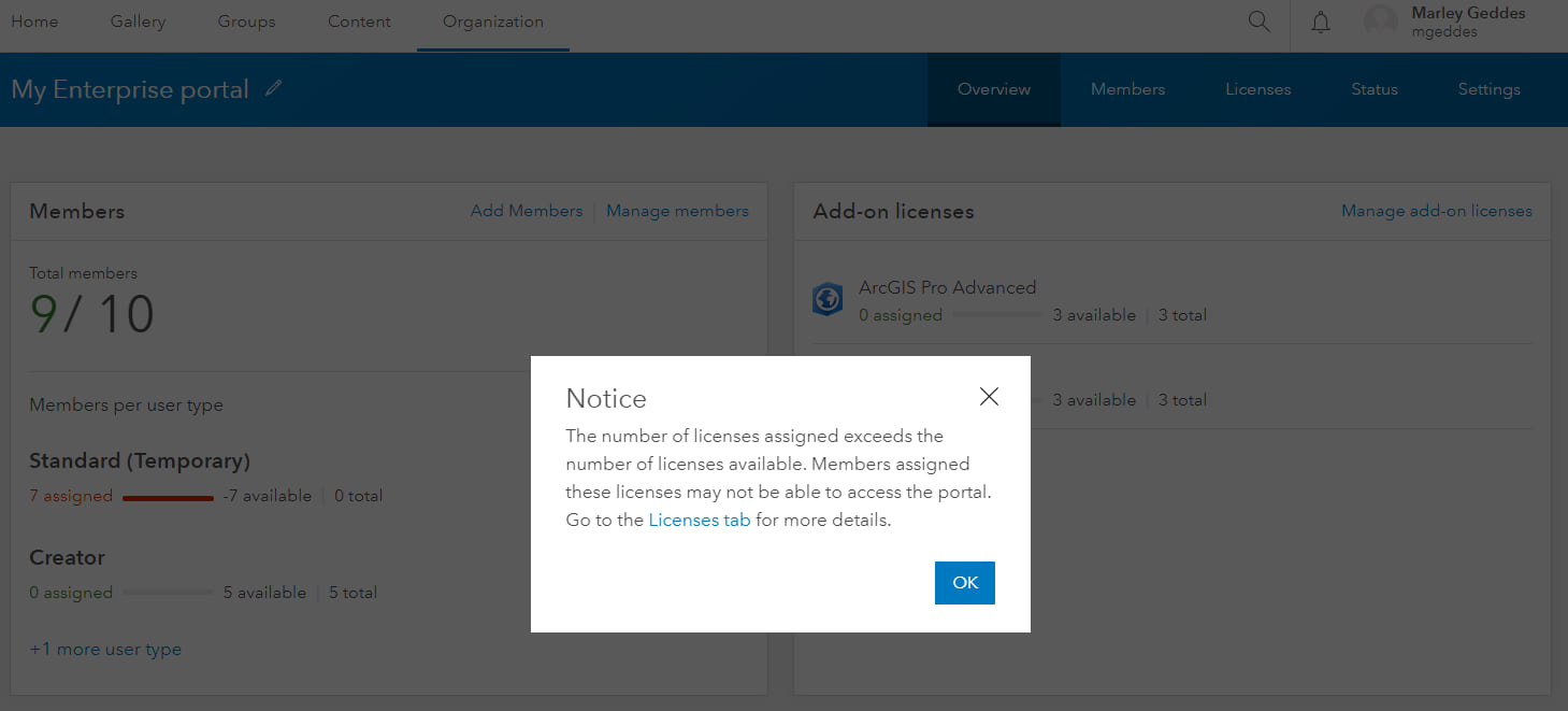

The Overview tab under Organization gives you a summary of your user types and add-on licenses, including the number of licenses you have assigned and those still available. For example, here I can see that I have 10 users in my license and I have assigned 8 of them.
new layout of organization page

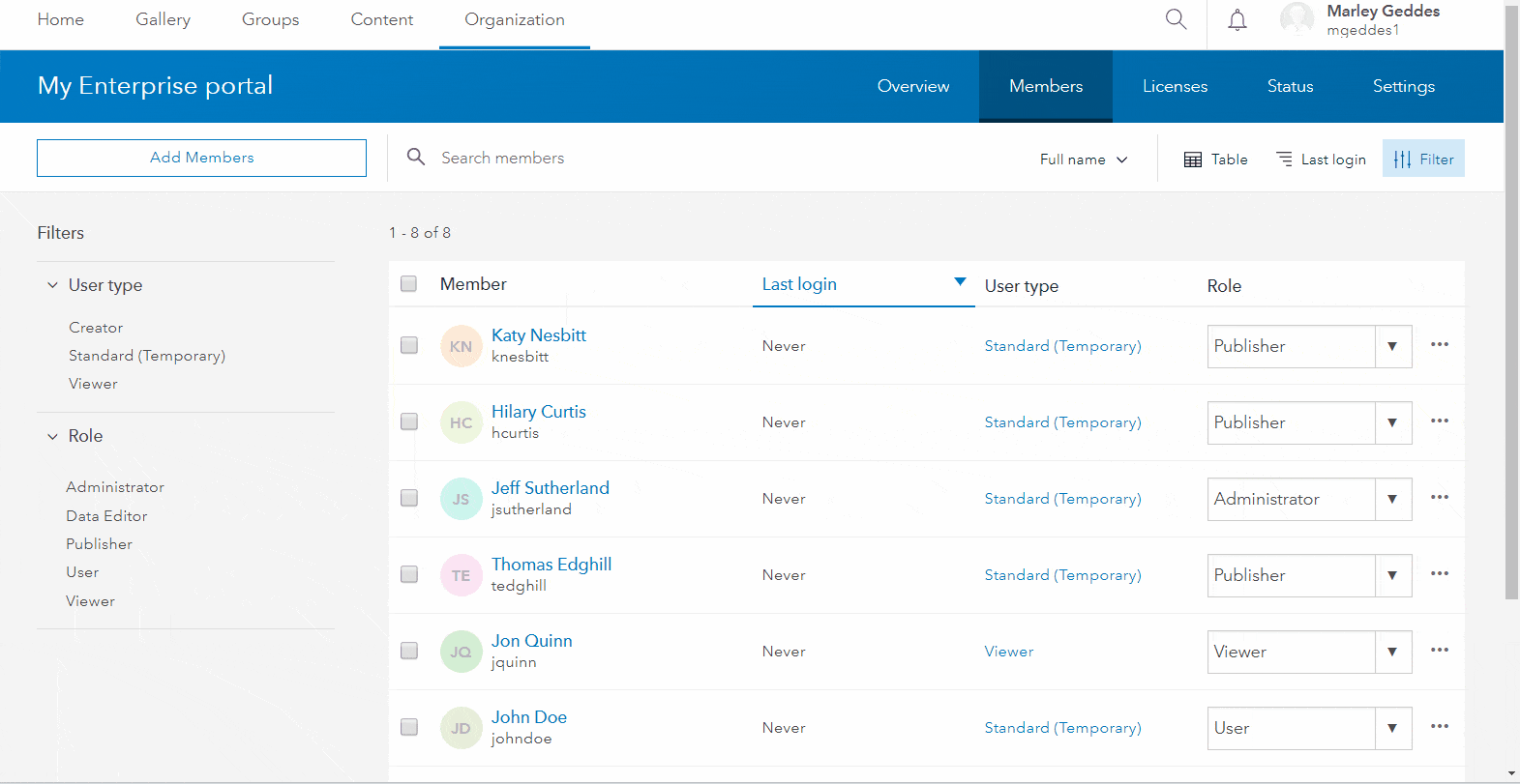

The Members tab contains information about the user type and role for each member of your organization and provides the flexibility to assign these to each member as you see fit. For example, I can see that John Doe has been assigned a Creator user type and is assigned the Publisher role.
portal members tab

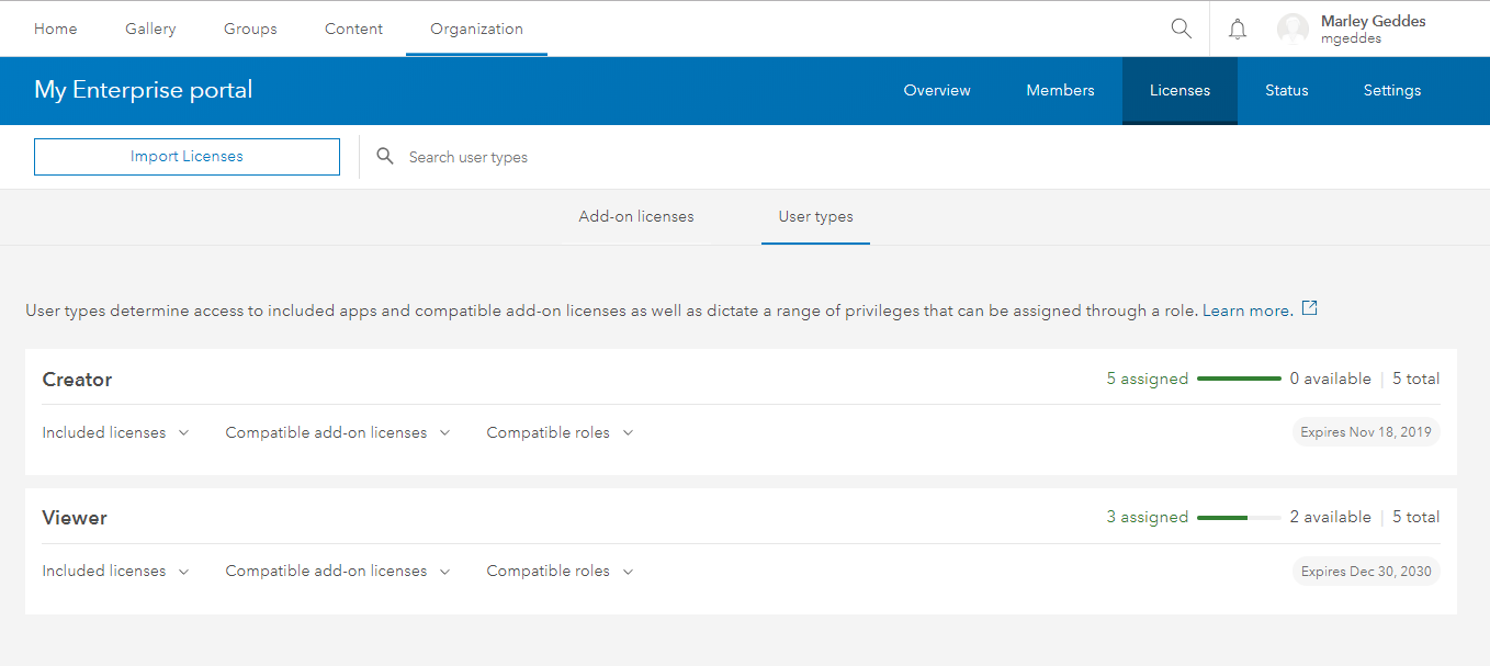

The Licenses tab shows the user types and add-on licenses available and allows you to assign and unassign licenses as needed. The User types tab is a good reference point for what licenses are included or compatible with each user type, and shows when the license for each user type will expire.
portal licenses tab with available user types

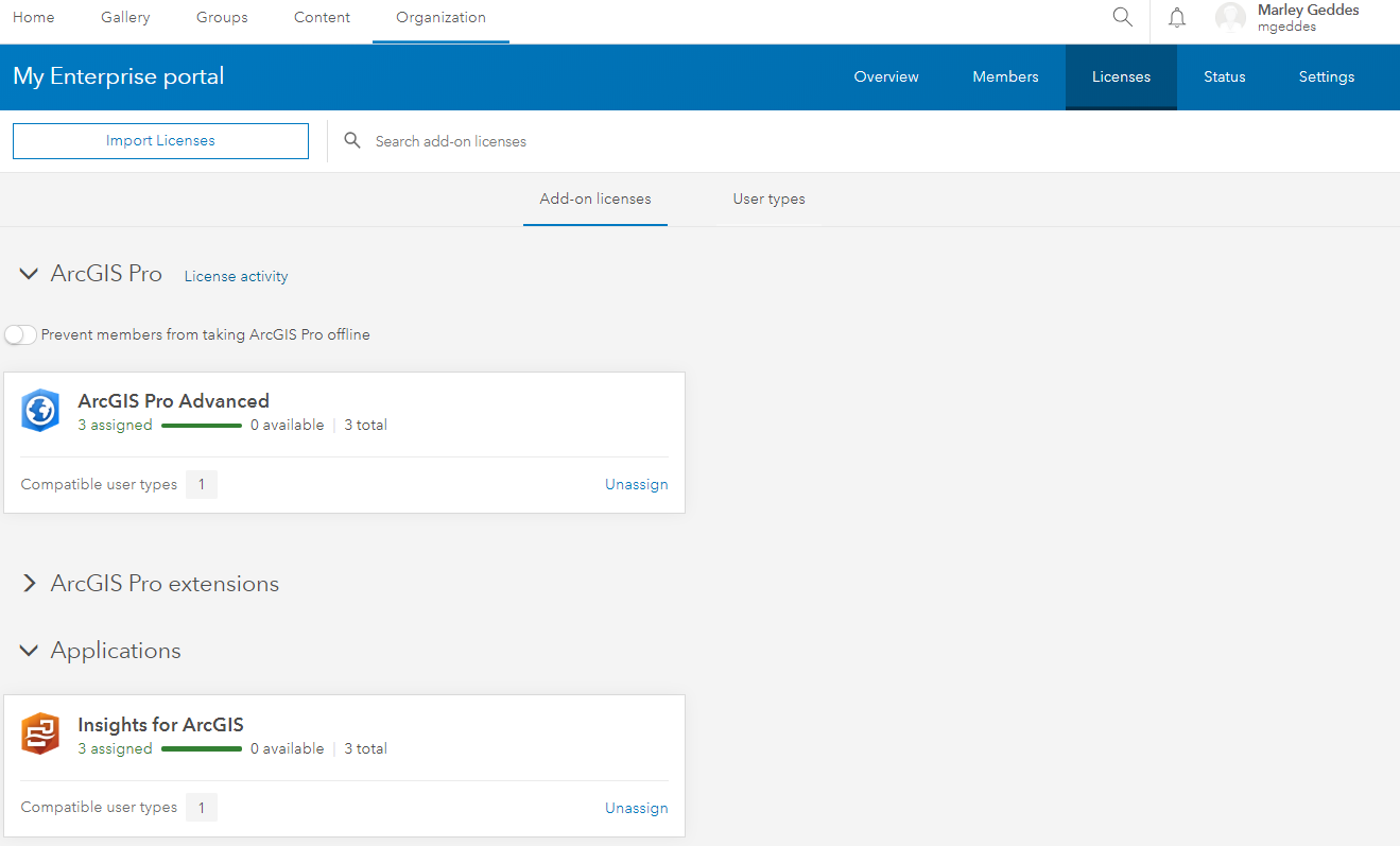

The Add-on licenses tab shows you which add-on apps are licensed and allows you to assign or unassign licenses to your users as needed.
portal licenses tab showing add on licenses available

If you are in this situation, you will receive a notice when signing in that the available licenses assigned in the portal exceeds the number of licenses available.
notice that portal licensing is in overdraft

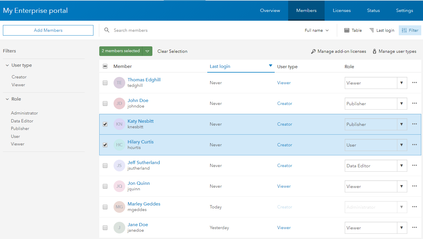

Managing user type licenses is done on the Members tab. You can update the user type for individual members or you can select multiple members and update their user type in bulk. If most of your members are assigned a temporary user type after upgrading, you will want to reassign you members in bulk to save time.
Important: to maintain your members’ current role assignment, you will need to select members assigned the same role before updating their user type. You can do this by filtering for both user type and role. If you select multiple members with different roles, the bulk action will assign the Viewer role to all selected members. At 10.7, new filter options have been added to the Members tab making it easier to select members by role.
reassigning user types in bulk using filter by role
