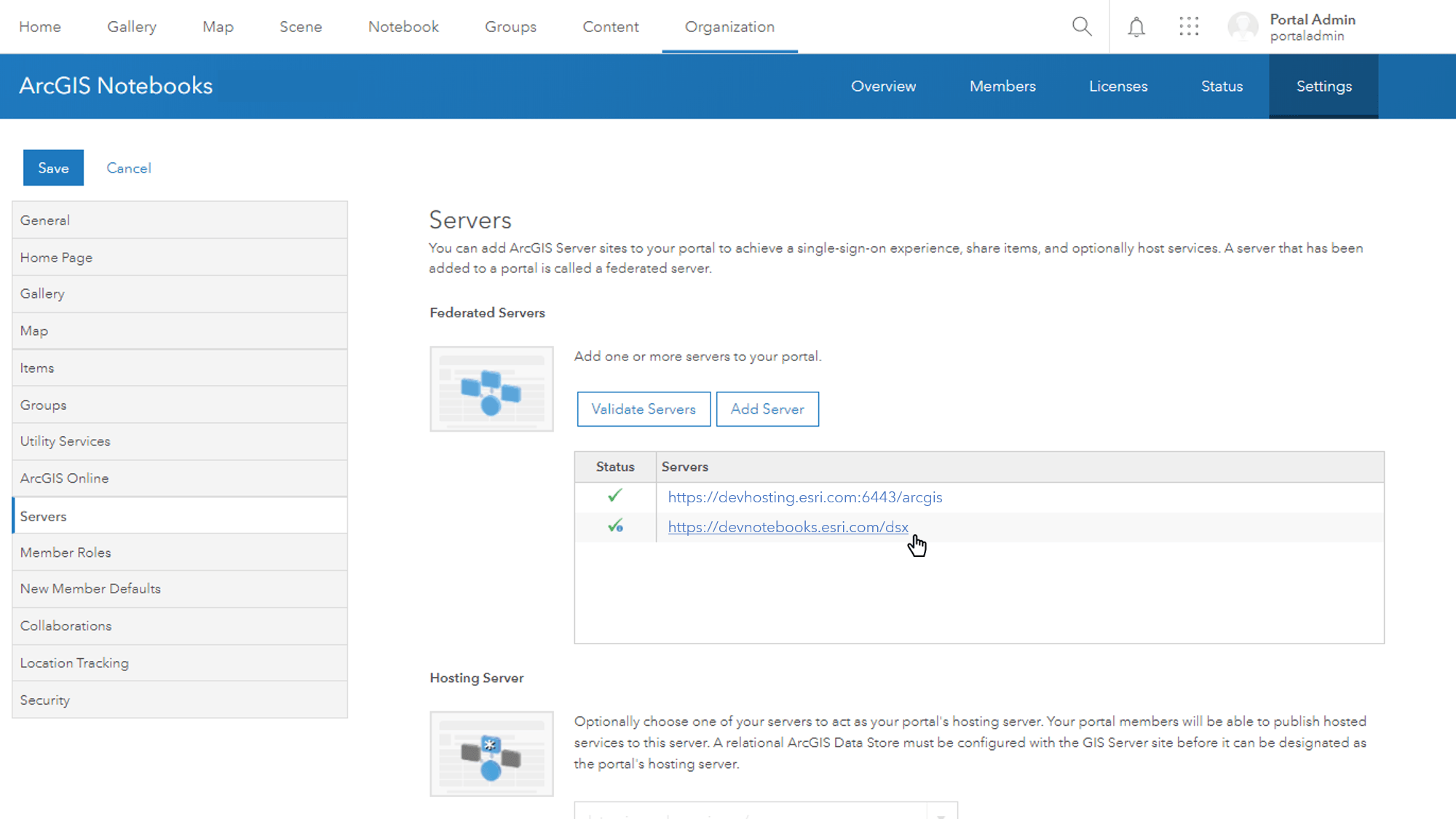

Only portal members with administrative privileges can access ArcGIS Notebook Server Manager. To open the app, navigate to your organization’s Servers settings by going to Organization –> Settings –> Servers and then click on your Notebook Server site URL that appears in the Federated Servers box. You can also access the URL directly at https://portal.example.com/portal/home/notebook/manager.html.

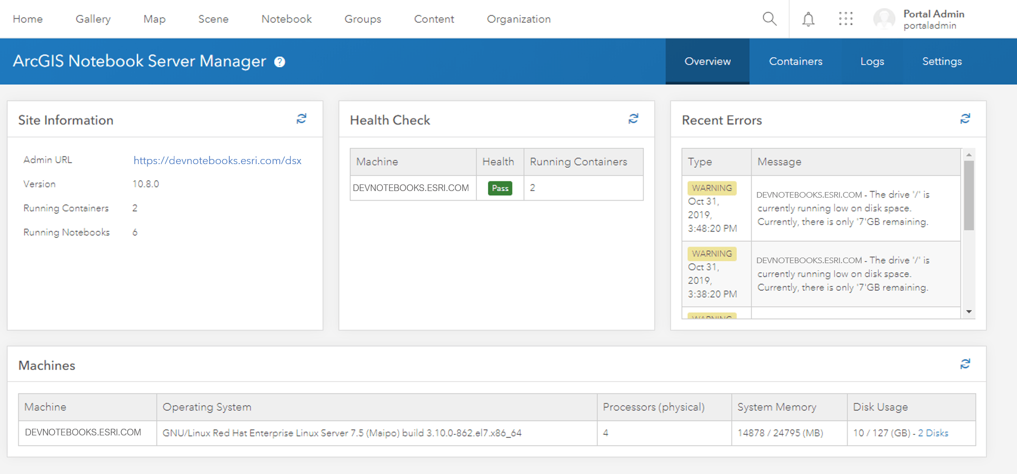

The Overview page provides an at-a-glance look at the health and operation of your Notebook Server. Any element can be refreshed on-demand to provide up to the minute statistics.

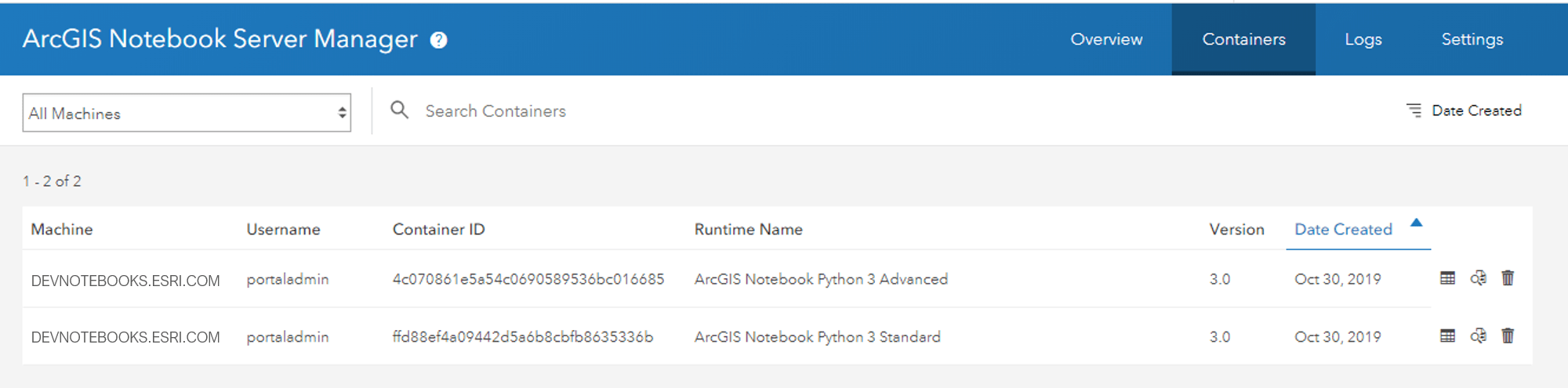

The Containers page provides details for all containers currently running on the Notebook Server. On this page, you can filter for specific containers, users, or runtimes; drill down into the specific logs or statistics for each container; or delete a container.

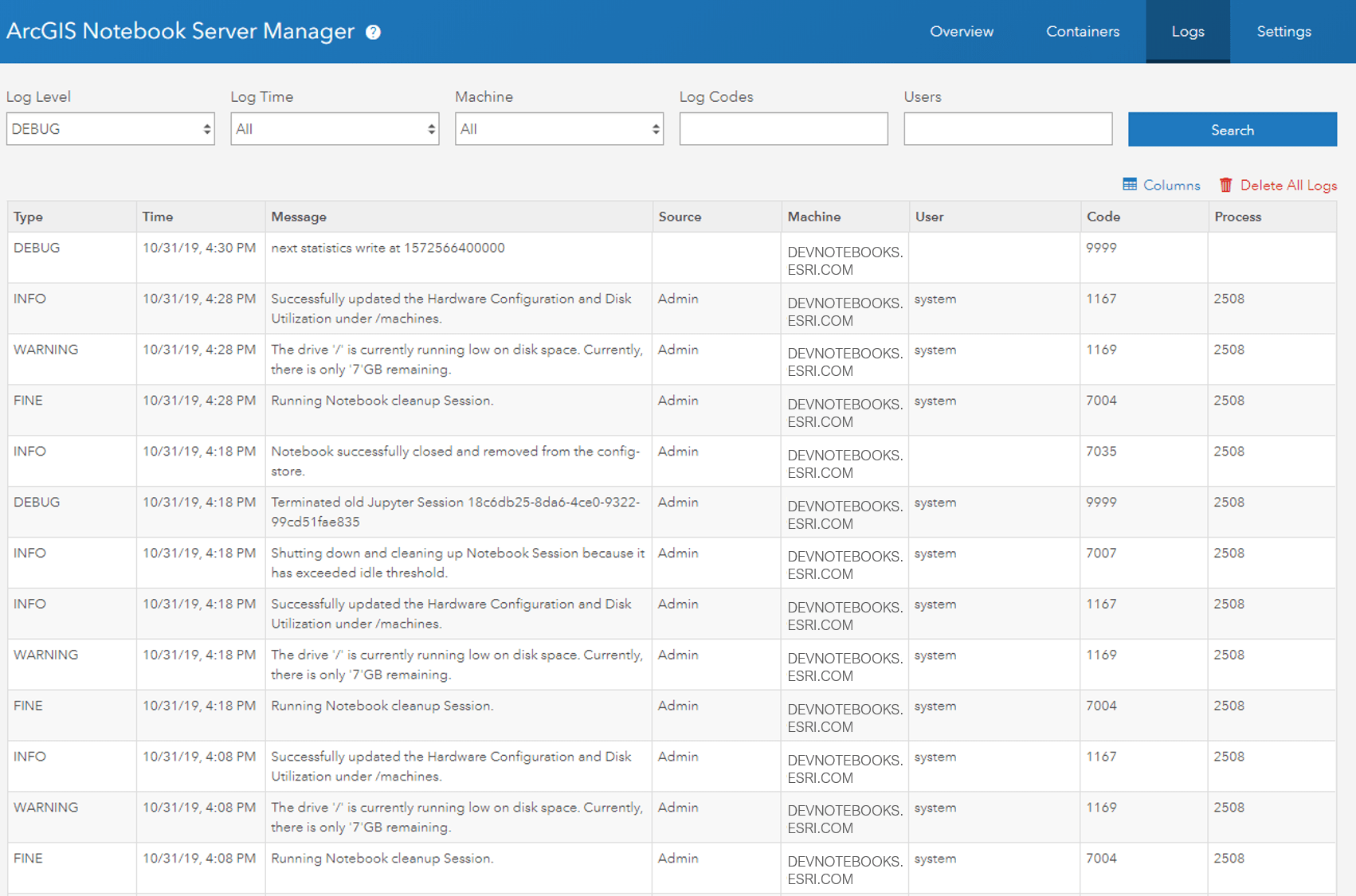

As the name suggests, the Logs page gives you access to Notebook Server logs. You can use drop-downs to quickly filter based on log level or time period, and by machine. You can also search logs for specific codes or user accounts.
To apply a filter or search, adjust the drop downs and search terms as desired and then click the blue search button. Any column in the log view table can be toggled on and off to provide a more focused view of your logs.
