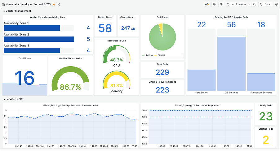

For his demonstration, Chris has set up an ArcGIS Enterprise on Kubernetes deployment. Chris shows us his Grafana dashboard to highlight the current properties of the cluster:
  • Almost 70 cores
  • 264GB RAM
  • Almost 230 running pods (including stateful sets, published and system services, and framework application pods)
Figure 1: The Grafana dashboard, which reflects the current state of the Kubernetes cluster.
Chris will reference this Grafana dashboard throughout his demonstration to check in on how the cluster is performing.

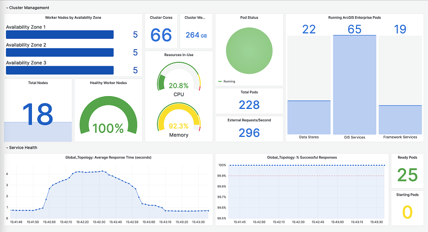

As the chaos monkey does its job terminating nodes, Chris once again uses his Grafana dashboard to show how this is impacting the cluster.
Figure 2: The same Grafana dashboard referenced earlier in the demonstration. The system is responding to the chaos monkey, ensuring that critical services and response times remain unaffected.
We can see that replacement nodes are being added to each availability zone to help the cluster return to its desired state. And though there are small variations in the average response time, there is no observable difference in behavior.
