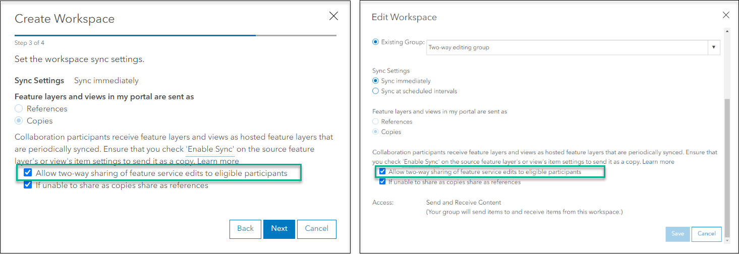

How to configure workspaces:
Shared editing can be enabled for collaboration workspaces fulfilling the following pre-requisites.
- ArcGIS Enterprise collaboration workspace created at version 10.9 or higher
- Guests will need to have send and receive access within the workspace to send and receive data edits
- Ensure that the ‘allow two-way sharing of feature service edits to eligible participants’ collaboration workspace setting is checked for both the host and guest
For more detailed information on how to configure a workspace in a collaboration, please consult our documentation: Create a collaboration and workspace.

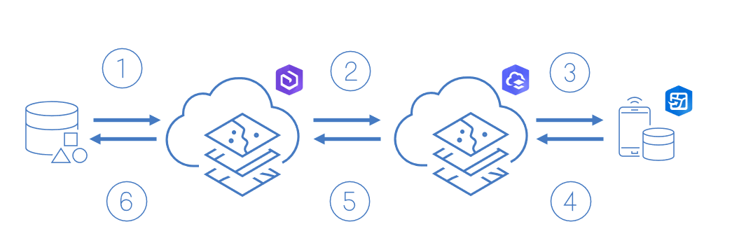

The following is an overview of high-level steps to use distributed collaboration for shared editing between ArcGIS Enterprise, ArcGIS Online and ArcGIS Field Maps
- Publish and configure ArcGIS Enterprise feature layers for shared editing. Create a web map using the published feature layers.
- Share the web map and feature layers to a distributed collaboration workspace between ArcGIS Enterprise and ArcGIS Online configured to share feature layers as copies with two-way editing
- Create map areas and configure offline settings in ArcGIS Field Maps
- Make edits to the shared feature layers in ArcGIS Field Maps mobile app
- Synchronize data updates from ArcGIS Field Maps mobile app to ArcGIS Online
- Synchronize the distributed collaboration workspace from ArcGIS Enterprise to move the edits between ArcGIS Online and Enterprise
Any edits made in ArcGIS Enterprise will also be synchronized to ArcGIS Online during the distributed collaboration workspace sync. See configure sync settings for more information on sync methods.
