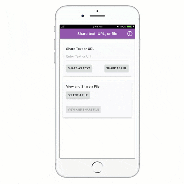

- The Clipboard component’s share method now lets you preview and share files as an image, video, audio, document, etc. When a file URL is copied to the clipboard you can preview and share the file via AppFramework.clipboard.share().
![Share text, URL, or file sample Share text, URL, or file sample](https://www.esri.com/arcgis-blog/wp-content/uploads/2019/10/ShareSheet-2.gif)

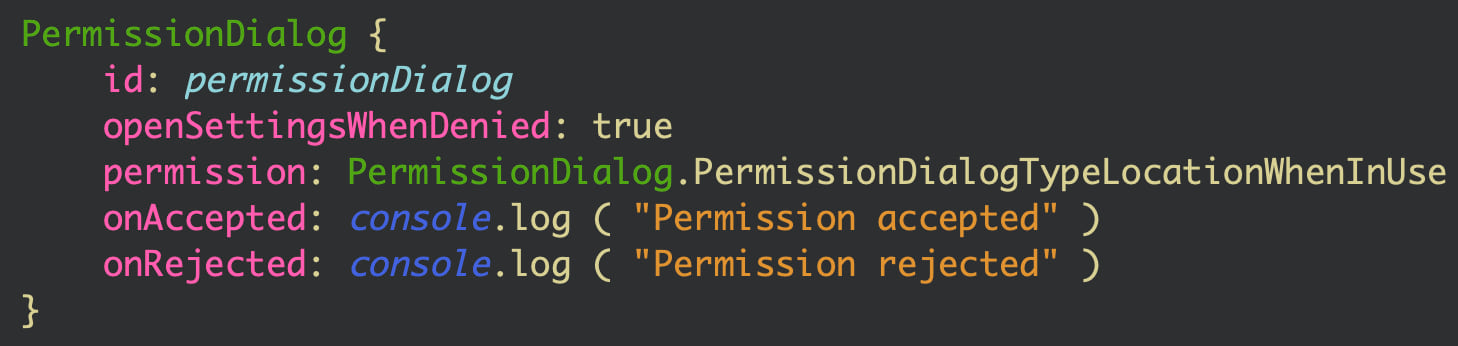

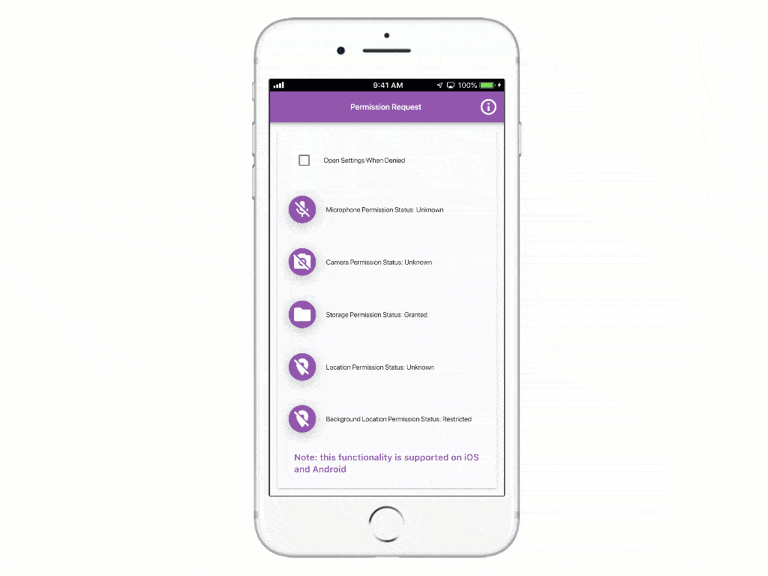

If your app needs permission to access system-wide capabilities such as Location, Storage, Bluetooth, etc., then the app needs to request & grant the appropriate permission in order to function. The PermissionDialog component provides an interface to request permission at runtime.
The snippet below demonstrates how to request permission for the device’s location. By setting the property openSettingsWhenDenied to true, the app opens application settings when permission is denied.
![](https://www.esri.com/arcgis-blog/wp-content/uploads/2019/10/Screen-Shot-2019-10-03-at-1.55.12-PM.png)
![Permission Request sample Permission Request sample](https://www.esri.com/arcgis-blog/wp-content/uploads/2019/10/Permission-iOS.gif)

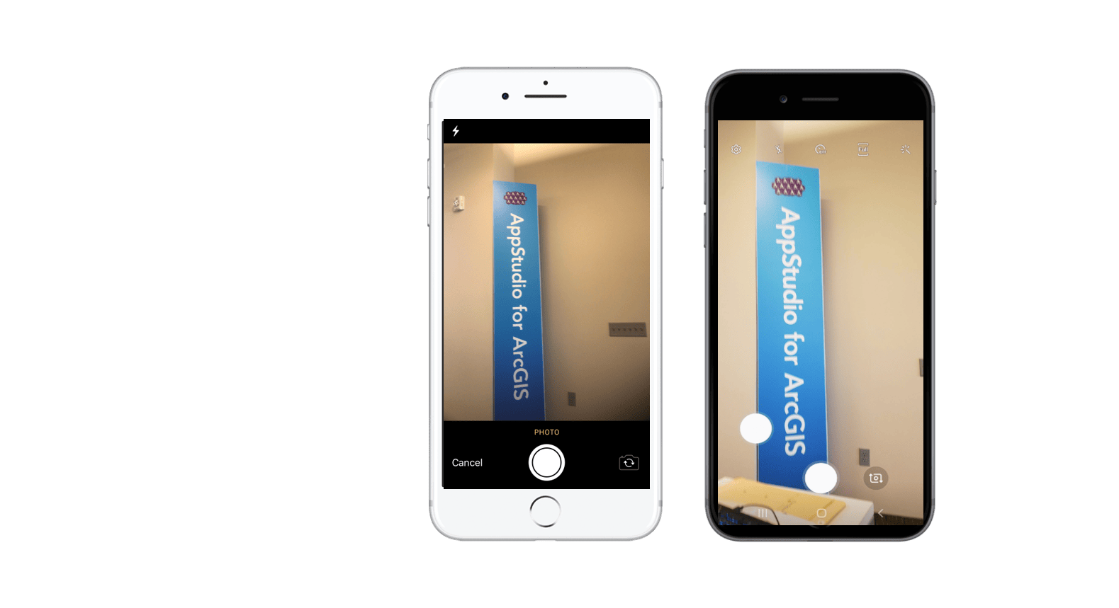

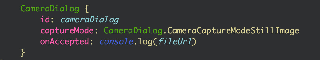

The CameraDialog is a lightweight component that provides direct access to the system camera controls with the best available resolution supported by the device. It comes with two modes i.e., CameraCaptureModeStillImage and CameraCaptureModeVideo, which lets you capture an image or video respectively. After the capture is complete, you can playback & review before saving.
The CameraDialog is a separate component and it works in addition to the QML Camera component. The new Camera Dialog provided in ArcGIS.AppFramework.Multimedia gives you a solution to easily add photo and video capture to your custom app.
![](https://www.esri.com/arcgis-blog/wp-content/uploads/2019/10/Screen-Shot-2019-10-03-at-1.59.04-PM.png)
![Use CameraDialog in iOS and Android Use CameraDialog in iOS and Android](https://www.esri.com/arcgis-blog/wp-content/uploads/2019/10/CameraDialog2.png)

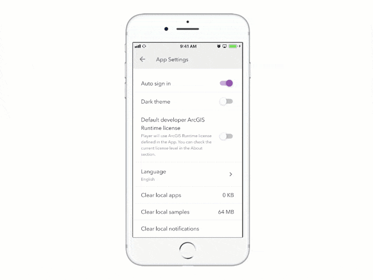

- AppFramework.defaultLocale – read or write the current default locale (this impacts not only text shown, but also date/time pickers, thousands of separators, and decimal separators)
- AppFramework.loadTranslator – change the translations for the currently loaded app. Notice that AppStudio Player version 4.0 is taking advantage of this new method, and has a setting to change the Player language. You can download the source code of the Player and see how our team is using this method.
![AppStudio Player language setting AppStudio Player language setting](https://www.esri.com/arcgis-blog/wp-content/uploads/2019/10/Player-language-settings.gif)
