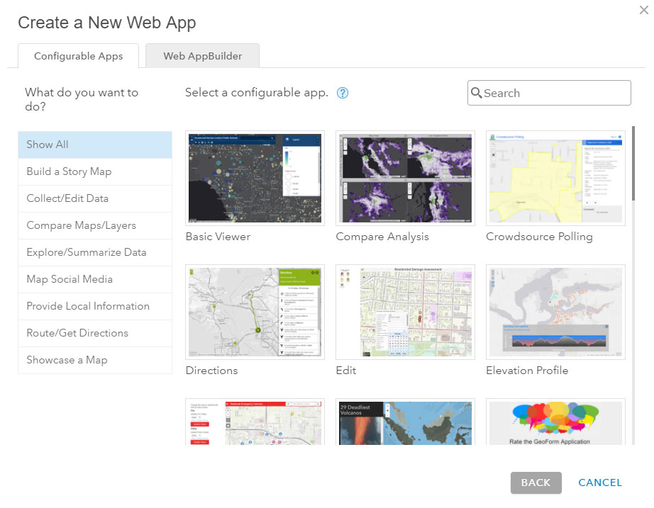

When you save and share a web map, click Create A Web App.
This displays the current gallery of configurable apps. The default collection of configurable apps is authored and hosted by Esri.

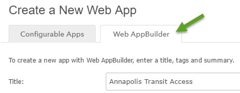

In Create A New Web App, choose Web AppBuilder.
Enter the required inputs, then click Get Started to build your app by selecting a theme, style, and layout. Then add widgets and configure them as desired.

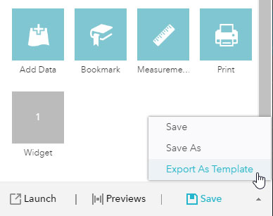

Step 3. Export your app as a template.
When finished building your app, Save the app and click the arrow next to Save and choose Export As Template. The original app used to create the template must not be deleted.

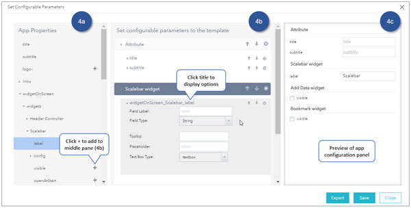

Set Configurable Parameters enables you to choose what elements can be configured, how they can be configured, and provides a preview of the app configuration panel. Set Configurable Parameters has three panes.
4a. Use the left pane (App Properties) to select configurable elements (4a). Click plus (+) to add them to the middle pane to set the configurable parameters.
4b. Use the middle pane to refine the configurable parameters for each element. Click the element to display configuration options.
4c. The right pane provides a preview of the configuration panel for the app.
When finished, click Export to create the web app template. Note that you can reconfigure the template later, and click Update to overwrite your previous settings.

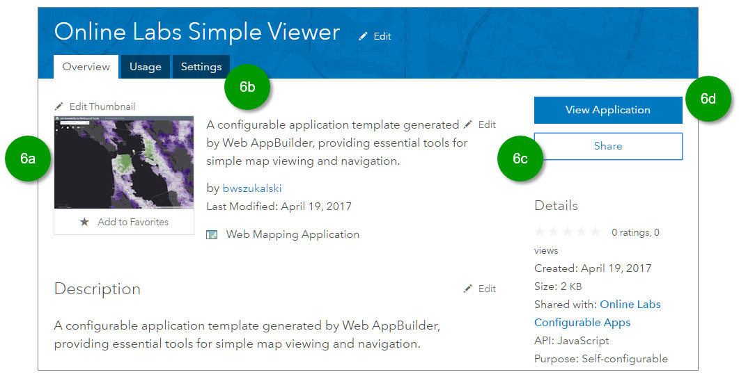

6a. It’s a best practice to complete the item details for your configurable app template, replacing the default thumbnail, and adding a good summary and description.
6b. Under Settings, set Delete Protection so the item is not accidentally deleted. See How to prevent accidental deletion for more information.

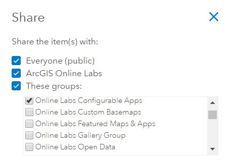

6c. Ensure that the template is shared publicly, so public apps can be made using it.
6d. View Application will open the app using the map that you used while configuring the template. It’s a good practice to ensure that the map’s item details have been completed, and that Delete Protection is enabled for the map.
Note: The app used to create the template must not be deleted. Use Delete Protection to ensure it is not accidentally removed.

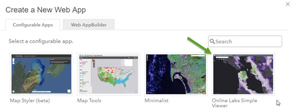

The new configurable app will appear in the gallery.
Click the app thumbnail to choose it, and learn more.

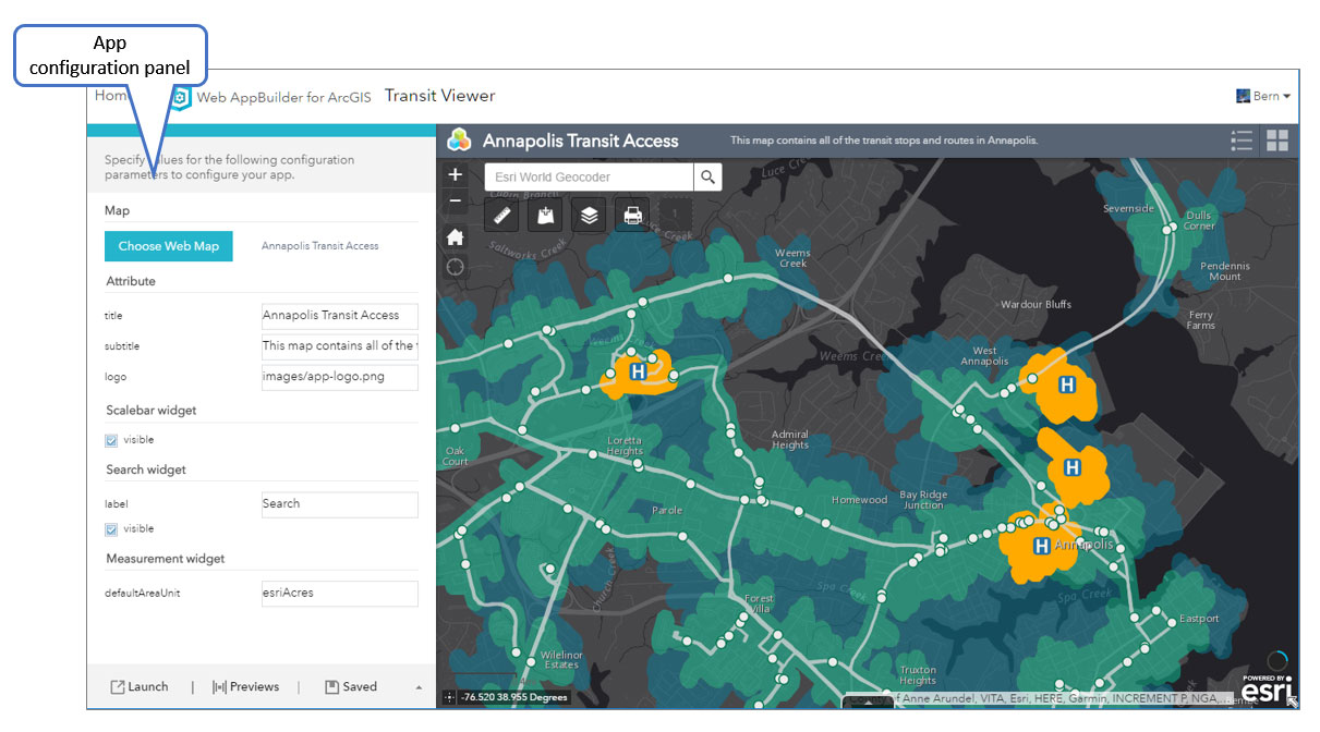

Click Preview, or choose Create Web App to configure the app.Choosing Create Web App opens the app with the configuration panel on the left, showing options as configured in Step 4 above.
When finished configuring the app, click Save, then Share to make it available for others.
