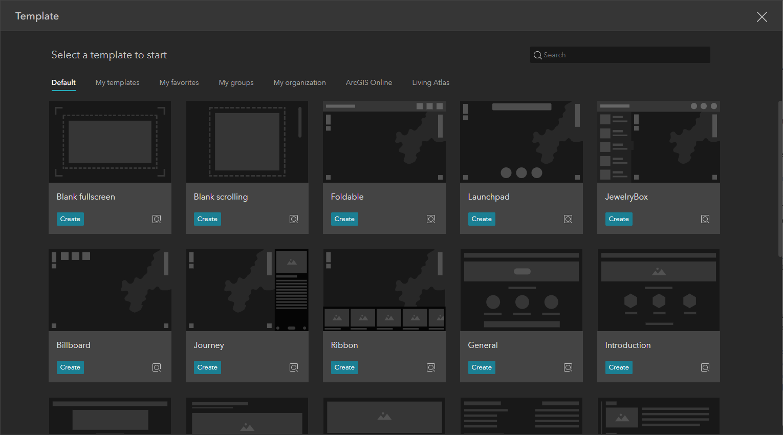

Template gallery
From the Experience Gallery click Create new to open the template gallery.
![Create new experience Create new experience](https://www.esri.com/arcgis-blog/wp-content/uploads/2020/01/exbo-5.jpg)
The template gallery contains the default templates, as well as templates that you’ve created, those shared with you, and public templates, including those found in ArcGIS Online and ArcGIS Living Atlas.
![Template gallery Template gallery](https://www.esri.com/arcgis-blog/wp-content/uploads/2020/02/ex-1.png)
Hover over any template to learn more about it.
![Template hover text Template hover text](https://www.esri.com/arcgis-blog/wp-content/uploads/2020/01/hover1.gif)
Preview the template, or click Create to use the template to create an app.
