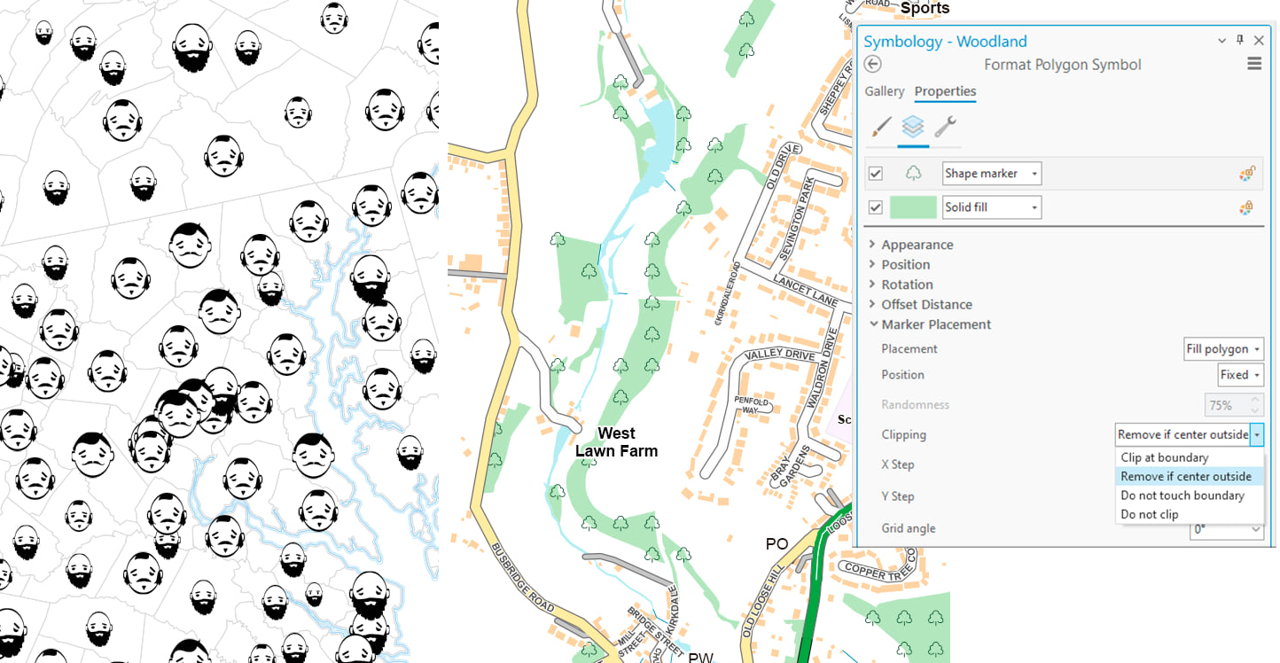

In our polygon symbology’s regular marker properties – before even using the tool – we can specify, under Marker Placement, if we want clipping to occur at the polygon boundaries.
There are certain scenarios in cartography where we may prefer not to use clipping. If we have a natural feature such as an area of woodland, it can sometimes look better to let the trees grow up from their underlying green polygon than to have them cut off at the polygon edges. This is especially true for narrow, unfenced polygons without an outline. Similarly, thematic map symbols can often exceed their polygon bounds, e.g. John Nelson’s “wine versus beer” map.
In such cases, we can either not clip (below left), or remove markers whose centerpoint is outside of the polygon (below right).

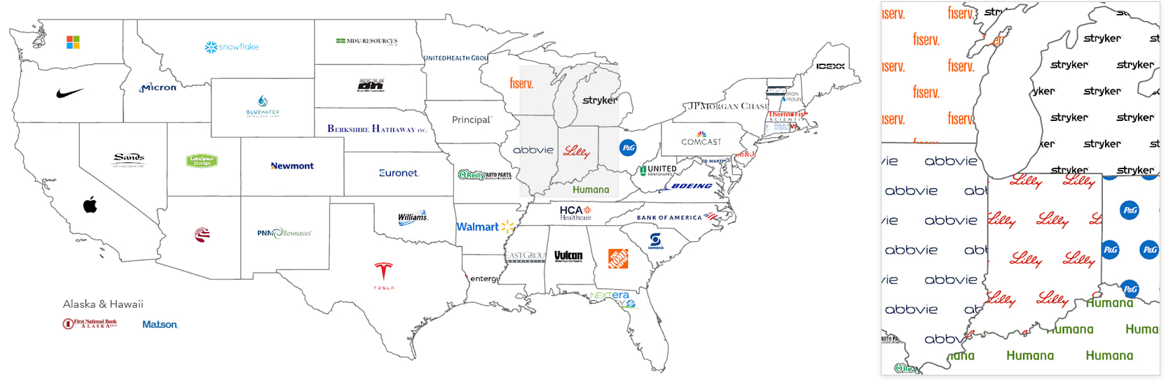

However, if we have a qualitative map of states of the US symbolized by the logo of their largest company; then regardless of whether we have one marker or a pattern of markers, we are likely to want to use boundary clipping.

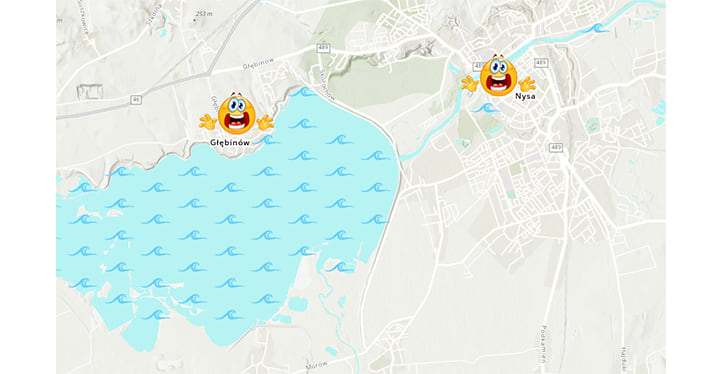

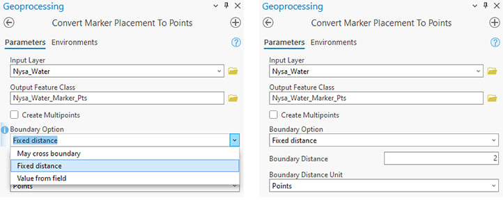

When we run the tool, the boundary option will honor the clipping setting and take only the markers we see. But we get the option to refine the output further by removing symbols within a set distance from the boundary. This may be useful in scenarios such as ensuring a minimum distance between symbols and neighboring features or preventing waves from spilling into towns and cities!
Data from OpenStreetMap, symbols from Adobe stock
Applying a boundary of a fixed distance will default to 0 points, i.e. nothing outside of the polygon will be retained. But we can specify a distance (and units) or alternatively read them from our data.

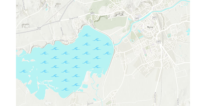

So here, I have set the boundary distance to 2pt to maintain a small aesthetic gap between any wave symbol and the edge of the polygon.
Result of the tool
The tool has worked great! But why not just use “do not touch boundary” in the original symbology I hear you ask!
Well, it would have been a possible better starting point, but it may not have avoided the little islands in the lake. Also, here we have more control over the gap to preserve between the (polygon symbol) boundary and the markers.

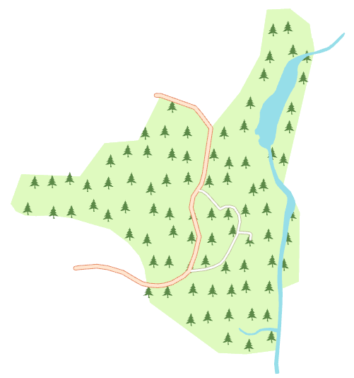

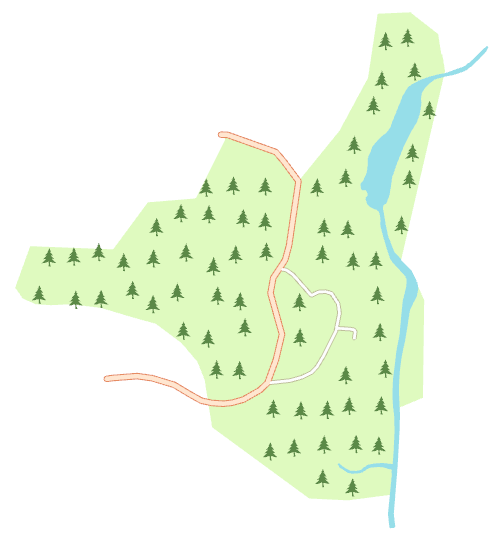

The barriers setting may be useful in scenarios such as ensuring clarity of routes on a trail map or simply making sure that we avoid trees covering or overlapping roads — which makes the road network harder to read on the map and would be an obstruction to traffic!
Applying a fixed distance will default to 0 points. But we can specify a distance (and units) or read them from our data.
So here, I have set roads to 2.5pt and water to 0pt: Meaning there will be a 2.5pt gap retained between the tree markers and the edges of roads, and they cannot be placed on top of roads or water.
Before
After

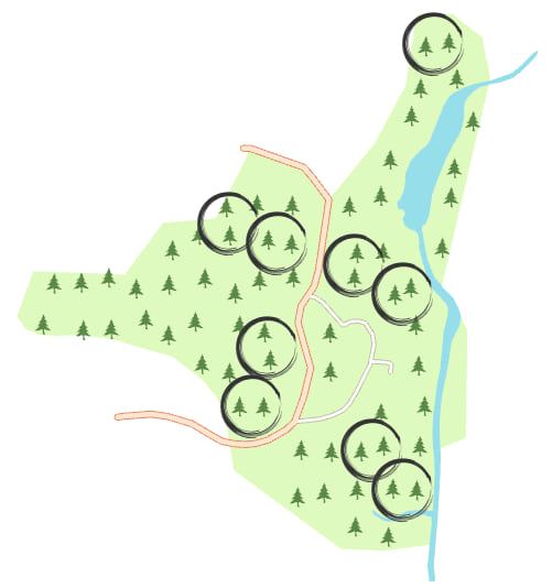

It is important to understand that displacement method has nothing to do with boundaries, barriers, or any other conflicting map elements. This displacement pertains to the actual markers themselves, i.e. to spread apart marker points that are too close to one another when a random marker placement has been used.
Take the same example as last time. I am really happy with the marker placements in their slightly random but clean pattern but to maximize legibility, we can fine tune the result to ensure none of the symbol markers are within 6pt of one another.
So here is the same image as before, but with the symbols I want to tweak highlighted.
And if we run the tool with an added displacement apart to ensure a minimum gap between markers of 6pt.
And once again but this time I have asked the markers to displace towards the regular pattern grid as opposed to directly away from one another.

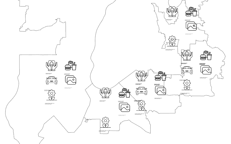

You don’t need to have a marker pattern to use the tool. Even if you have one marker per polygon as we saw with the company logos, or a set of polygon marker layers from a join, these will work in the tool too — which is very handy for any manual repositioning. There is also the option to ensure we keep at least one marker.
In the example below, we have point data of supermarket stores with available “extra” services that has been joined to distict polygons. The icons you see are the output of the tool (the resulting point symbol markers) over the input (polygon symbol markers) which is a perfect match as I didn’t use clipping. In this case the markers would likely benefit from manual repositioning once converted to points.

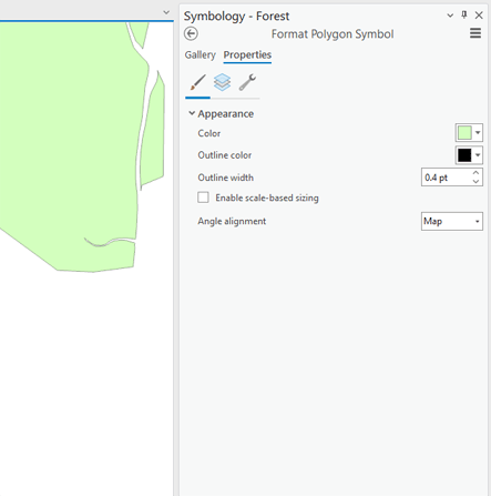

How to style polygons with markers

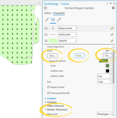

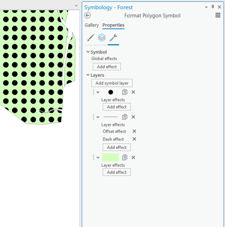

1a. Right-click on a polygon layer in the Contents panel and select Symbology. This will take you to the Primary symbology tab. Then click on its symbol.
or
1b. Alternatively, simply click on its symbol in the Contents panel.
2. Either of the above will take you to the Gallery tab of Format Polygon Symbol. From here, click on the Properties tab and you should have something similar to the image below.
3. Go to the Structure tab and Add symbol layer choosing Marker layer.
4. Go to the Layers tab and change the default shape marker (a filled circle), to the marker symbol you want to use. This can be from a style, a font, or a SVG or EMF file.
5. Using the rest of the Appearance section, you can set the color, size, position, etc. As well as the Marker Placement settings. Explore each of the settings here.
