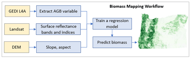

Refer to the workflow chart below:
![flow_chart flow_chart](https://www.esri.com/arcgis-blog/wp-content/uploads/2024/01/fig1-flowchart.png)
GEDI Level 4A data will be used as training target. Landsat imagery and DEM will serve as independent variables in the regression model. The optical sensor’ spectral characteristics respond to vegetation, directly related to biomass, while DEM reflects topological variability and terrain complexity, influencing forest growth. Consequently, these datasets and their derived variables aid in better estimating aboveground biomass.

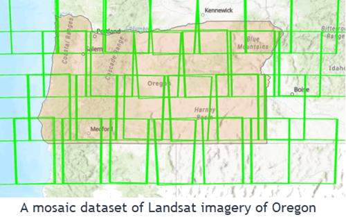

- Search for images within the extent of the Oregon state boundary, within a time range from 5/15/2022 to 10/15/2022, with a cloud cover criterion of less than 30%.
- Create a mosaic dataset from the search result. Below is the created mosaic dataset containing 229 scenes.

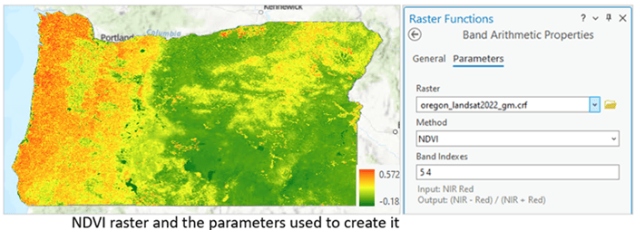

Leverage built-in options for NDVI, EVI, MNDWI, and SAVI: Below is the NDVI raster (left) and the parameters used to create it (right).

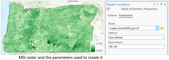

Use the user-defined option for MSI, RVI, and DIV: MSI (SWIR1/NIR) represents moisture stress index, RVI = NIR/R representing ration vegetation index, and DIV = NIR-R, representing difference vegetation index. An example of calculated MSI raster and the parameter used is illustrated below:
![MSI MSI](https://www.esri.com/arcgis-blog/wp-content/uploads/2024/01/fig5_msi.png)

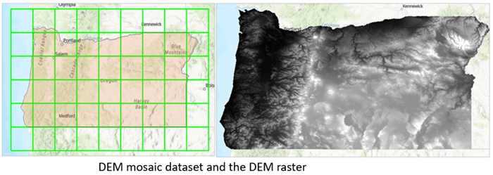

Following a similar workflow as the Landsat processing, all DEM data within same extent were selected, a DEM mosaic dataset was created from the search result, and a DEM of Oregon was clipped using the Clip Raster tool.

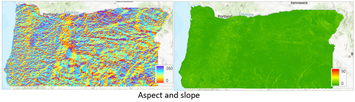

Additionally, a slope raster and an aspect raster were created using corresponding raster functions
![slope slope](https://www.esri.com/arcgis-blog/wp-content/uploads/2024/01/fig7_slope.png)
The DEM, slope, and aspect will provide additional independent variables for training regression model.

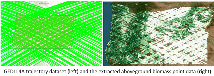

The GEDI data can also be accessed from Amazon Cloud. We can utilize the Earth Data portal to search data of our interest and save S3 paths of the search results. I created a trajectory dataset from the search result. This trajectory dataset is a file geodatabase dataset directly referencing the GEDI files in AWS. I then extracted the point data containing the aboveground biomass (AGBH field) within the study boundary. For the detailed steps on how to ingest GEDI data into ArcGIS, refer to this blog. below are the visuals of the created trajectory dataset and the exported point feature class with AGBH variable.
![GEDI dataset GEDI dataset](https://www.esri.com/arcgis-blog/wp-content/uploads/2024/01/fig88_GEDI.png)
This point feature class will be used as the target in training regression model.

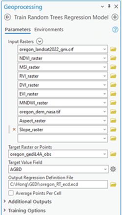

With all the input data prepared from the previous sections, we are now ready to train the model. Using the Train Random Tree Regression tool in the Image Analyst toolbox, I created a training model stored in .ecd file. This was achieved by using the extracted aboveground biomass point data as the training target, with the 7 band Landsat composite, derived indices, DEM, and calculated aspect and slope serving as independent variables.

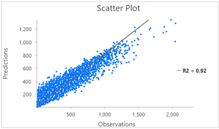

The scatter plot, with an R square of 0.92 when comparing observations and predictions, shows evidence of the model’s robust performance.

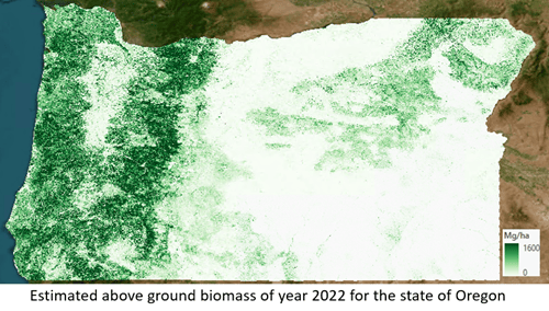

Moving to the next step, I used the Predict Using Regression Model tool, setting the input raster with the same set of rasters and in the same input sequence used during model training, along with the trained .ecd file. This process generated an above-ground biomass raster, an estimation for the entire state of Oregon, as shown below:
![aboveground biomass result aboveground biomass result](https://www.esri.com/arcgis-blog/wp-content/uploads/2024/01/fig111_result-1.png)
