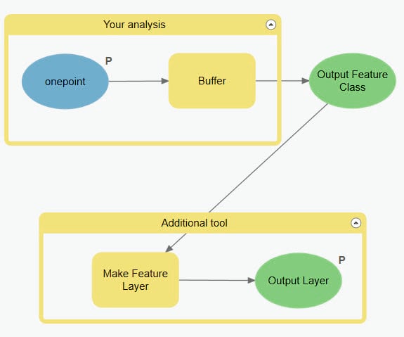

There are two best ways to apply symbology for your result feature layer if you are using a model tool made by ModelBuilder. One is to set the output parameter property. Another is to use the Apply Symbology From Layer tool to apply the symbology as the last tool in your model.
Use the output parameter property

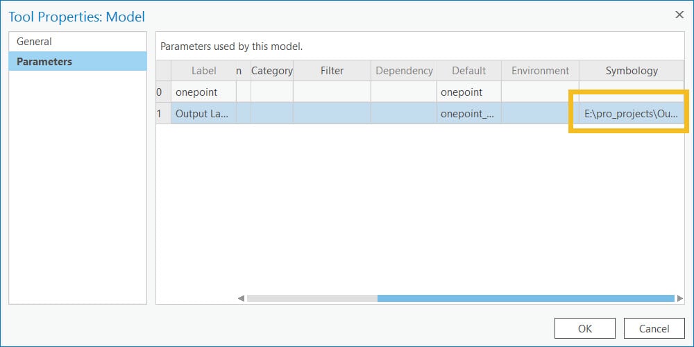

To set the output parameter property, go to the properties of your model tool in the Catalog pane. Once on the Tool Properties dialog box, select parameters to the left. You will see a table of your model parameters. The output parameter data type has to be a feature layer. Select an output feature parameter, and in the last column, Symbology, choose a layer file containing the symbology you want. To create a layer file, see Save a layer file.
Once you have set up the output parameter symbology property, you also need to add the Make Feature Layer tool for your output. This can ensure the symbology is applied to the result feature layer correctly.

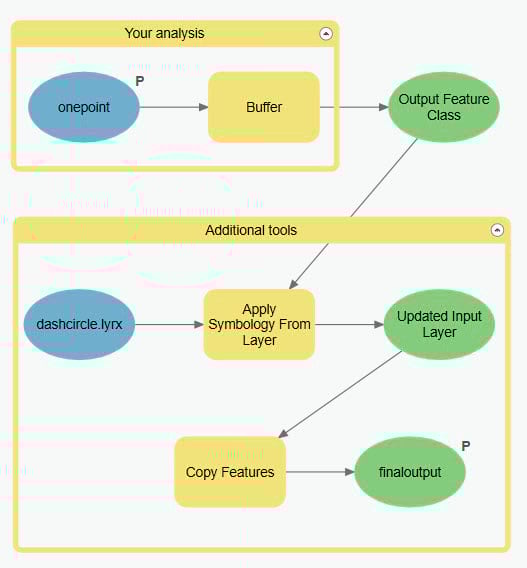

Use the Apply Symbology From Layer tool
Alternatively, you can add the Apply Symbology From Layer tool at the end of your model tool, if the parameter type of your output is a feature class.
If you plan to use the web tool in ArcGIS Pro, you also need to add a Copy Features tool in the end.
