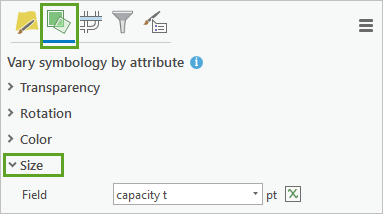

3. At the top of the pane, click the Vary symbology by attribute button and expand the Size section.
This layer is also symbolized by size, based on how much grain each elevator can hold.
![Size section under Vary symbology by attribute Size section under Vary symbology by attribute](https://www.esri.com/arcgis-blog/wp-content/uploads/2022/03/2-1.png)

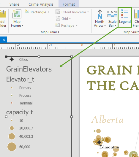

4. Open the layout. On the Insert tab of the ribbon, click Legend. Draw a box next to the map to add a legend.
![Legend button on the ribbon and new legend next to the map Legend button on the ribbon and new legend next to the map](https://www.esri.com/arcgis-blog/wp-content/uploads/2022/03/3-1.png)
I prefer to add legends next to the map because I know I’ll need to click them a lot to edit them. I don’t want to accidentally click things on the map instead.

1. In the Contents pane, expand Legend, right-click Cities, and choose Remove.
You also don’t need a title that says “GrainElevators.” That information is already conveyed by the map’s title.
2. In the Contents pane, double-click GrainElevators to open the Format Legend Item pane.
In general, double-clicking something in the Contents pane will open its properties.
3. Under Show, uncheck Layer name.

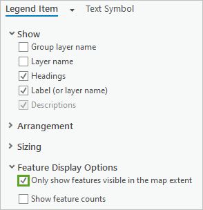

Now I’m ready to make the legend equivalent of my conversation. First, I want to address Ellen’s concern about the missing terminal elevators.
1. On the Format Legend Item pane, under Feature Display Options, check Only show features visible in the map extent.
![Only show features visible in the map extent checked Only show features visible in the map extent checked](https://www.esri.com/arcgis-blog/wp-content/uploads/2022/03/4-1.png)
The red symbol disappears from the legend. Ellen was right, the only terminal elevator in the dataset is in Churchill, Manitoba, which is not visible on the map.

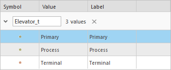

Next I want to change the Elevator_t heading. I would never say “Elevator_t” when explaining the map to a friend. I would say “elevator type.” But looking back on my conversation, I didn’t even say that. That means that my legend doesn’t need to either.
2. On the Format Legend Item pane, under Show, uncheck Headings.

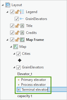

3. In the Contents pane, expand Map Frame. Under the GrainElevators layer, click Primary and press F2 on your keyboard to make the text editable. Change the label to Primary elevator. Add the word elevator to the other two types as well.
![Renamed items in Contents pane Renamed items in Contents pane](https://www.esri.com/arcgis-blog/wp-content/uploads/2022/03/5-1.png)
I displaced the “Elevator type” title into the legend labels. This works well when you only have a few items in the legend.

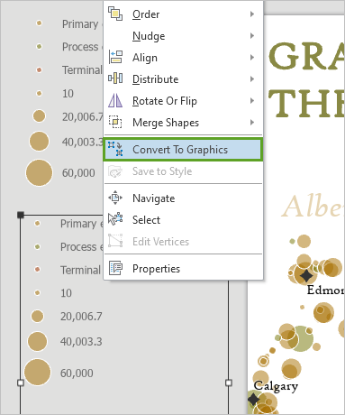

1. Right-click the legend to Copy and Paste it. Right-click the new legend and choose Convert to graphics.
![Convert legend to graphics Convert legend to graphics](https://www.esri.com/arcgis-blog/wp-content/uploads/2022/03/7-1.png)
2. Right-click the graphic and choose Ungroup. Delete all of the graphics except for the size circles.

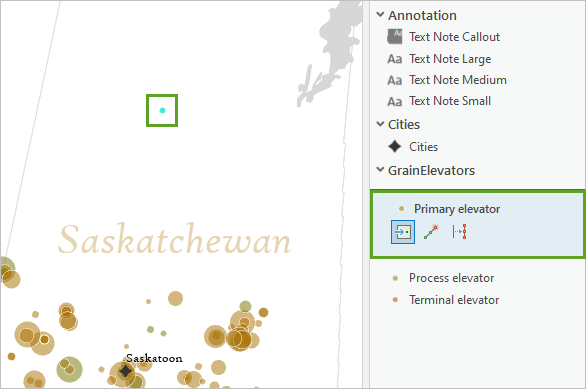

I’ll make a new feature with the size I want to serve as a model for my legend graphics.
1. Return to the map. On the ribbon, click the Edit tab and click the Create button.
2. In the Create Features pane, click any of the elevator symbols. Click once somewhere in northern Saskatchewan to add a new feature to the map.
![New primary elevator feature on map New primary elevator feature on map](https://www.esri.com/arcgis-blog/wp-content/uploads/2021/03/create.png)
3. On the ribbon, click the Attributes button. In the Attributes pane, change capacity to 30,000 and click Apply. Clear the selection and return to the layout.
4. Drag one of the medium-sized circles from the legend onto the map. Line it up with the new feature and resize it until it matches.
![Resizing a graphic to match a symbol's size Resizing a graphic to match a symbol's size](https://www.esri.com/arcgis-blog/wp-content/uploads/2022/03/ezgif-7-c6d70f3645eb.gif)

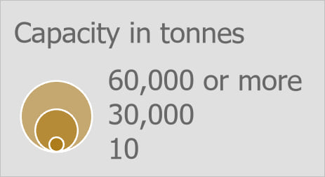

6. On the ribbon, on the Insert tab, in the Graphics and Text group, click Rectangle text.
7. Draw a box next to the size legend and type the legend labels on three lines (60,000 or more / 30,000 / 10). Add another rectangle text box above that says Capacity in tonnes.
Don’t worry if the text is too big. You’ll fix it later.
![Stacked proportional legend with labels Stacked proportional legend with labels](https://www.esri.com/arcgis-blog/wp-content/uploads/2022/03/10-1.png)

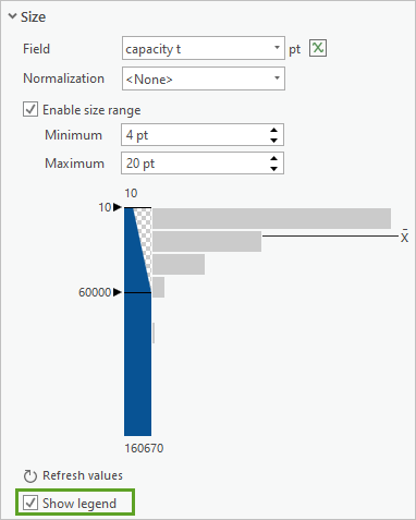

9. In the Contents pane, double-click one of the size symbols to open the Symbology pane to the size properties. Uncheck Show legend.
![Show legend checked Show legend checked](https://www.esri.com/arcgis-blog/wp-content/uploads/2022/03/11-1.png)

The content of both legends now matches how I would explain the map to a friend. To finish, I want to make sure that the style of the legend matches that of the map. Mostly, this means changing the font.
1. Select and double-click the Capacity in tonnes text. The Format Text pane appears. Click Text Symbol and change the font to High Tower Text with a size of 10 pt.
2. For Color, use the Eyedropper tool to sample from the green color of the map’s title.
![Eyedropper tool in color picker menu Eyedropper tool in color picker menu](https://www.esri.com/arcgis-blog/wp-content/uploads/2022/03/12.png)

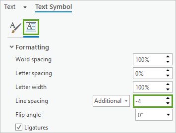

3. Change the legend labels text to use the same properties. Additionally, click the Formatting tab and change Line spacing to -4.
![Text line spacing Text line spacing](https://www.esri.com/arcgis-blog/wp-content/uploads/2022/03/13-1.png)
Now your legend labels are more in line with the circles they are labeling.

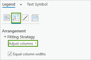

5. Select the legend for elevator types. Double-click the legend to open its properties and click Text Symbol. Change the font to match the other legend.
6. At the top of the pane, click the back arrow and click the Legend Arrangement Options tab. For Fitting Strategy, choose Adjust columns.
![Legend fitting strategy Legend fitting strategy](https://www.esri.com/arcgis-blog/wp-content/uploads/2022/03/15-1.png)
This will prevent the text size from changing when you resize the legend.

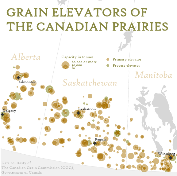

Finish
1. Drag both legends onto the map and place them wherever you find pleasing.

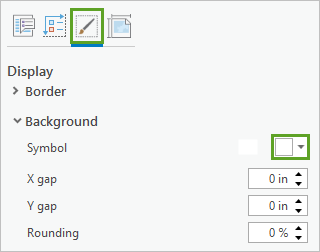

2. If a province border interferes with one of them, double-click the legend to open the Format Legend pane. Click the Display tab and change the Background color to white.
![Background symbol set to white Background symbol set to white](https://www.esri.com/arcgis-blog/wp-content/uploads/2022/03/17-1.png)
The legend is complete!
![Map with completed custom legend Map with completed custom legend](https://www.esri.com/arcgis-blog/wp-content/uploads/2022/03/18-1.png)
