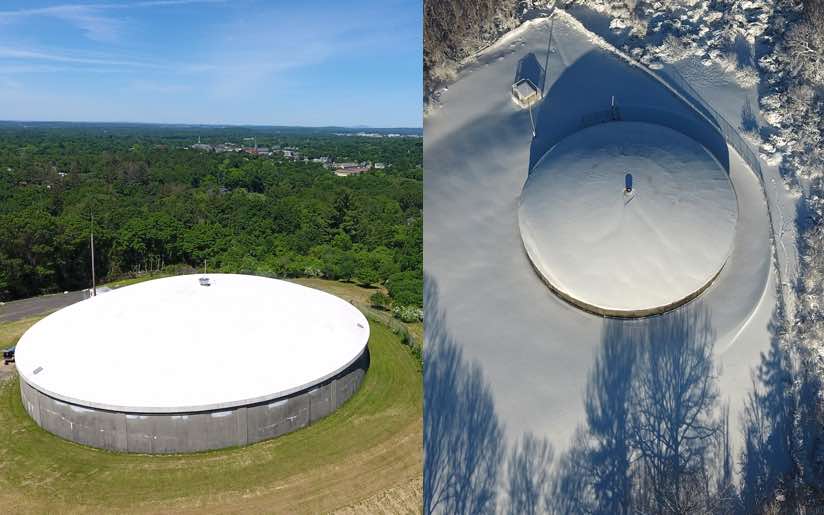

The impetus for purchasing the drone was to improve the efficiency and safety of workers inspecting Natick’s two water tanks. Massachusetts Department of Environmental Protection (MassDEP) requires monthly inspections of all tanks in the state, a process that required workers in Natick to ascend a ladder to make sure that access points at the top of the tank were secure. The use of the drone allowed Natick to eliminate workers’ exposure to this hazardous task.
“Every month that our staff doesn’t have to scale a twenty-foot ladder to look at a hatch is a win,” said Anthony Comeau, supervisor of Natick’s Water Division.
In the past, Natick sent a pair of inspectors who would take a full morning to climb and record each inspection. With the drone, the tank inspection requires just one drone pilot, and the process now takes less than an hour. In addition to the time savings, the high-resolution imagery meets the consistency standards required by MassDEP, improves the level of detail that the inspections capture, and keeps employees safe.
Water Tank Inspection
The safety of the mandated monthly water tank inspection is much different on a clear summer day (left) compared to a snowy winter day (right). In addition, using a drone improves efficiency as the inspector captured the necessary details on the snowy day without having to plow the access road.

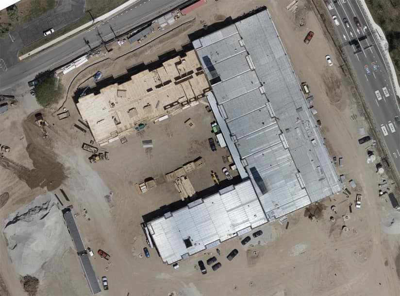

When a new housing subdivision was built in Natick, a quick flyover of the construction site captured imagery of the town’s new addition. Previously this update of official records would have been delayed for years until the town’s next aerial imaging survey. Instead, digital maps and records were instantly updated.
The rapid update of the town map benefits all departments. Emergency services are certain to find the new homes, town records on the new properties will align with the map, and the map record will reconcile any changes between what was designed and what was built.

construction
Construction captured by the drone quickly updates the town map.
