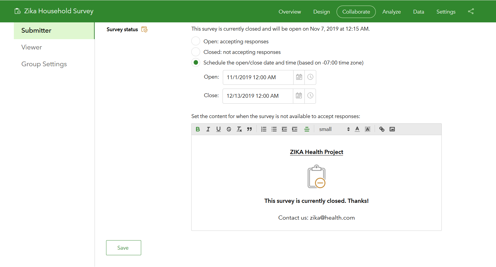

Web surveys: Survey open, survey closed!
Up until this update, if you wanted to disable access to a public survey,  you would simply unshare it. In this way, people could not longer submit data to your survey, but you could still view and analyze its results. The challenge with unsharing a survey is that when attempting to open your survey users would get a generic dialog asking for a user and password, and that is the last thing someone would expect.
You can now configure a “Survey closed” dialog and define when to show it. In the ‘Survey closed” dialog you can add your own text, images and links describing to survey takers why survey responses are not being accepted. Through the Collaborate tab, you can also define the exact time when the survey will be closed or open.  For example, you can design and publish a survey today, schedule it to start accepting responses in November 1, 2019 and stop accepting responses in December 13, 2019.
This feature is currently only supported for web surveys. The Survey123 mobile app will not honor the “Survey closed” custom dialog until a later release.

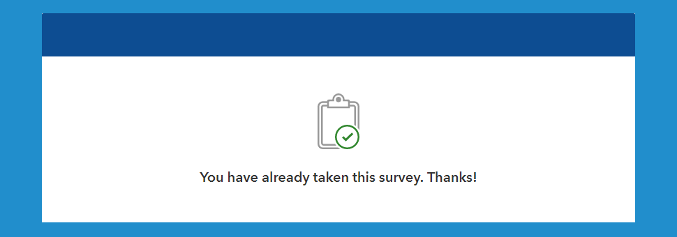

Web surveys: Avoid multiple submissions
This new feature is also built with web surveys in mind. The idea here is to prevent users from submitting a survey multiple times from a web browser.  By default, users can submit data to your web survey as many times as they like, but you can now configure your survey to limit submissions to one. This is done through the Collaborate tab as well.
For clarity, the way this works is not bullet proof for public surveys.  If working with a public web survey, this setting will persist a cookie in the user’s web browser. If the cookie is present, the user will not be able to submit again. A smart user can delete the cookie by clearing the browser’s cache or run an incognito session in the browser.  Also, for public surveys, we can’t really do anything if one person submits from different devices (a phone, a desktop computer in the office, a laptop at home).
Already taken survey
If you really want to confidently block multiple submissions from the same user, the best option is to secure your survey to force users to identify themselves.  At that point, we can more consistently block multiple submissions.

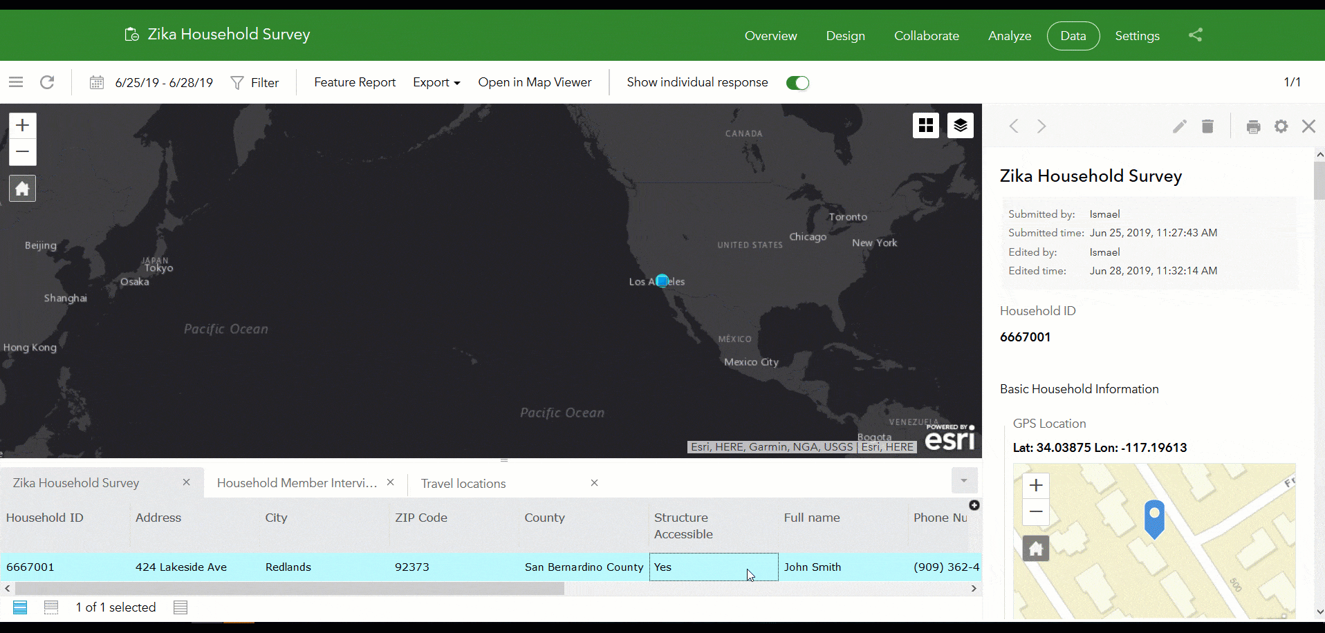

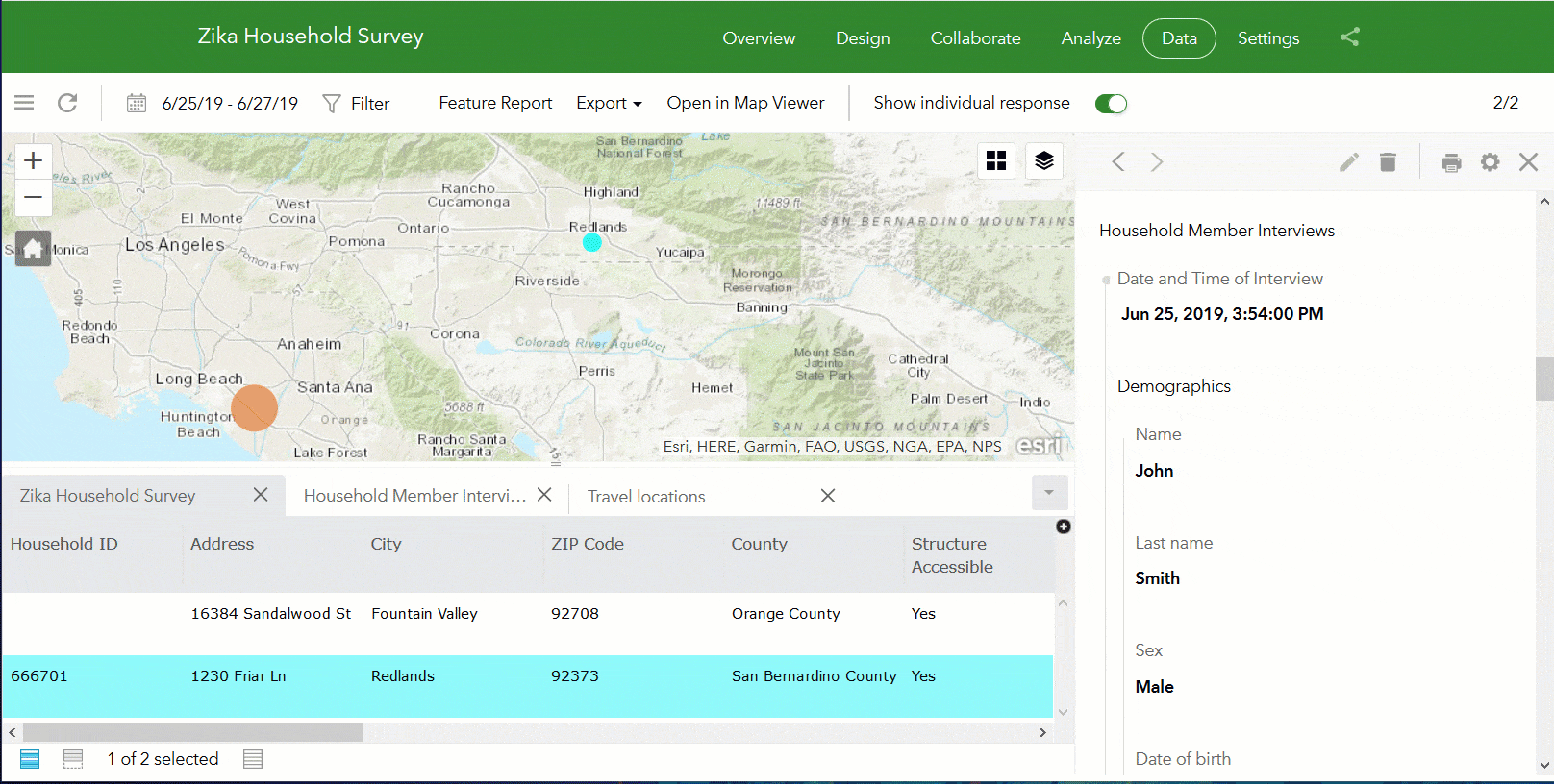

Working with related records (repeats) in the Survey123 website Data view
Through the Data view in the Survey123 website you can interactively inspect all submitted records as a map, table and a form.  In this release, the table view and map views have been enhanced so you can navigate to related records in the table view and display or hide related records in the map. You can also apply filters to the table view.
Related tables
In the example above, we have a Zika Household survey example. At each household, we have one or more household members and for each of them we document all trips they did in the past 4 weeks. The member households and travel locations are modeled in the smart form as a nested repeat, and in the feature service relational model as two nested related tables. Look carefully at the table view and you will see that each of these layers/tables is shown in an independent tab. You can switch between the tabs, look at the data, apply filters and select records. This gives you much more flexibility to explore your survey data.

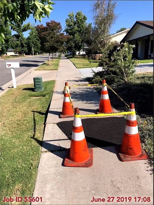

Photo Watermarking (Connect & Field App)
Over time we have received a number of requests to add watermarking capabilities into the Survey123 field app. This is important in some field data collection workflows; for example when performing certain damage assessments, documenting work performed or inspecting assets.
The basic idea is to burn some critical information into the photo while it is taken from the device. Information such as the current date and time, the compass direction or the latitude and longitude. We have extended the XLSForm syntax so you can do all of this and much more.
In the example below we have a watermarked photo taken from a street service report survey. Note how the photo includes in the bottom-left corner the unique identifier of the job as set in the survey and in the bottom-right corner the date and time when the photo was taken.
You can control almost anything you want in these watermarks: the position, color, font, halo effects and of course the content, which can be dynamically calculated or retrieved from the form itself. You can even use a logo in your watermark expressions!
The Watermarks help topic describes in more detail the exact syntax you will want to use for your custom watermarks. We also added a new XLSForm sample in Survey123 Connect that you can use to learn the most basic techniques.

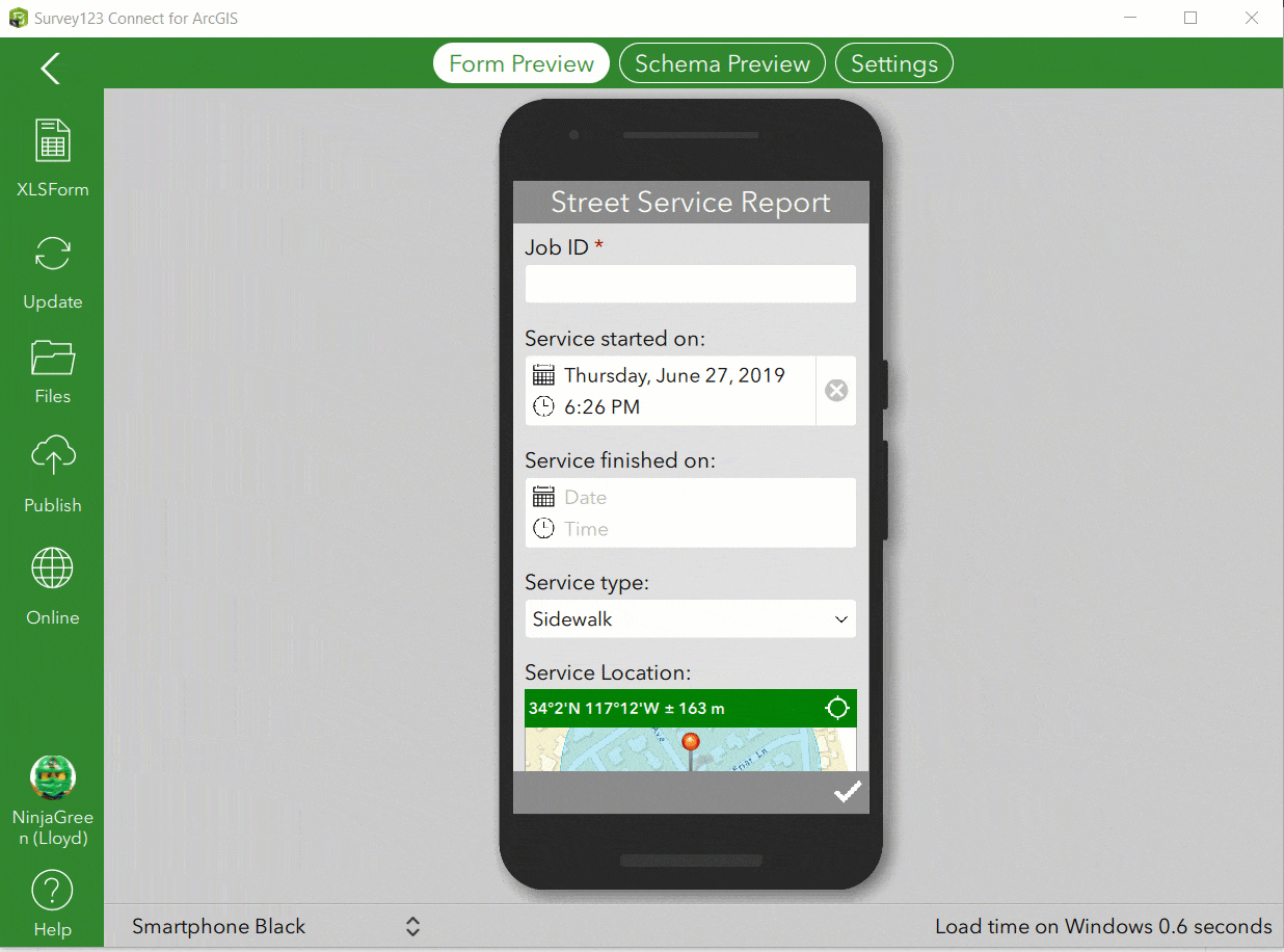

  • In Survey123 Connect, you can now preview your surveys in different form factors.
Connect Preview
