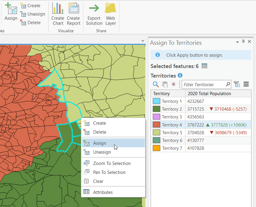

Assign pane enhancements
As the video shows, a key enhancement to the Assign pane is the ability to select territory elements to view the statistical impact before reassigning them. This allows for interactive “what-if” scenarios when working with the map.
The video also shows the new Copy Territory Solution tool. With this tool you can make a backup of your solution and then examine different scenarios, without overriding your original solution.
Here are some of the other new Assign pane features to try:
- Show Updated Values – This shows the total new value if a territory is reassigned.
- Show Differences – This shows the total change taking place when a territory is reassigned.
- Show Forecasted Values – This shows both the total value and change for all territories.
- View the attribute table to analyze selected territory elements.
- Search for any territory name.
- Filter the map to only show selected territories.
- Zoom to, pan to or flash any selected territory.
Below is a look at the Assign pane in the ArcGIS Pro 2.8 release. A territory element is selected on the map, and the positive/negative statistical impact is shown before one or more territories are transferred.
