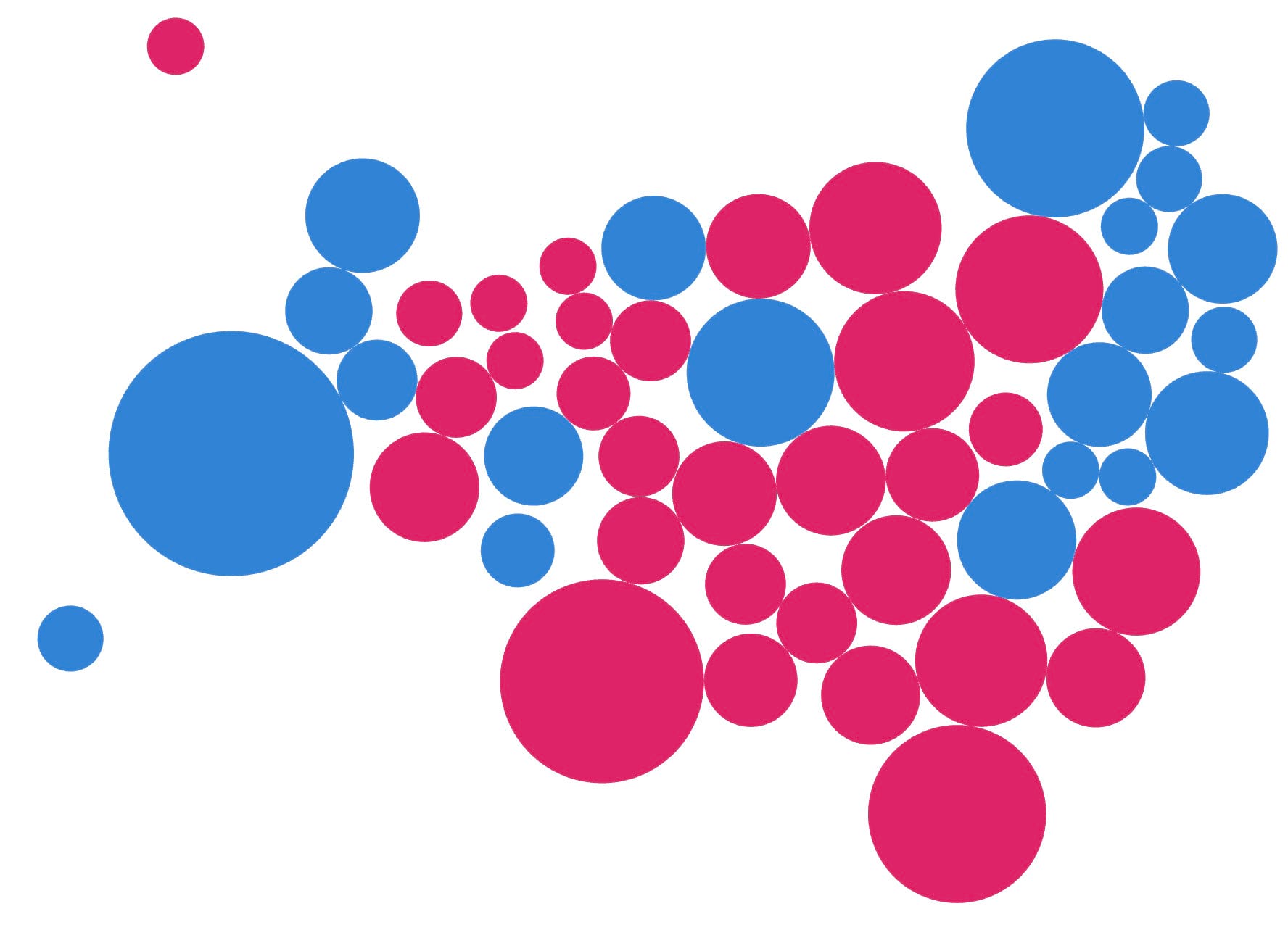

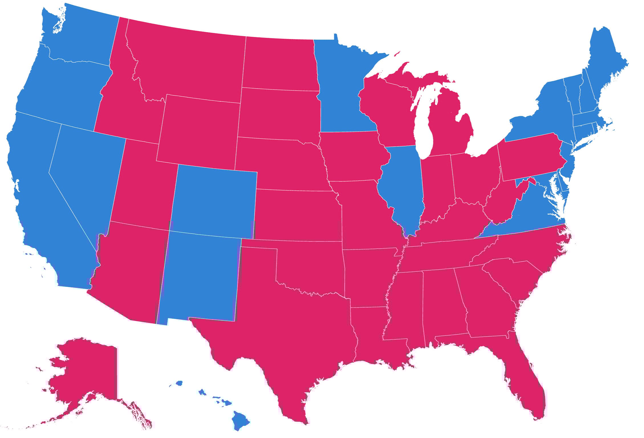

Graphical cartograms effectively create proportional symbols for the data values and then reorganize them in some way to avoid overlaps. The Dorling cartogram is perhaps the most well-known, which uses proportional circles, organized to provide the best adjacency as possible. Here’s a geographical map of the winner of each state for the 2016 Presidential election, followed by a Dorling cartogram showing the same election results but where the size of the symbols are scaled by electoral college votes.
![geographical map of US election results geographical map of US election results](https://www.esri.com/arcgis-blog/wp-content/uploads/2023/06/cartogram1.jpg)
![Dorling cartogram of US election results Dorling cartogram of US election results](https://www.esri.com/arcgis-blog/wp-content/uploads/2023/06/cartogram2.jpg)

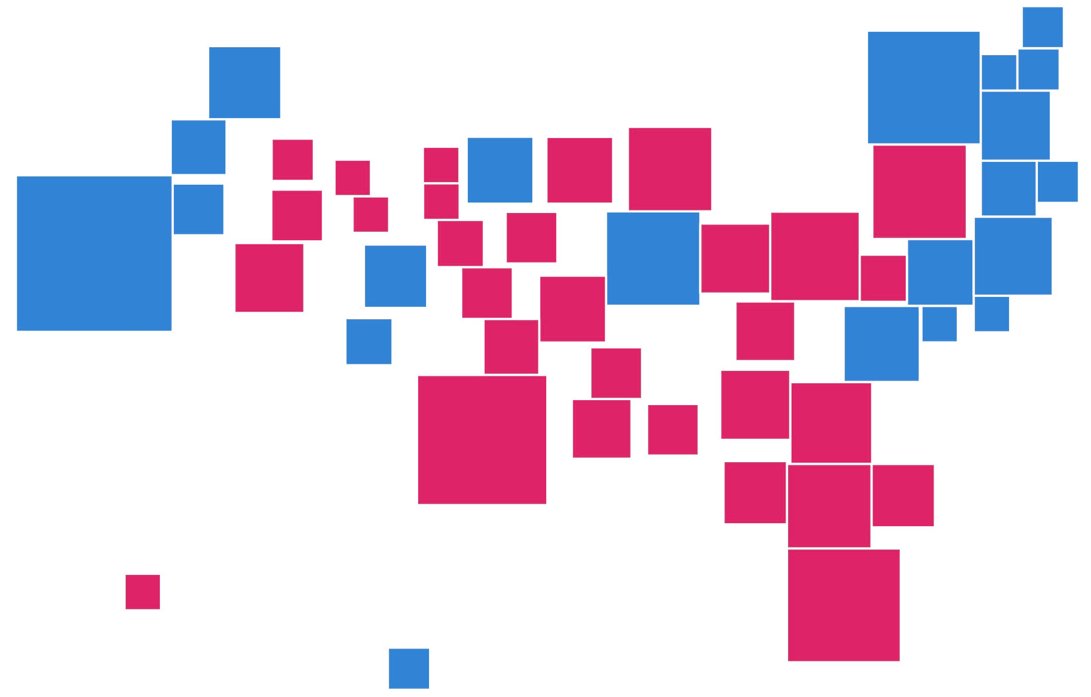

An alternative is the Demers cartogram which uses squares instead of circles and tries to reduce the gaps between shapes. However, whereas the Dorling cartogram attempts to limit the distance of the eventual position of each object from its original position, the Demers sacrifices distance to maintain contiguity as far as possible.
![Demers cartogram of US election results Demers cartogram of US election results](https://www.esri.com/arcgis-blog/wp-content/uploads/2023/06/cartogram7.jpg)

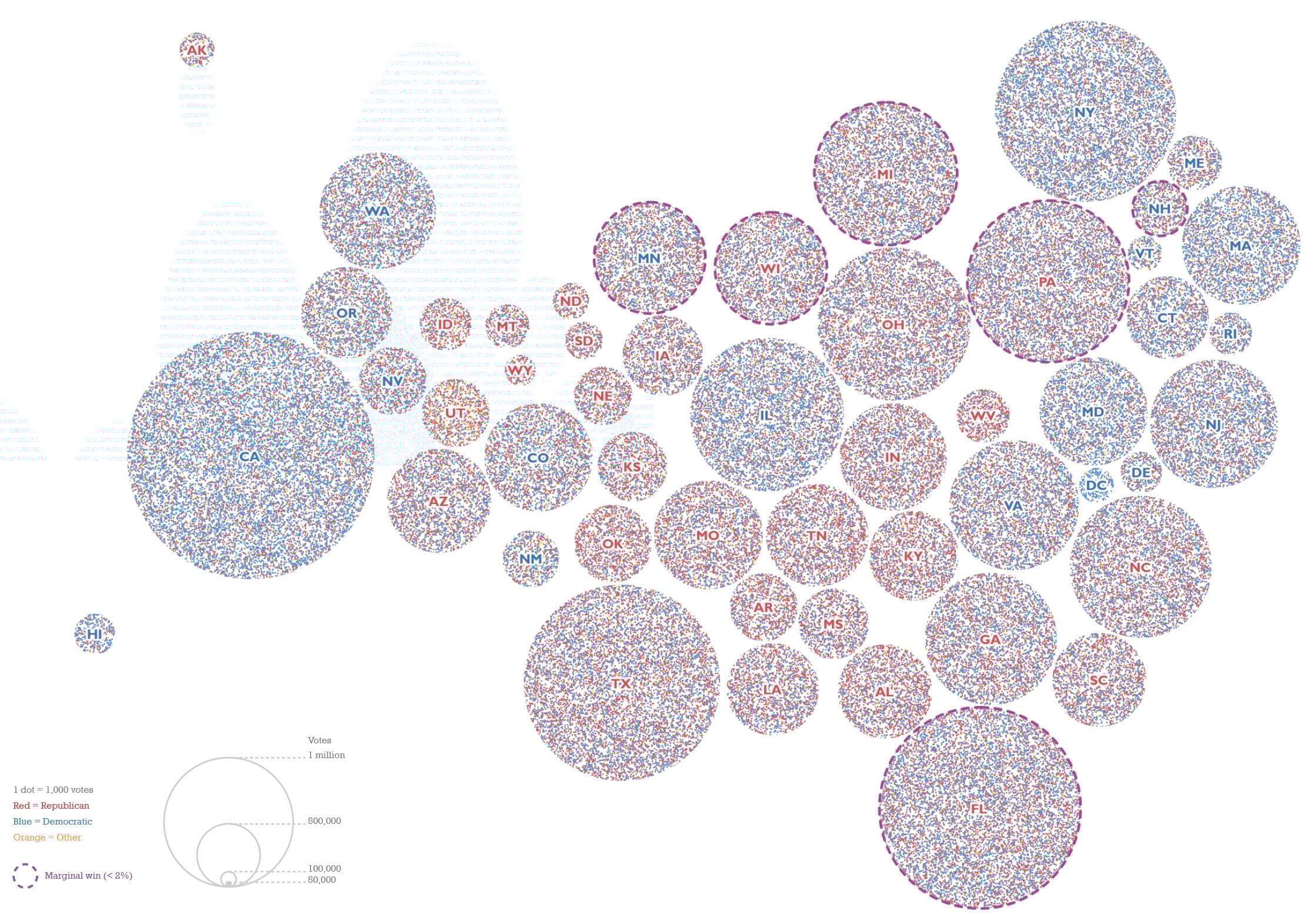

This version of the state map, sized by total votes has used the dot density renderer to symbolize each area with dots representing Republican and Democrat votes which creates a purple mix that tends slightly towards blue for Democratic states, and towards red for Republican states.
![dot density Dorling cartogram of US election results dot density Dorling cartogram of US election results](https://www.esri.com/arcgis-blog/wp-content/uploads/2023/06/cartogram3.jpg)

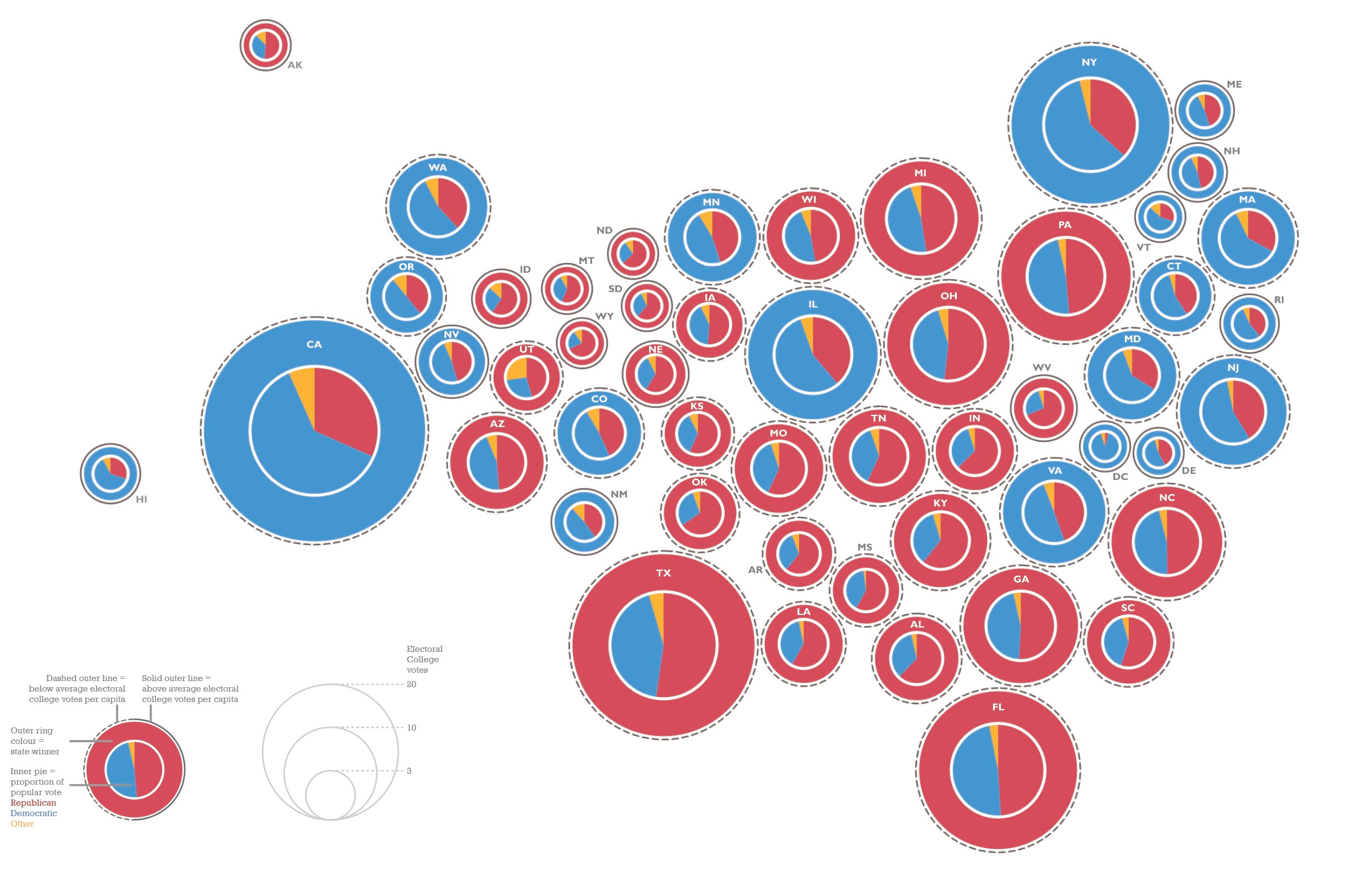

Here’s the same basic structure of the Dorling cartogram but symbolized using chart symbology to create embedded pie charts. They’re sized by the same total votes field so they sit flush on the Dorling cartogram scaffold.
![chart symbology on Dorling cartogram for US election results chart symbology on Dorling cartogram for US election results](https://www.esri.com/arcgis-blog/wp-content/uploads/2023/06/cartogram4.jpg)

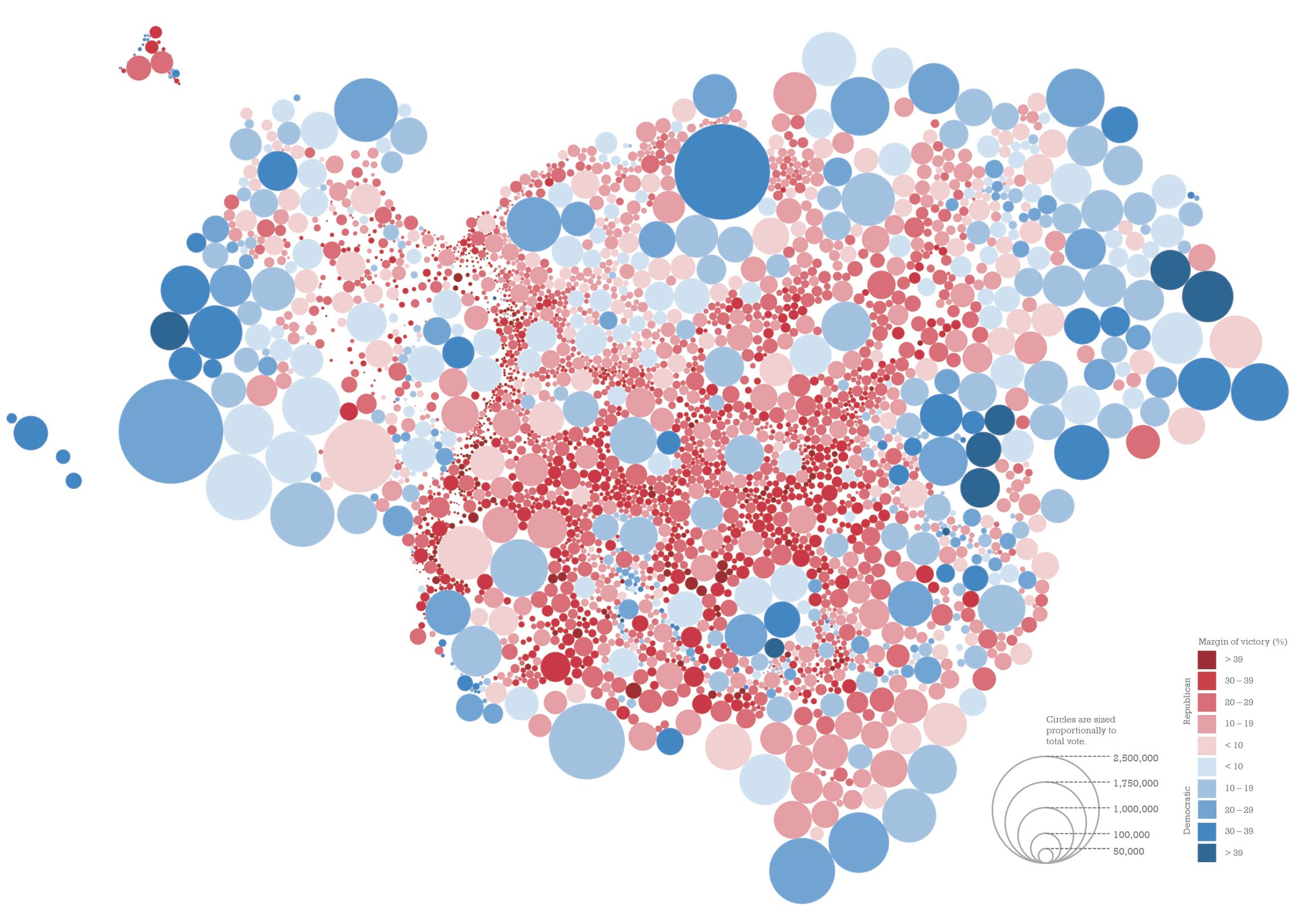

If we map counties rather than states we can get more detailed, and in this sense the cartogram reveals how many more counties were Republican, but with a smaller amount of total votes, whereas there were fewer Democratic leaning counties, but which had more votes. This version effectively illustrates the distribution of the US population by size but it demonstrates how a cartogram overcomes the problem of geographical distortion.
![Dorling cartogram of US county election results Dorling cartogram of US county election results](https://www.esri.com/arcgis-blog/wp-content/uploads/2023/06/cartogram5.jpg)

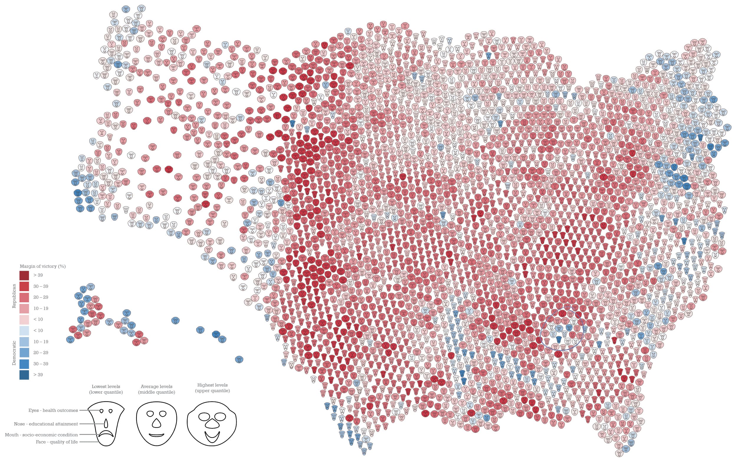

And if we use the same value to scale each county then we get a cartogram with the same sized symbols, which can then be used as a structure to be a bit more inventive with the symbology, here using multiple symbology layers driven by attribute connections to build multivariate Chernoff Faces symbology.
![Dorling cartogram with Chernoff Faces Dorling cartogram with Chernoff Faces](https://www.esri.com/arcgis-blog/wp-content/uploads/2023/06/cartogram6.jpg)
This last example takes what might be seen as a simplification of geography by turning real-world geography into geometric shapes, but then applying more complex symbology to encode more detail.
