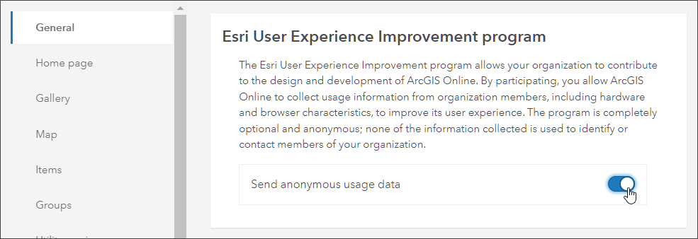

Step 2 — Enable Send anonymous usage data.
Scroll down to the Esri User Experience Improvement program section and toggle Send anonymous usage data.
![Enable anonymous data Enable anonymous data](https://www.esri.com/arcgis-blog/wp-content/uploads/2022/06/analytics-2s.png)
