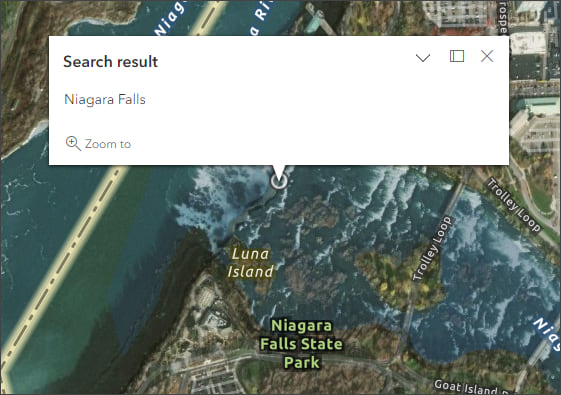

Find the location of a feature to open the map
Use &find= followed by any search string.
https://www.arcgis.com/apps/mapviewer/index.html?webmap=8152694dd9594393a1db4d62d2020fe3&find=Niagara Falls
Find location via URL parameters

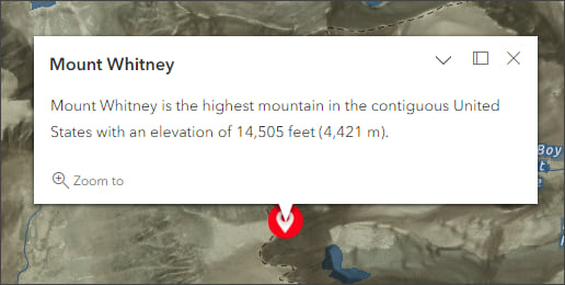

Add a marker with a pop-up
&Marker uses the following properties. To skip a property use double semicolons (;;). The marker properties must be in this order:  &marker=<x>,<y>,<WKID>,<title>,<symbol URL>,<text>. Click the marker to view the pop-up.
  • <x coordinate>,<y coordinate>—The location for the marker.
  • <WKID>—Spatial reference of the x,y coordinates to be added to the map. If you do not include a WKID, GCS coordinates are used.
  • <title>—Pop-up title. If you do not include a title, the pop-up will be empty.
  • <symbol URL>—Symbol for the point. If you do not include a symbol, a black circle marker symbol is used.
  • <text>—Text to include in the pop-up.
https://www.arcgis.com/apps/mapviewer/index.html?webmap=8152694dd9594393a1db4d62d2020fe3&marker=-118.292176;36.578494;;Mount Whitney;https://downloads.esri.com/agol/resources/symbols/misc/rm1.png;Mount Whitney is the highest mountain in the contiguous United States with an elevation of 14,505 feet (4,421 m).

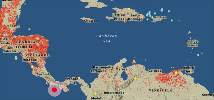

Open a map and add layers
This example opens a map and adds Recent Earthquakes and VIIRS Thermal Hotspots from ArcGIS Living Atlas. Use the &layers parameter to add the layers using their IDs, separated by a comma.
&layers=9e2f2b544c954fda9cd13b7f3e6eebce,dece90af1a0242dcbf0ca36d30276aa3

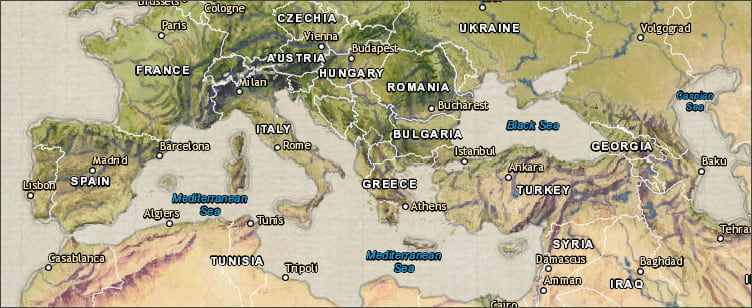

Open Map Viewer, add a basemap and reference layer
Use basemapReferenceUrl to set the reference layer to be used. This must be used along with basemapUrl. The example below adds the World Boundaries and Places reference layer to the Vintage Shaded Relief basemap layer, both from ArcGIS Living Atlas.
https://www.arcgis.com/apps/mapviewer/index.html?basemapUrl=https://tiles.arcgis.com/tiles/nGt4QxSblgDfeJn9/arcgis/rest/services/VintageShadedRelief/MapServer
&basemapReferenceUrl=https://services.arcgisonline.com/ArcGIS/rest/services/Reference/World_Boundaries_and_Places/MapServer
&level=3

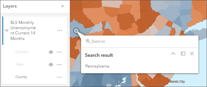

Set sublayer visibility
To set the visibility of sublayers for a layer that opened in the map, use layers=show. In this example using Bureau of Labor Statistics Unemployment from the Living Atlas, only the 3rd sublayer is visible. Note that sublayer numbering begins with zero (0) as shown in the REST endpoint.
Layers in REST endpoint
https://www.arcgis.com/apps/mapviewer/index.html?url=https://services.arcgis.com/P3ePLMYs2RVChkJx/arcgis/rest/services/BLS_Monthly_Unemployment_Current_14_Months/FeatureServer?layers=show:2&find=Pennsylvania
