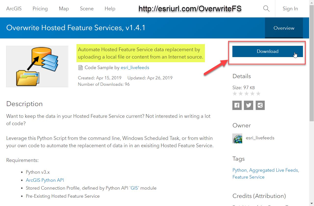

Step 1: Download the Script
Overwrite Feature Service Script

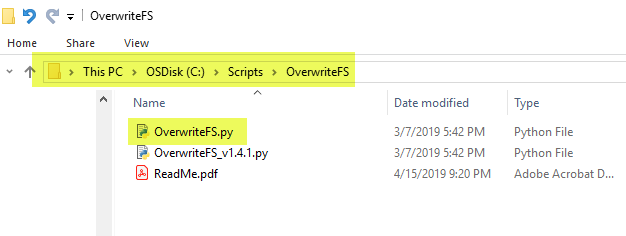

Extract and place the script in: “c:\scripts\OverwriteFS”
Step 2: Create a copy of the script and name it “OverwriteFS”
When importing a script, Python does not like multiple periods in the filename.
Create a copy of the script and name it “OverwriteFS”.

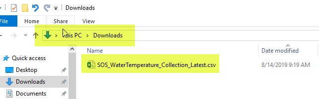

Step 3: Download water temperature data from source URL
Water Temperature Data downloaded from NOAA

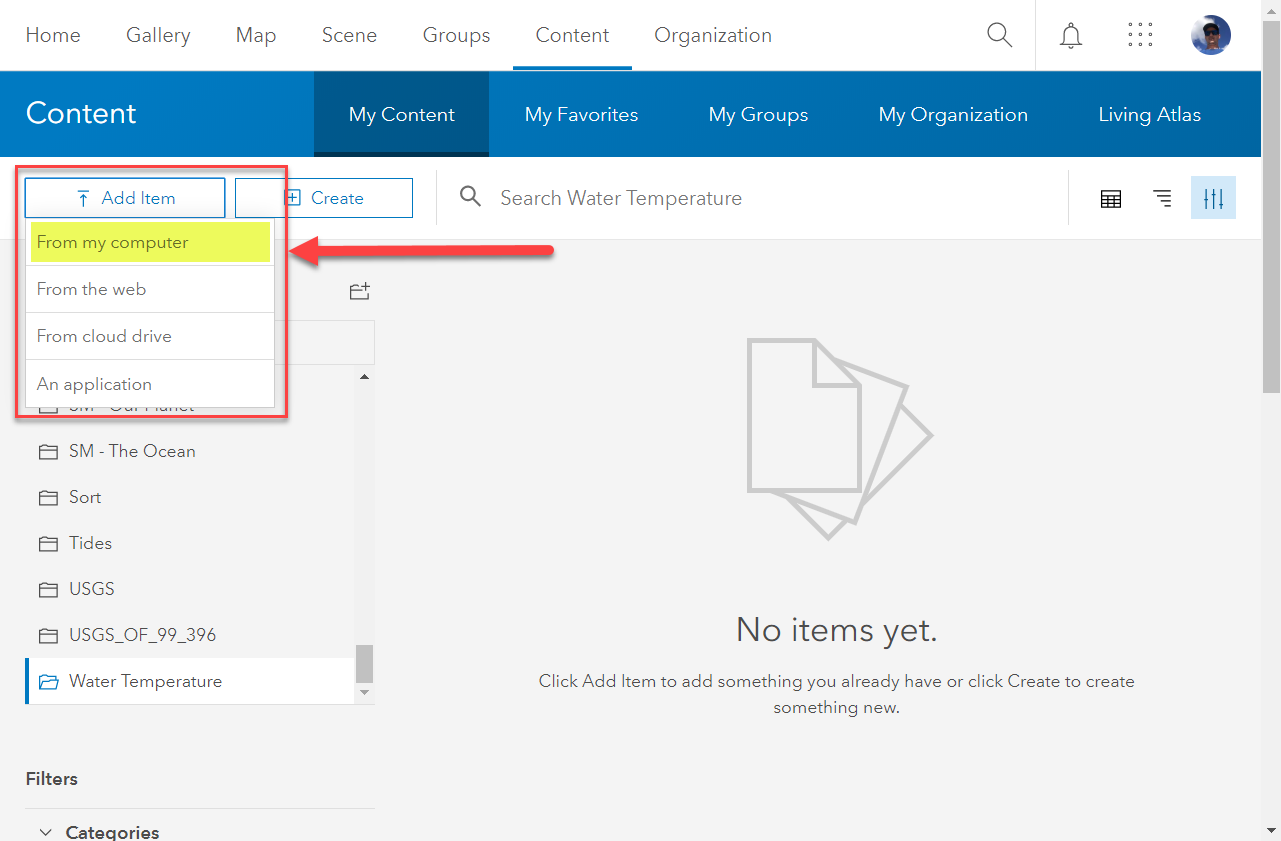

Step 4: Add Item to ArcGIS Online
Navigate to your content page and select “Add Item > From My Computer” (You must have publisher credentials to publish data).

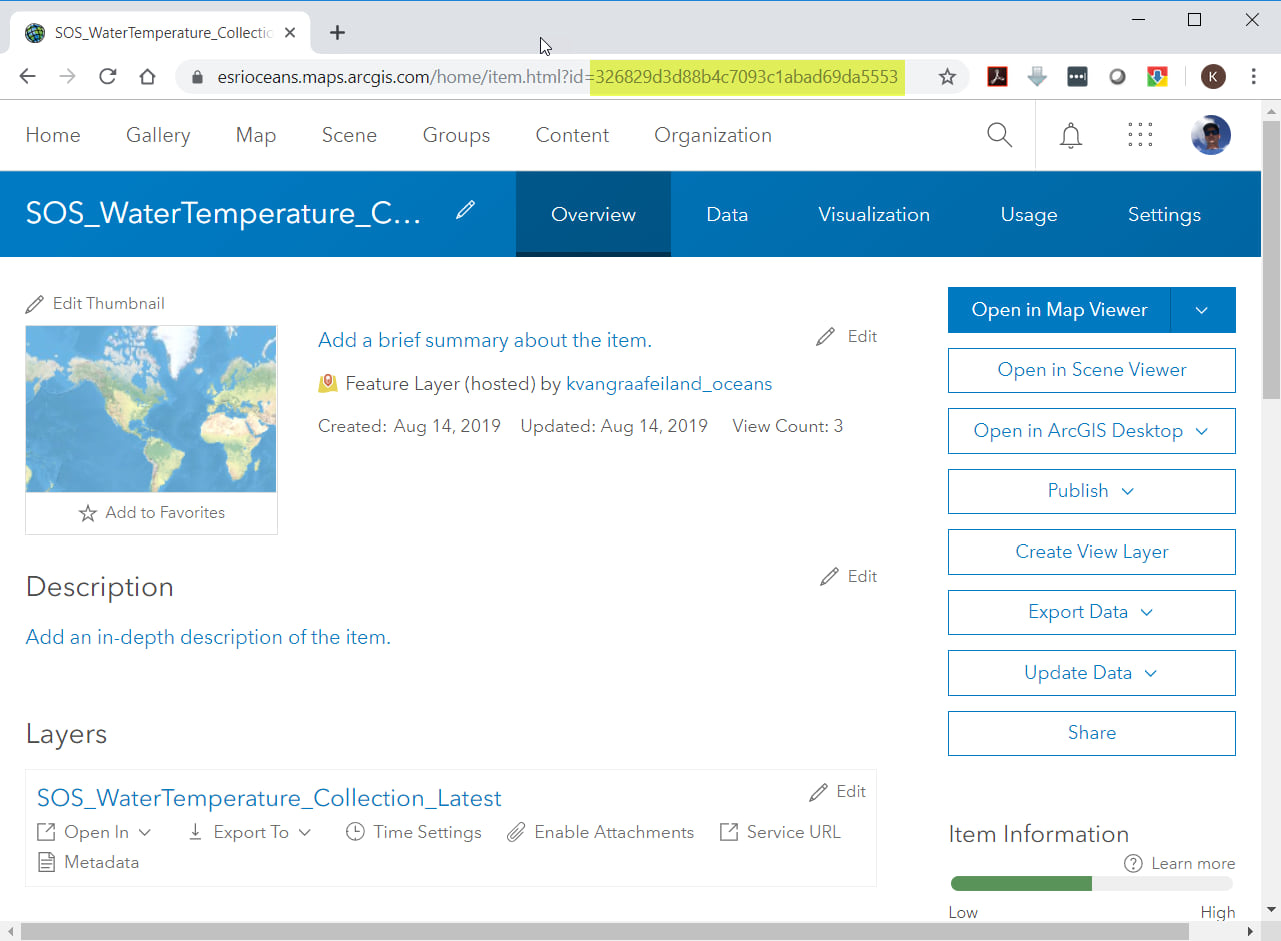

The newly created content item for Water Temperature should look like this:
take note of the item ID in URL (highlighted in image above).

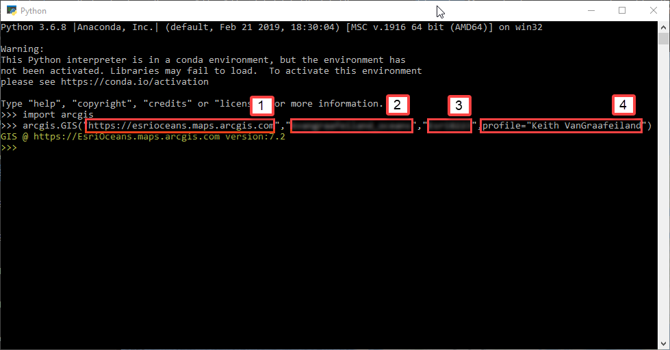

When the console launches type the following:
import arcgis
arcgis.GIS(“ArcGIS Online ORG URL”,”username”,”PASSWORD”,profile=”profile name”)
The highlighted portion is return indicating that the profile was created. (above)
1. ArcGIS Online Org
2. Username
3. Password
4. Profile Name

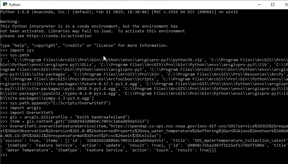

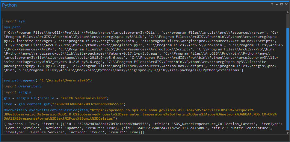

Method 1: Using ArcGIS Pro Python Command Line
Launch the Python Command Line from ArcGIS Pro “View” Menu.
First, register the directory where we saved the OverwriteFS.py script.
To do this, type the following:
import sys
sys.path
sys.path.append(r”C:\Scripts\OverwriteFS”)
Then import and execute the Overwrite FS.py script
import OverwriteFS
import arcgis
gis = arcgis.GIS(profile = “Keith VanGraafeiland“)
item = gis.content.get(“326829d3d88b4c7093c1abad69da5553“)
OverwriteFS.overwriteFeatureService(item,”https://opendap.co-ops.nos.noaa.gov/ioos-dif-sos/SOS?service%3DSOS%26request%3DGetObservation%26version%3D1.0.0%26observedProperty%3Dsea_water_temperature%26offering%3Durn%3Aioos%3Anetwork%3ANOAA.NOS.CO-OPS%3AAll%26responseFormat%3Dtext%2Fcsv%26unit%3DCelsius“)

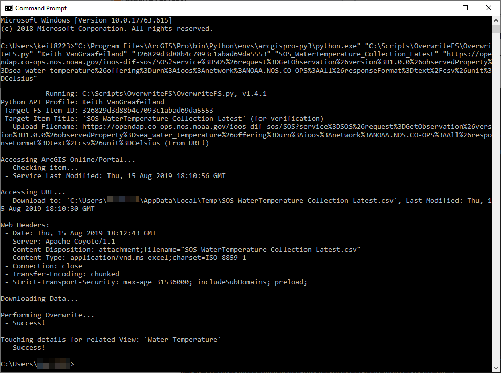

Method 3 – Command Prompt
Launch Command Prompt and call the Python Program to execute the script:
“C:\Program Files\ArcGIS\Pro\bin\Python\envs\arcgispro-py3\python.exe” “C:\Scripts\OverwriteFS\OverwriteFS.py” “Keith VanGraafeiland” “326829d3d88b4c7093c1abad69da5553” “SOS_WaterTemperature_Collection_Latest” “https://opendap.co-ops.nos.noaa.gov/ioos-dif-sos/SOS?service%3DSOS%26request%3DGetObservation%26version%3D1.0.0%26observedProperty%3Dsea_water_temperature%26offering%3Durn%3Aioos%3Anetwork%3ANOAA.NOS.CO-OPS%3AAll%26responseFormat%3Dtext%2Fcsv%26unit%3DCelsius
*Items in bold are user/item specific.
Running the script from the Command Prompt

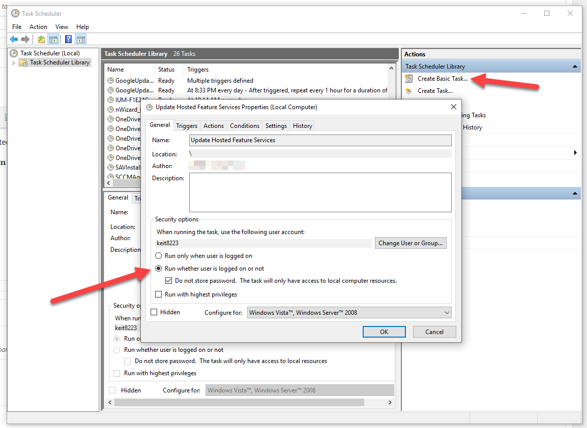

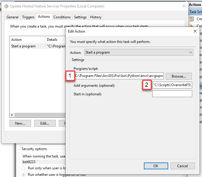

Step 7: Setting up script to run in Task Scheduler
Launch Task scheduler and “Create a Basic Task”.
Adding a basic task in Task Scheduler
Create a new Basic Task and name it appropriately.
Under security options: check “Run whether user is logged on or not” (so it will run without requiring the user to be logged in)
Select “Do not store password” (so it will run without requiring a stored user account password – which can change from time to time)
Add an action in Task Scheduler
Inputs for 1 and 2 in image above:
1. “C:\Program Files\ArcGIS\Pro\bin\Python\envs\arcgispro-py3\python.exe”
2. “C:\Scripts\OverwriteFS\OverwriteFS.py” “Keith VanGraafeiland” “326829d3d88b4c7093c1abad69da5553” “SOS_WaterTemperature_Collection_Latest” “https://opendap.co-ops.nos.noaa.gov/ioos-dif-sos/SOS?service%3DSOS%26request%3DGetObservation%26version%3D1.0.0%26observedProperty%3Dsea_water_temperature%26offering%3Durn%3Aioos%3Anetwork%3ANOAA.NOS.CO-OPS%3AAll%26responseFormat%3Dtext%2Fcsv%26unit%3DCelsius

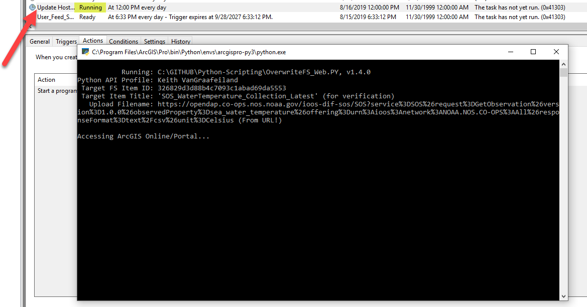

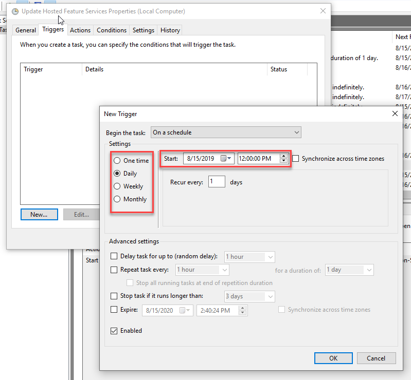

Triggers in Task Scheduler
Schedule the task to run as often as you like using the triggers tab.
Click “OK” to save the properties.
In the Task Scheduler Library – Right click and run the task to test and make sure it completes successfully.  When completed the task should indicate “Operation Completed Successfully”.

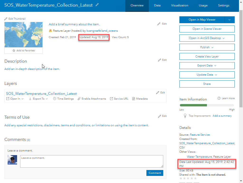

Check the content item, now you can see the “Data Update Details” reflect the most recent update.
Updated Content Item

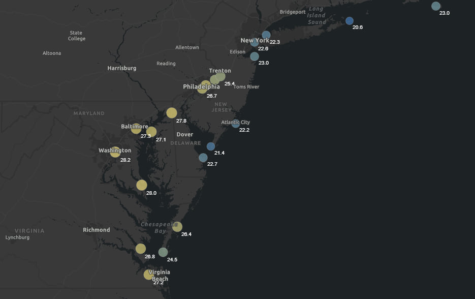

Water Temperatures (°C) off the Mid-Atlantic Coast of the United States. (Data Courtesy of NOAA Co-Ops)
