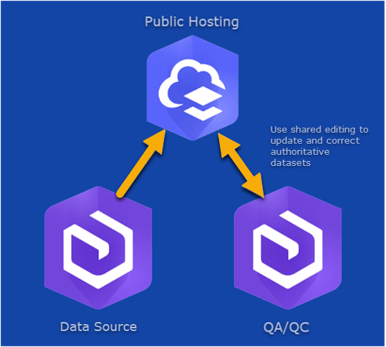

Single Source of Truth
One of the core goals of a robust GIS is to provide accurate and reusable datasets that are up to date. When you have important datasets that often involve input from multiple authoritative entities, establishing a single source of truth is a common goal for a variety of use cases. Prior to 10.9, distributed collaborations allowed for authoritative datasets to be shared across different organizations, even enabling them to stay up to date from the owner to the recipient. However, this presented a challenge when multiple organizations needed to be able to contribute their updates to this data. Using shared editing fits the single source of truth data model by enabling participating organizations to create and update records in the authoritative dataset and sync changes back to the source organization.
In this scenario shown in the image above, a public facing authority is using ArcGIS Online to host the authoritative dataset. Two contractors are working to furnish the public authority. The Data Source ArcGIS Enterprise organization has a one way collaboration set up to provide the publicly facing ArcGIS Online organization with the base data. The QA/QC contractor conducts data updates to the same dataset, ensuring that the latest data is being updated and validated as time goes on.

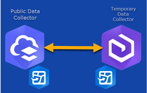

Field Collection
Distributed collaboration with shared editing enables networks of truth to be established among larger organizations; however there is also value to smaller organizations. Let’s consider a GIS department that primarily works on community data collection. Using two way sync, the organization can employ a contractor with their own ArcGIS Enterprise deployment to go out and collect datasets alongside them using ArcGIS Field Maps. Once the collection is done, the collaboration can be removed, while retaining the completed dataset.

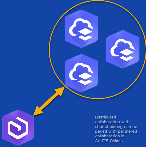

Partnered Collaboration
To further extend the network of a distributed collaboration, the host, ArcGIS Online, can simultaneously collaborate with another ArcGIS Online organization using partnered collaboration. Keep in mind that this is outside of the original distributed collaboration. Although you are only able to set up a distributed collaboration between one ArcGIS Enterprise organization, and one ArcGIS Online organization , partnered collaboration allows for Online organizations to create up to 10 partnered collaborations at a time. Consider using a combination of the two methods if needed to share content beyond just a single Online organization.
