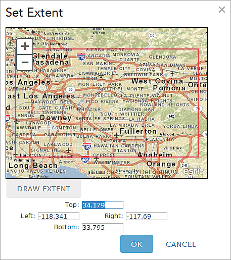

3. Use the plus and minus symbols to adjust the extent displayed as needed.

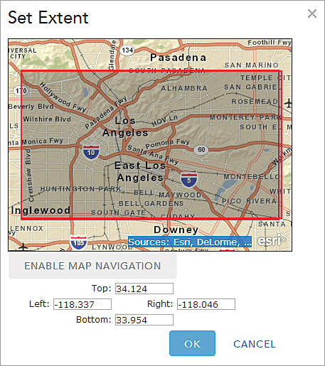

4. To draw the extent interactively, click Draw Extent and create a rectangle that encompasses the desired extent. Click Save.
5. If you already know the coordinates you would like to use for the extent, select the existing coordinate in each box and replace it completely with the new coordinate. Click Save.
6. No matter which method you used to assign the next extent coordinates, click My Content, then reopen the map you just modified. It should display the new extent.
