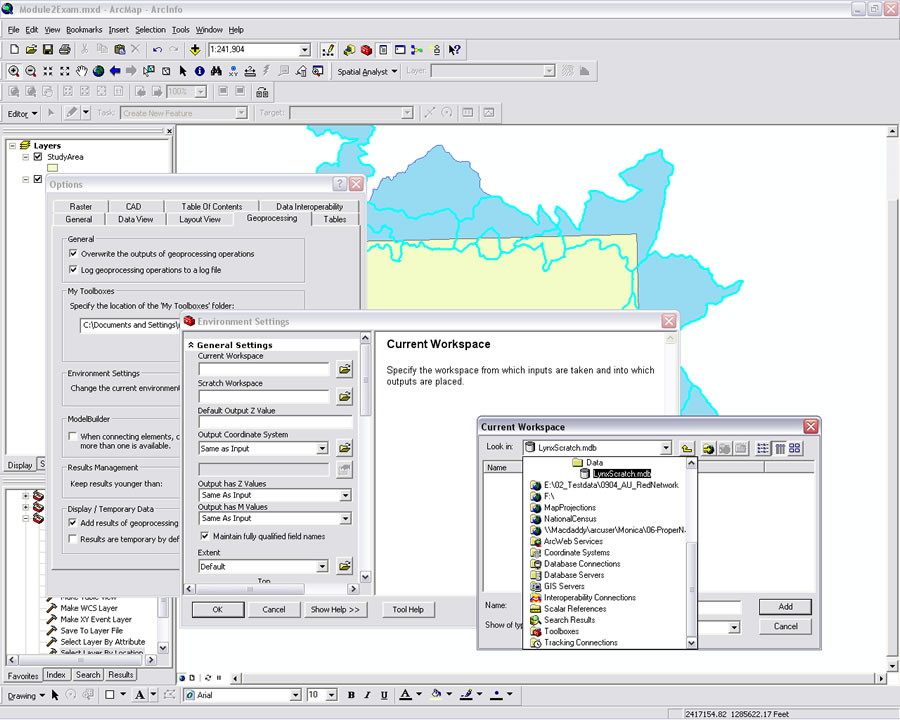

![]() Use the Environment Settings to direct outputs first to the scratch workspace and then to the final workspace. |

Create a scratch workspace to manage the data generated when performing geoprocessing operations such as changing the spatial reference of feature classes, creating new feature classes from existing ones, and performing other operations needed to prepare data before it can be used for analysis. Create a final workspace for feature datasets that have been processed.
By default, inputs and outputs from tools in ArcToolbox are directed to the current workspace. Initially, set the current workspace to the scratch workspace you created. Once processing is complete—and before any analysis operations—modify the current workspace to your final workspace.
To set the current workspace in either ArcMap or ArcCatalog, choose Tools > Options and click the Geoprocessing tab, then click the Environment button. Expand the General Settings to redirect output to the scratch geodatabase.
