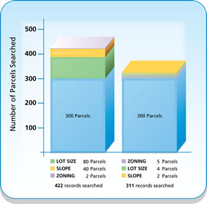

Understanding the data distribution in a data source will also help you create more effective queries by ordering operations to minimize the number of records that must be searched. Ordinarily, the terms in a query are evaluated from left to right. However, any portion of a query enclosed in parentheses will be evaluated first. You can order searches to limit the number of records that must be searched to locate the information you seek.
To extend the previous example, you need to find not only parcels with a certain lot size and slope but also parcels that are zoned for a specific commercial use. If you know that most parcels in this area are zoned for residential use, you can eliminate those records first to decrease the total number searched. This means that the query
"ZONING" = 'C-3' AND "LOT_SIZE" >= 1 AND "LOT_SIZE" <= 2 AND "SLOPE" < 5
will be executed more quickly than this query:
"LOT_SIZE" >= 1 AND "LOT_SIZE" <= 2 AND "SLOPE" < 5 AND "ZONING" = 'C-3'
