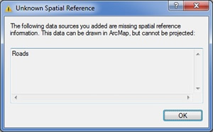

Step 1. Open ArcMap with a blank map and add the data that has the undefined spatial reference. You'll see the Unknown Spatial Reference error message. Click OK to dismiss it.
see enlargement This error occurs when data with an unknown spatial reference is added to ArcMap.

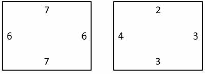

Step 2. In the table of contents, right-click the layer you just added from step 1, choose Properties, and go to the Extent tab. In the Extent box at the top, count the number of digits to the left of the decimal point for Top, Bottom, and Left and Right. Include plus and minus characters and ignore digits to the right of the decimal point. A good way to document the digits is to write the numbers in a box so you can refer back to them. When you finish, you may have an extent box that looks similar to the boxes below:
If your data has six to eight digits to the left of the decimal point in the extent box, then it is most likely in a projected coordinate system (PCS) like universal transverse Mercator (UTM) or State Plane. If your data has two or three digits to the left of the decimal point in the extent box, this data is in a geographic coordinate system (GCS), for example, World Geodetic System (WGS) 1984. If you're dealing with computer-aided design (CAD) data, you might see three, four, or five digits to the left of the decimal point, indicating the data is in a local coordinate system.
