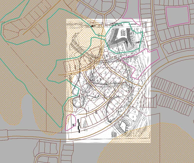

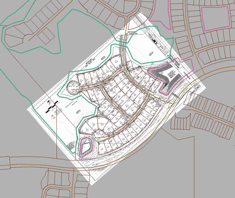

see enlargement
The image above is a scanned unaligned study area that needs to be georeferenced. The image below shows an image of the same area that has been georeferenced. It has been rotated, stretched, and aligned.

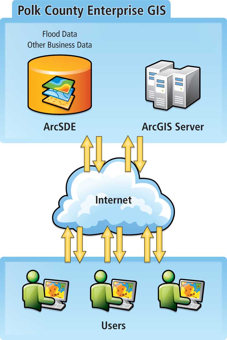

The process for accessing flood information

Potentially, this layer could be used online by county residents through Web GIS. By eliminating the need to contact the county, the county employee workload would be significantly reduced, saving money for the county and, ultimately, its residents. With the help of ArcGIS Server technology, users could not only acquire flood information but also perform GIS analysis online without actually learning GIS. For example, a user could find the locations of flood insurance offices or emergency shelters within a certain drive time or distance from a parcel and perhaps generate optimized routes to and from those locations.
