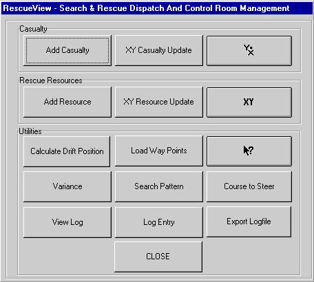

The result, initially developed in about two weeks, presents users with a pared down interface. All the buttons for RescueView functions are logically grouped and presented in a main dialog box. When an incident is called in, a station staff member creates an operation. To this operation, he adds what is currently known about the event such as a description of the victim, the victim's last known location, and the status of any responding units. Once entered, this information is automatically symbolized in the view.

All the buttons for RescueView functions are logically grouped in a main dialog box. |
The Drift Locator, the most important enhancement to come out of the Table Bay experience, calculates the current position of the victim based on the last known position and drift information gathered by rescuers. Drift is determined by putting a swimmer into the water and noting the start and end coordinates and time. The Drift Locator extrapolates the victim's position. Course to Steer functionality uses information from the Drift Locator to plot a course that helps rescuers travel directly to the casualty.
Search Pattern functionality supplies coordinates for standard search patterns so that rescuers can systematically work a sector and know which areas have been covered. The search routes for each boat can be displayed on-screen.
