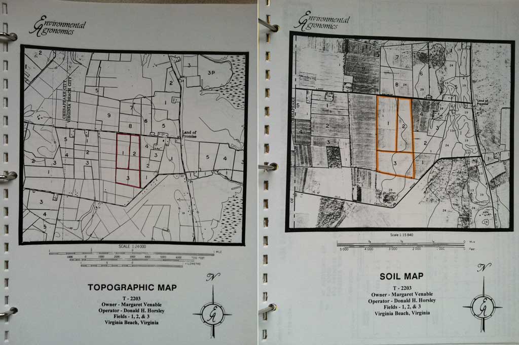

An example of a topographic and soil map found in HRSD's Field Site book
HRSD has been recycling Nutri-Green Biosolids to agricultural land application sites since 1981. Currently more than 1,500 acres of farmland in Chesapeake and Virginia Beach use biosolids each year on fields growing corn, soybeans, pasture, and hay crops.
HRSD's Treatment Department maintains biosolid land application sites. With help from a hired consultant, HRSD developed Field Site books that contain correspondence and maps pertaining to the physical and soil properties of the crop fields. The books are part of HRSD's Atlantic Plant Virginia Pollutant Discharge Elimination System (VPDES) permit and contain required regulatory information. Currently, more than 180 Field Site books have been created. However, over time, biosolids site information can change: property boundaries move, new farmers or landowners are added, and new buffer guidelines must be enforced. These and other changes require remapping and updating Field Site books.

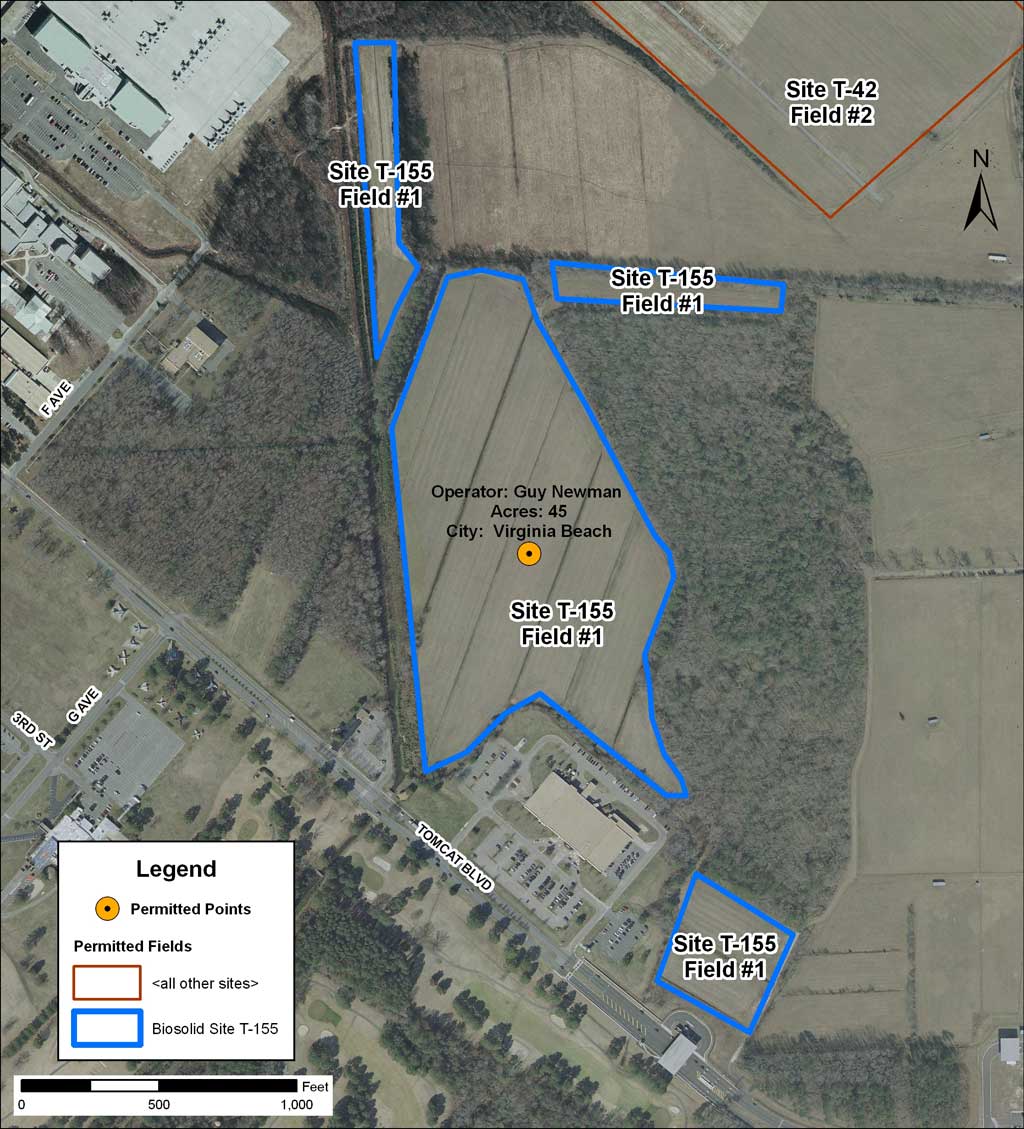

This biosolid site is represented by the same field number in various locations.
This biosolid site is represented by the same field number in various locations. Site T-155 shares the same field number but is represented by four polygon shapes because barrier structures, such as wooded areas and commercial properties, are present.

Biosolid site locations contain many fields associated with one site. Some sites share the same crop field number but must be represented as multiple polygon shapes because barrier structures—such as roads, bodies of water, wooded areas, and residential and commercial properties—break up biosolid farm sites. Other sites are associated with various, and at times recurring, field numbers in multiple locations, which could be challenging, especially for new users.

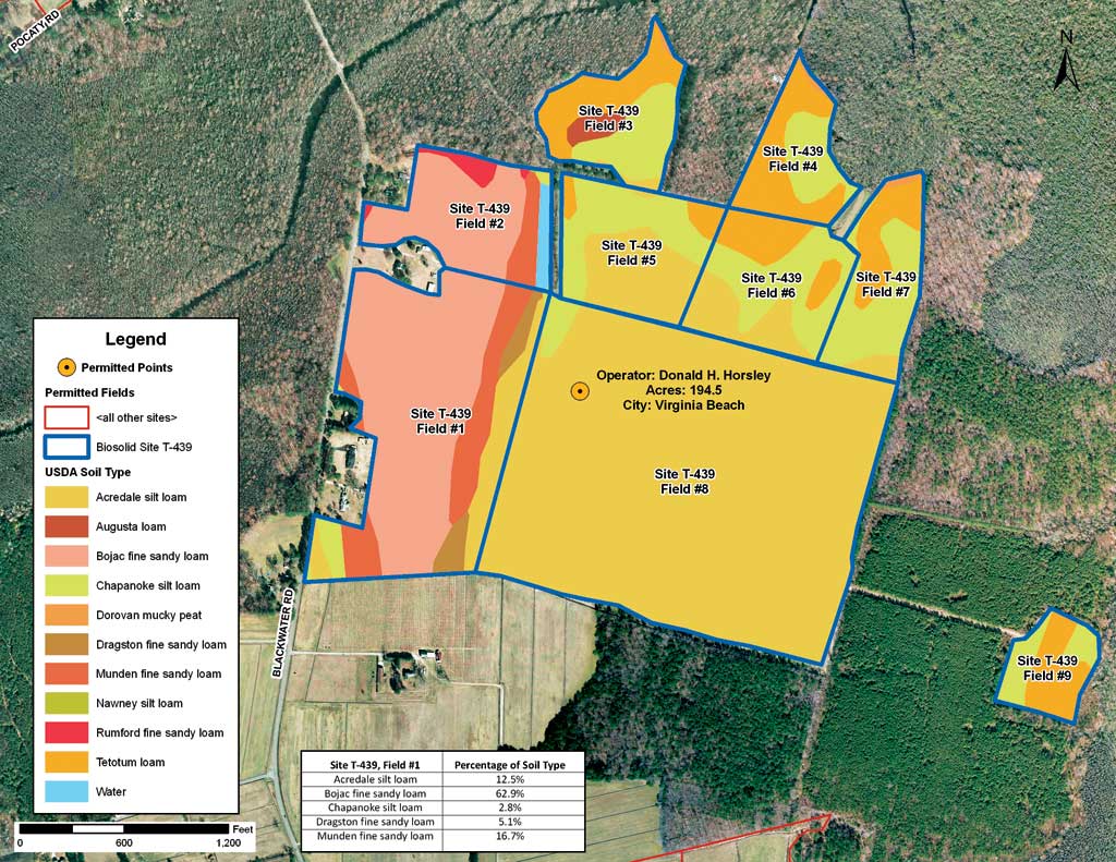

Additional attributes, such as its identifying site name, field number, operator, landowner, city, location, and acreage, were added to the Permitted_Points and Permitted_Fields layers. Attribute data was obtained from the Field Site books or by performing queries in ArcGIS on the data. The application of Nutri-Green Biosolids is based on existing soil conditions, so obtaining the soil data for Virginia Beach and Chesapeake was important. Rhonda Bowen, who is in charge of the Nutri-Green Biosolids Recycling Land Application Program, obtained current soil data from the United States Department of Agriculture Natural Resources Conservation Service Soil Data Mart website (datagateway.nrcs.usda.gov). The soil data was imported into the personal geodatabase so the PermittedSites_Soils layer could be manipulated.

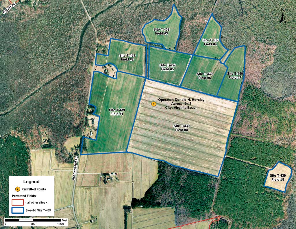

This biosolid site is represented by uniquely identified field numbers in various locations.
This biosolid site is represented by uniquely identified field numbers in various locations. Site T-439 is represented by nine polygons. Wooded areas act as a barricade structure that separates field #9 from the rest of the fields.
Because the soil type key field is not universal across the United States, matching the soil type key field with its soil description for Virginia Beach and Chesapeake was tricky. After downloading and adding the soil data to an ArcMap document, it was clipped against the Permitted_Fields layer to create individual soil areas for each field in each site. Dividing the size of individual soil areas by the entire site size produced the percentage of each soil type in each field. The percentage of each soil type was correlated with its field number (if it had the same field number); otherwise, the soil percentage value was broken down for each field number. This value was recorded in the Soil_Percent field of the attribute table for the Permitted_Fields layer.

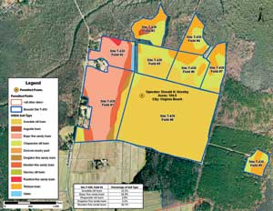

The soil types within each field are shown for Site T-439, a biosolid site.
The soil types within each field are shown for Site T-439, a biosolid site. The soil percentage was broken down for each individual field, as shown by field #1.
