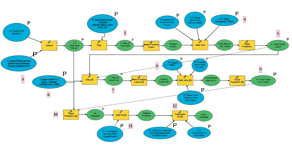

![click to enlarge](graphics/gismodeling_1.gif)
Pollutant Load Screening ModelStep 1
Step 1 is data preparation. The following processing steps happen at this time:
- Select watershed from GIS library (user input).
- Select soils layer from GIS library (user input).
- Intersect soils and watershed (output).
- Join soils attribute table to a soils groupings table (user input).
- Copy joined soils layer to a new location (output).
--The next steps do not happen until the final soils layer has been created.--
- Select land-use layer from GIS library (user output).
- Intersect land use and watershed (output).
- Join land-use attribute table to a land-use grouping table (user input).
- Copy joined land-use layer to a new location (output).
--The next steps do not happen until the final land-use layer has been created.--
- Copy basin boundary as a new layer and call it Rainfall.
- Add a field to the attribute table.
- Populate field with rainfall value.
See program metadata and documentation for more details.
