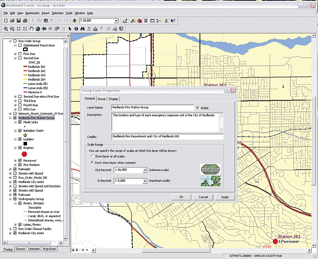

  1. Right-click on the layer to be packaged, open the layer properties for that layer, and begin by clicking the General tab.
    1. Update the layer name from the default name (which is the same as the layer source) to a name that is more useful.
    2. Add a description for the layer. The description will automatically appear with the shared content. Making an effort to include useful names and map properties in the description will make layer packages easier to discover.
    3. Include any copyright or source information in the Credits field.
    4. Adjust the Scale Range (if desired).
  2. Click the Display tab.
    1. Adjust transparency (if applicable) and adjust layer visibility to show symbols or sub-layers.
  3. Click the Symbology tab.
    1. Update Labels with user-friendly names.
    2. Update the symbol properties so that all items of the same type (points, lines, polygons) are represented in a similar way. Uncheck the All Other Values option because it is not needed and will appear in the final legend.
    3. Make any other necessary adjustments to the symbology.
  4. Click the Fields tab.
    1. Uncheck fields that are irrelevant to the user or that do not provide essential information.
    2. Enter aliases for any checked fields that do not have user-friendly names.
  5. Click OK to apply these changes.
