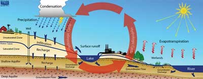

Water moves on, above, and below the earth's surface changing state from liquid to vapor to ice. This continuous movement is known as the water cycle or hydrologic cycle. The importance of understanding recharge and discharge processes within the hydrologic cycle has led the National Research Council (NRC) to characterize research on these processes as a critical national research priority. NRC is part of the private, nonprofit institution that provides science, technology, and health policy advice to improve government decision making; increase public education; and better the understanding of science, engineering, technology, and health. The authors have developed a GIS-based tool for better the understanding these processes.
Community leaders and engineers tasked with managing water supplies must understand where the water is and how it moves through the hydrologic cycle. Among the least understood pathways are groundwater recharge and discharge, whose rates and spatial distributions define the relationships between groundwater and the other components of the hydrologic cycle such as precipitation, evapotranspiration, and surface water.
click to enlarge
The Water Cycle—Climate, surface water, and groundwater are linked and recharge/discharge presents the interactions across the interfaces.

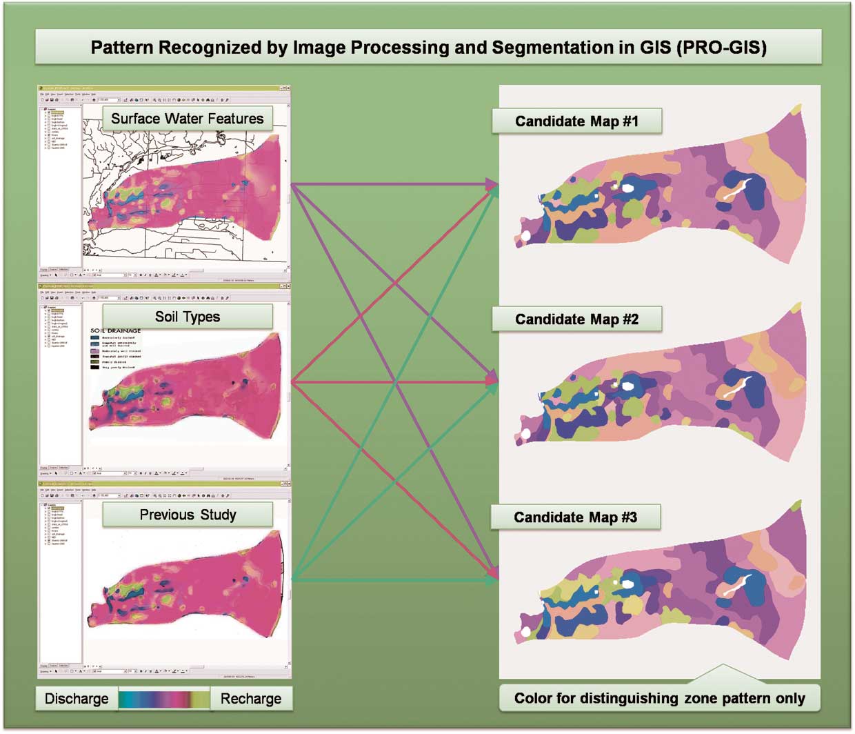

Spatial recharge and discharge pattern recognition and prioritization collaborated with ancillary information using PRO-GRADE in ArcMap
PRO-GIS is a general utility that organizes several image processing algorithms into one user interface to offer the flexibility to extract spatial patterns according to the user's needs. It provides generic pattern recognition functions that support virtually any spatial decision support system (SDSS) used to assist in management applications such as water resources, land use, and agricultural development. GRADE-GIS is a groundwater recharge and discharge estimation interface that requires only the raster files for hydraulic conductivity and water table and bedrock elevation data for two-dimensional steady-state unconfined aquifer systems.

Recharge and discharge patterns are generated by PRO-GRADE and surface water maps from the National Hydrology Dataset (NHD).
For example, recharge and discharge are known to relate to surface water features, soil types, land use, and topography. However, there is no deterministic function to delineate these relationships. The current version of PRO-GIS implements three image processing methods using different approaches—the 2D Moving Average, normalization, and TVL1 Low Pass Filter.

The output raster file of recharge and discharge rates from GRADE-GIS is format-ready for PRO-GIS, which can perform further pattern recognition to identify the recharge and discharge zones. The coupling processes of using GRADE-GIS and PRO-GIS can provide a fast initial estimate prior to planning labor-intensive and time-consuming field recharge and discharge measurements. With the ArcGIS platform, the resultant recharge and discharge maps from PRO-GRADE can be cross analyzed with ancillary field information, such as land coverage, soil type maps, surface water distribution, and topographic slope, that has a direct but unquantifiable relationship with recharge and discharge.
Real Applications
This new approach has been tested using the dataset from the Buena Vista Groundwater Basin, a thoroughly understood system in the Central Sand Plains of Wisconsin. The coupling processes of using GRADE-GIS and PRO-GIS enable users to generate as many alternative recharge and discharge maps as necessary within minutes or hours. Users can compare alternative maps with external information in GIS and prioritize alternatives.
Prioritized recharge and discharge maps can be used as an initial guideline for field study planning and decision making or can be used as initial conditions for numerical simulation and parameter estimation for more detailed analysis. PRO-GRADE is currently being used for several studies including an ongoing assessment of the water resources of the 11 counties in northeastern Illinois.
click to enlarge
Recharge and discharge patterns generated by PRO-GRADE are superimposed on maps of surface water and soil type in ArcMap.
