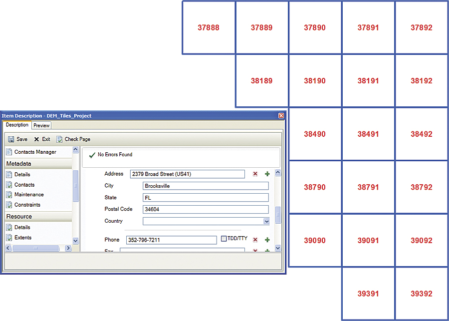

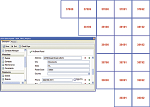

ArcGIS software's Item Description editor provides metadata authors with the ability to see the data relating to the metadata.
ArcGIS software's Item Description editor provides metadata authors with the ability to see the data relating to the metadata. A simple digital elevation model (DEM) tile layout is depicted while preparing a template for file-level metadata generation. The Metadata Contact Address section is active and is an example of a section that is predetermined and could be built into a government agency's template.
