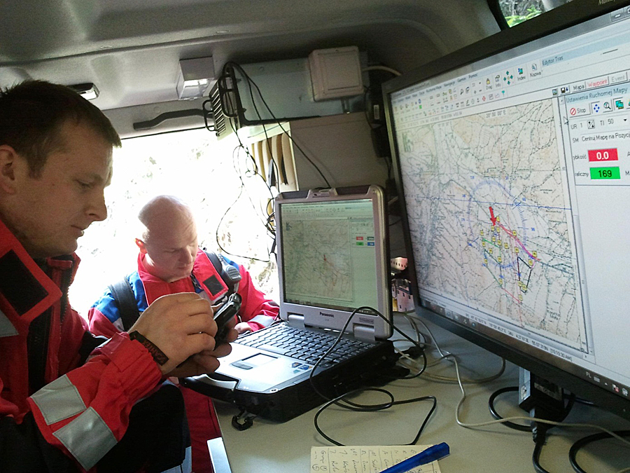

The mobile command station of Podhalanska Group.
Using a database created with statistics gleaned from previous explorations allows Podhalanska Group (PG) to increase the likelihood of finding lost persons. The implementation of data from PG's database in its GIS allows rescuers to model the movement of lost people in the area of interest. In exploratory analyses, Podhalanska Group uses the following parameters.

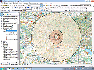

Distance from IPP
The initial planning point (IPP) is a point used for search planning. The IPP is very often the point a person was last seen (PLS). Planners usually define PLS as a person's last known point of travel, such as a parking lot. The total search area is designated by a circle, in which the likelihood of finding a person in the field is approximately 95 percent (that is, 95.5 percent of the values lie within a distance ≤ 2 sigma [standard deviation] from the expected value, a normally distributed data assumption). The circle is not the final frontier of search but can be further defined based on terrain features, and it should be suitable for a specific exploration scenario.

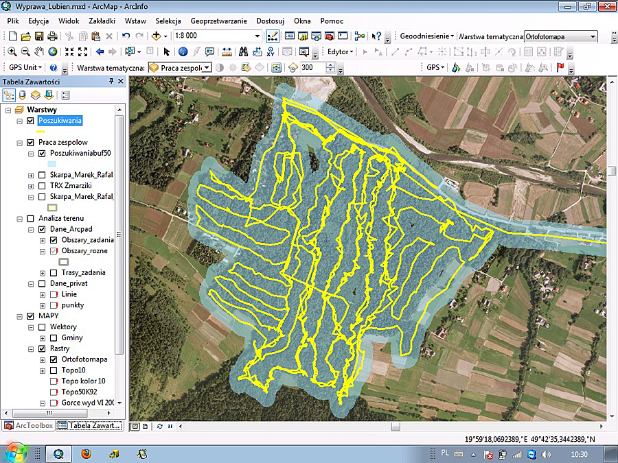

Fast three method allows greater flexibility in the choice of route exploration in comparison with other methods.
"Fast three" method allows greater flexibility in the choice of route exploration in comparison with other methods.

The total search area is a circle in which the likelihood of finding a lost person is 95 percent.
