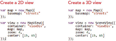

With the introduction of map views, developers can render a map with a 2D view or a 3D view (or both) with just a few lines of code. Working with a 3D view is much like working with a 2D view. For example, both views have a unified approach for working layers, renderers, tasks, geometry, symbology, pop-ups, and navigation, but 3D adds 3D-specific concepts such as environment (atmosphere and lighting) and the camera. Compare the code for creating a 2D view and a 3D view shown in Listing 1.

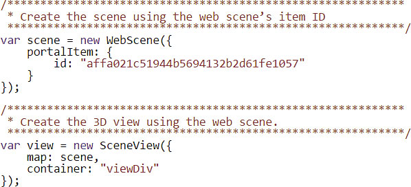

With the 4.0 API, you can follow the same pattern with 3D maps using web scenes. This is accomplished by styling your map in ArcGIS Online or Portal for ArcGIS, saving it as a web scene, and then loading it in your app using the web scene’s ID.

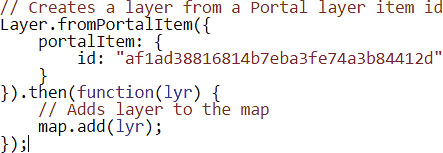

Layer items are similar to web maps in that they allow developers to set up initial extent, rendering, filtering, pop-ups, and other settings. In contrast to web maps, which consist of the entire map, layer items represent individual map layers. This allows you to choose the individual layers needed for each application. If you are developing in a team environment, others can also consume your layers, which are represented in a meaningful and consistent way. The 4.0 API lets you load layers by referencing the layer item’s ID. Listing 3 shows an example of how a layer can be loaded using the layer item.

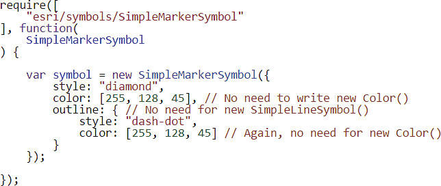

In the example in Listing 6, the SimpleMarkerSymbol’s properties are simply set in the constructor. The 4.0 API also introduces a new concept called autocasting, which takes the values passed in these properties and instantiates the typed objects internally within the API. The example illustrates how you don’t have to explicitly create a new SimpleLineSymbol for the SimpleMarkerSymbol’s outline. Thanks to autocasting, the require statement for the esri/symbols/SimpleLineSymbol module is not needed.
