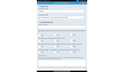

Tickets received from WV811 are created in an ArcGIS geodatabase accessible to all involved Mountaineer staff. By using a dashboard, dispatchers can readily see the number and status of all tickets, sort the tickets by area and type, select a ticket, highlight it on the map, and assign it to a worker in that area. The field worker assigned to the ticket can then open it on their smart device using a mobile app, get directions to its location, complete a survey detailing the work performed, and provide confirmation of completion of the assignment.
![View of Locate Response App](/en-us/lg/industry/electric-and-gas/stories/mountaineer-gas-company-case-study/_jcr_content/par/grid_container_copy/gc-par/columnsystem/wpar/image.coreimg.jpeg/1715202204102/facility-locate-response.jpeg)
