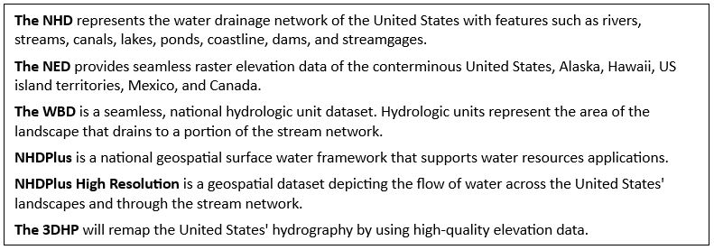

Modernizing Hydrography Data: Using Elevation Data for Feature Extraction
The development of a digital nationwide hydrography dataset began in the 1970s with the conversion of data from paper topographic maps. This data has provided the foundation for national hydrography data for decades. Over time, the data matured into what we know as the National Hydrography Dataset (NHD). This dataset included US Geological Survey (USGS) hydrography and eventually took advantage of capabilities within the National Elevation Dataset (NED) and the Watershed Boundary Dataset (WBD) to create NHDPlus and NHDPlus High Resolution. As technology advanced, demand for advanced capabilities grew. In 2023, the NHD was retired and the 3D Hydrography Program (3DHP) began. The 3DHP marks the beginning of the first comprehensive update for nationwide hydrography features since they were transferred from paper to digital maps.

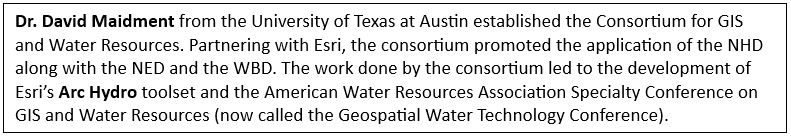

By the early 1990s, the Federal Geographic Data Committee began discussions that led to the inclusion of hydrography in the National Spatial Data Infrastructure. The USGS and the US EPA initiated a project to integrate the EPA’s Reach File stream network data with USGS hydrography. This collaboration leveraged water applications expertise within the EPA and the geospatial data production and maintenance infrastructure of the USGS. The result of this work is what we now know as the National Hydrography Dataset. The NHD project had a goal to develop and maintain a digital 1:100,000-scale stream network.
Development of Functionality
Development of the NHD continued to advance over the next three decades. By the late 1990s, the project team had automated integration of the EPA’s Reach File stream attributes and the USGS digital line graph hydrography. The US EPA, the USGS, and partners at the state level processed data using geographic information system (GIS) software and hardware to ensure data quality. In 2000, the hydrography data from USGS topographic maps was transformed into watershed-based surface water features.

In the early 2000s, the US EPA and the USGS wanted to support pollutant dilution modeling, which required extended capabilities such as calculating stream flow volume and velocity. This is what drove the development of NHDPlus, a suite of geospatial products that build on and extend the capabilities of the NHD, NED, and WBD.
Work started on the development of streamflow estimates and a high-resolution (1:24,000 scale) dataset (NHDPlus). Streamflow estimates required that local drainage areas be defined so that data such as precipitation and temperature could be related to stream segments. After a review of various methods for catchment delineation, it was determined that the hydrologically conditioned elevation-based technique produced the best results and was feasible to implement nationally. This method conditioned elevation data by trenching NHD streamlines and raising the WBD ridgelines in preparation for delineating catchments.
NHDPlus is widely used. The USGS and US EPA learned a lot about how water resources professionals wanted to use the data and how it could be improved. In 2012, NHDPlus version 2 was released. In addition to streamflow and velocity, NHDPlus provides value-added attributes, including stream order and a group of attributes that facilitate rapid stream network traversal and query. NHDPlus catchments are used to associate other landscape attributes, such as land cover, with stream segments. In 2022, NHDPlus High Resolution (NHDPlus HR) release 1 became available for download. NHDPlus HR presents a single, nationally continuous representation of all published NHDPlus HR Vector Processing Unit (VPU) datasets. An important addition to NHDPlus HR is a digital object identifier, which allows for citation of the data in scientific studies and reports.
Launching a 3D Hydrography Initiative
In 2021 the USGS began collecting feedback on a 3D national topography model and a 3D hydrography program. This initiative focused on updating and integrating USGS elevation and hydrography data into an integrated 3D model to deliver higher-quality data and support improved geospatial analysis.
In 2023 the NHD was retired and the initiative to remap the nation’s hydrography using high-quality elevation data was launched. The 3DHP replaces the NHD, WBD, and NHDPlus HR with a single product. 3DHP data includes lakes, streams, catchments, drainage areas, and other hydrologic features that have been derived from USGS 3D Elevation Program (3DEP) lidar data.
