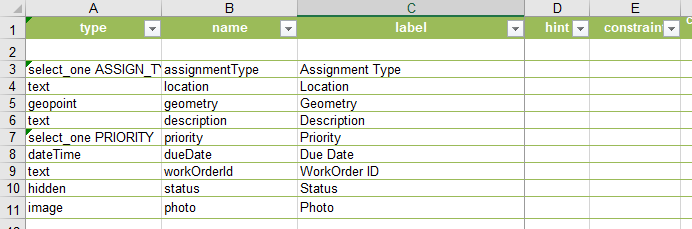

A survey is created using all the fields in the view. The spreadsheet that defines the survey opens. In the Settings tab, you see the fields you included in your view. In the Choices tab, you see that the types, statuses, and priorities from Workforce are honored. Make sure not to change these.
Note: If you didn’t use a hosted feature layer view to remove some fields, you could also remove them from the survey by removing them from the spreadsheet.

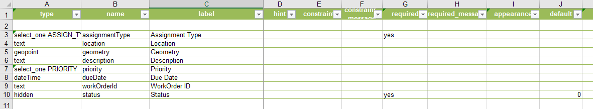

The mobile worker must give a status and assignment type, so mark them as required in the spreadsheet.
![Require status and assignment type Require status and assignment type](https://www.esri.com/arcgis-blog/wp-content/uploads/2018/07/02-reqFields.png)

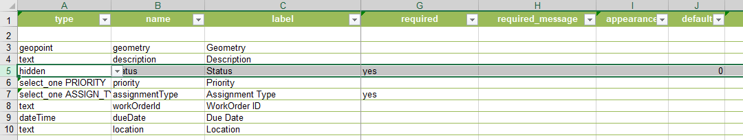

Since you don’t want the mobile workers changing the assignment status, set that field’s type to hidden, and give it a default value of 0 (unassigned).
![Hide the status field Hide the status field](https://www.esri.com/arcgis-blog/wp-content/uploads/2018/07/03-hideStatus.png)
Reorder the fields in the spreadsheet so that required and more commonly populated fields display first.
![Reorder the fields Reorder the fields](https://www.esri.com/arcgis-blog/wp-content/uploads/2018/07/04-reorderedFields.png)

Want to let your mobile workers add attachments? Add a question of type Image, with a name and label like “photo:”
![Add an image question Add an image question](https://www.esri.com/arcgis-blog/wp-content/uploads/2018/07/06-photoQuestion.png)

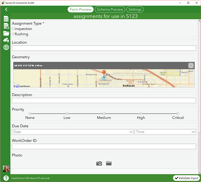

Save your spreadsheet changes, and the preview of the survey in the Survey123 Connect window updates to show your changes.
![Preview of the survey Preview of the survey](https://www.esri.com/arcgis-blog/wp-content/uploads/2018/07/07-survey-60.png)

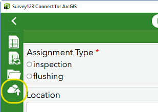

Click Publish.
![Publish the survey Publish the survey](https://www.esri.com/arcgis-blog/wp-content/uploads/2018/07/08-publish-80.png)
You are reminded that you used an existing feature service, so a new feature service won’t be created. Click Publish Survey. Your survey is published to your ArcGIS organization in a folder of My Content that is named with “Survey-” followed by your survey name.
