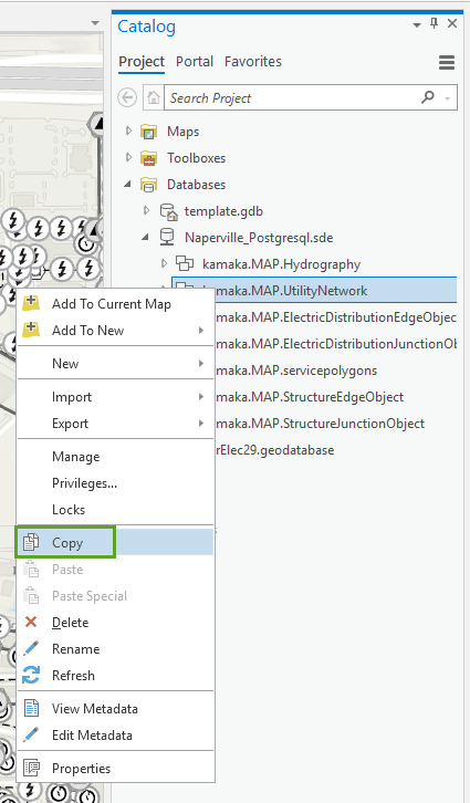

One of the more obvious efficiencies introduced with this release is a new capability to support data migration workflows. With 2.9, the utility network can be migrated between geodatabases for staging and testing using the Copy and Paste tools in the Catalog pane or Copy geoprocessing tool. While the Asset Package remains the default and recommended method for staging your utility network, this option will benefit users who want to stage and configure their utility network in a file geodatabase before moving into production with an enterprise geodatabase. With support now available for the utility network on mobile (.sqlite) geodatabases, this simple migration path paves the way for future support of offline workflows in runtime and mobile applications that require a mobile geodatabase.

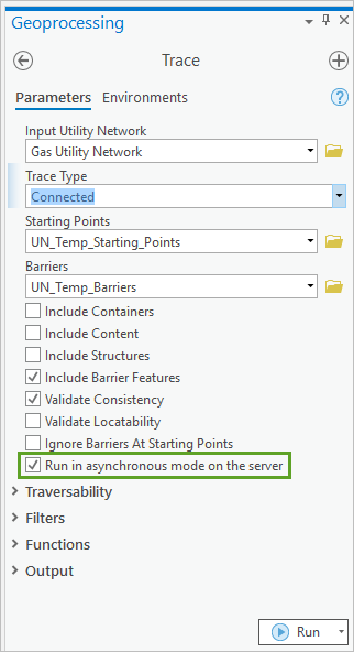

As mentioned above, the Trace tool now allows you to execute trace operations asynchronously using the Run in asynchronous mode on the server option. Additionally, we have extended the options available to control how trace output is returned with the introduction of Connectivity and Elements.
![Run in asynchronous mode on the server parameter on the Trace tool Run in asynchronous mode on the server parameter on the Trace tool](https://www.esri.com/arcgis-blog/wp-content/uploads/2021/10/Trace_AsyncOption.png)

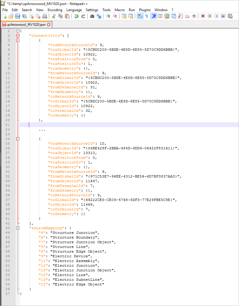

The Connectivity result types option returns trace results as a connectivity graph of network features connected through geometric coincidence or connectivity associations. When this option is selected, connectivity is output to a .json file in the specified location that can be parsed and imported into other 3rd party systems (such as an ADMS or CRM) to facilitate integration. When working with ArcGIS Enterprise, this makes use of a new supportsTraceConnectivityResults capability available with 10.9.1.

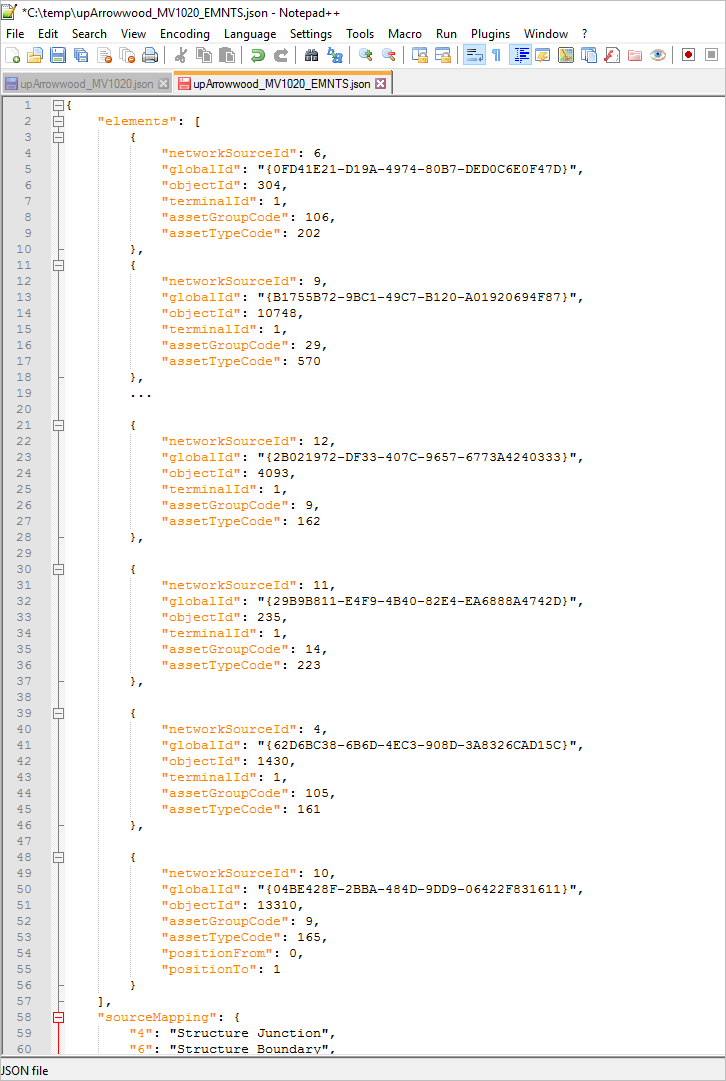

Elements returns additional information about the network features that are traversed during a trace operation and outputs this to a .json file for input into other tools or processes for additional analysis.
For example, with the elements option, you can develop an automated process that performs a headless trace in Python and uses the output elements from the trace result to set the values on the network features for reporting or other purposes.

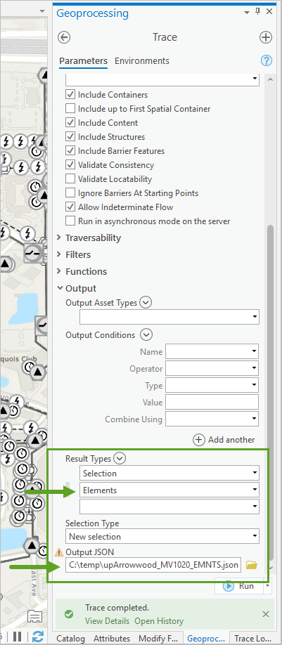

When either of the new Result Types options are selected, a new Output JSON parameter will appear in the Trace tool to control where the output is stored. These outputs may look familiar if you’ve ever inspected the .json created from the Export Subnetwork tool. By extending this capability to trace results, we can constrain the output to a specified subset without the need to parse the output from an entire subnetwork. All Result Types options can be used in conjunction to achieve the results you are looking for.
