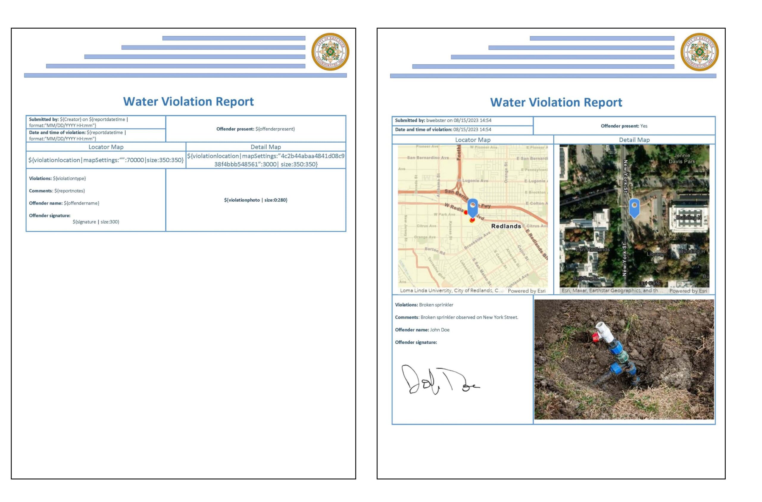

Reports are generated based on a report template associated with the survey. A report template is a Microsoft Word document that provides the report formatting and includes placeholders to indicate where survey data should be inserted when the report is exported. Since the template is a Word document, almost any formatting options that are possible in Word can be included in your template. This could include images or logos, text formatting, tables, headers, and footers. This customizability is useful for designing visually appealing reports, but it is also useful when adhering to a required report format, for example when submitting data to a government agency. See below for examples of report templates and an example of an exported report.

An individual report displays the data for a single survey record, while a summary report displays data for multiple records in one report. Summary reports often aggregate the data using statistics. For example, if we have a survey that documents a water violation, an individual report will show details for a single specific water violation. A summary report, on the other hand, would display statistics for multiple violations, for example the total count of violations or the total count of each type of violation.
The report template’s syntax determines whether a report will be a summary report or an individual report. A summary report has a designated start tag and end tag, and everything between the two tags will be treated as a summary section.

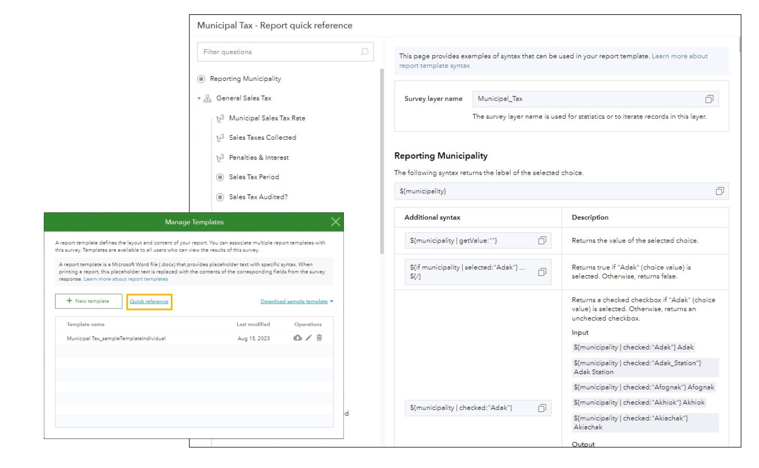

Quick reference
The first resource for getting started with building a template is the quick reference. This option provides examples and descriptions for various methods and parameters that can be used for each question in your survey.
These syntax snippets include the question names from your survey, so they can be copied and pasted directly into your report template. The quick reference section is a good way to discover the different report syntax options that are available.

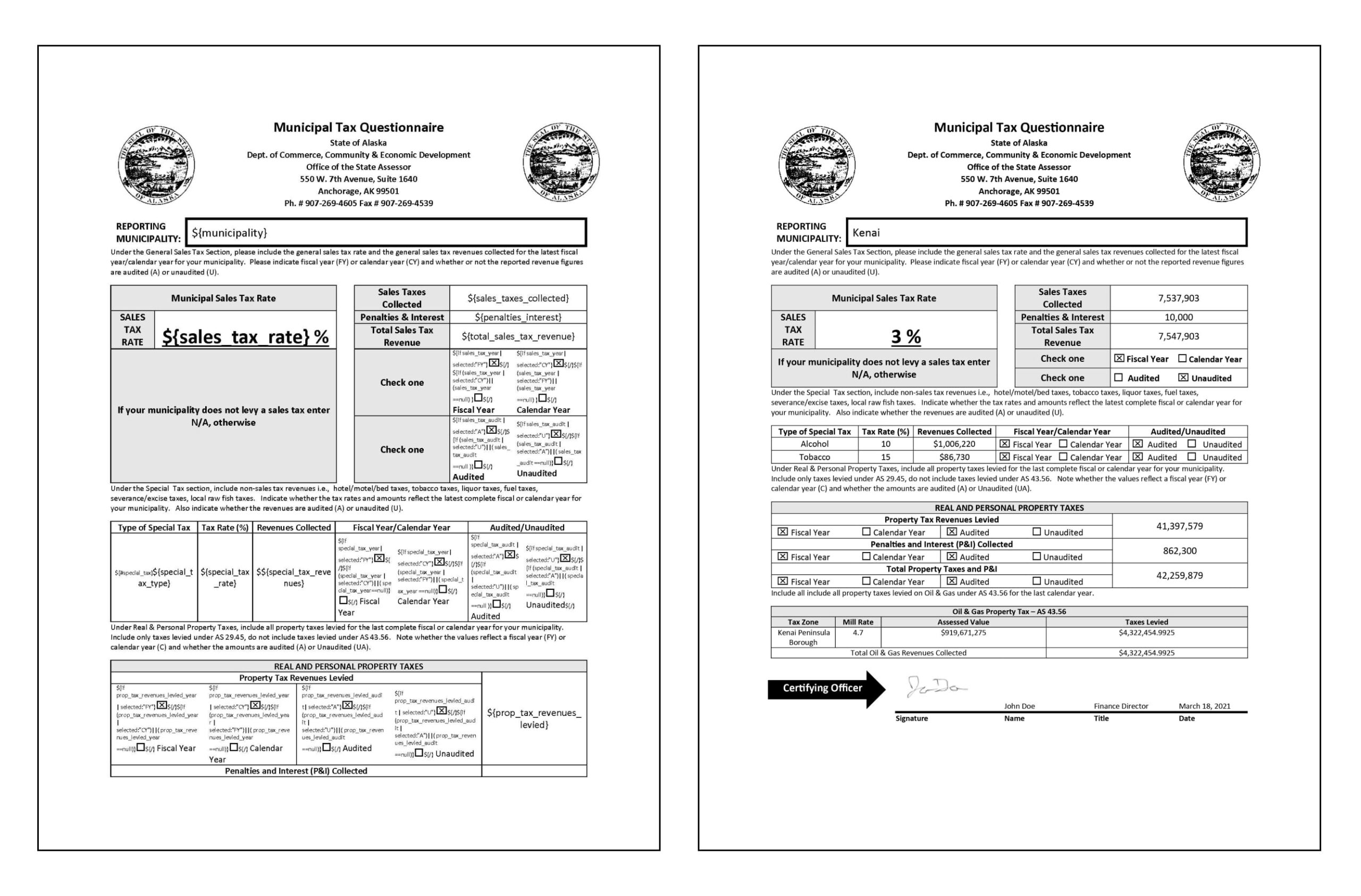

Another resource for getting started with report templates is the sample template option in the Survey123 website. This option generates a report template that includes the labels and placeholder syntax for all questions and repeats in your survey. You can then modify this template by removing unwanted questions, reordering questions, adding methods, and so on.

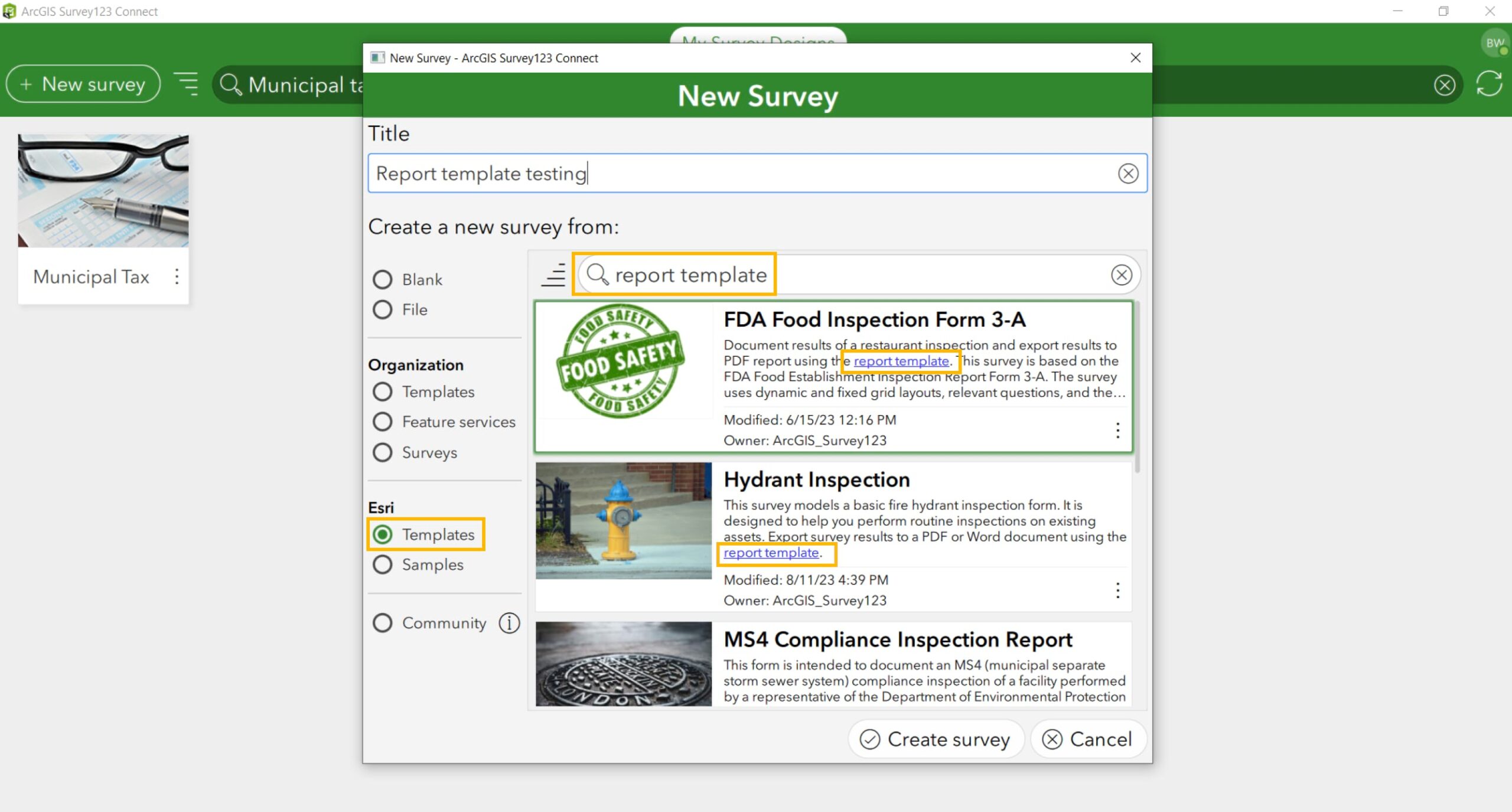

Esri templates gallery
If you’d like to see examples of completed report templates, some of the Esri templates available in Survey123 Connect include report templates that can be used with the samples. You can find these by opening Connect, clicking Esri Templates, and searching for “report template”. The survey template description includes a hyperlink to the report template.
