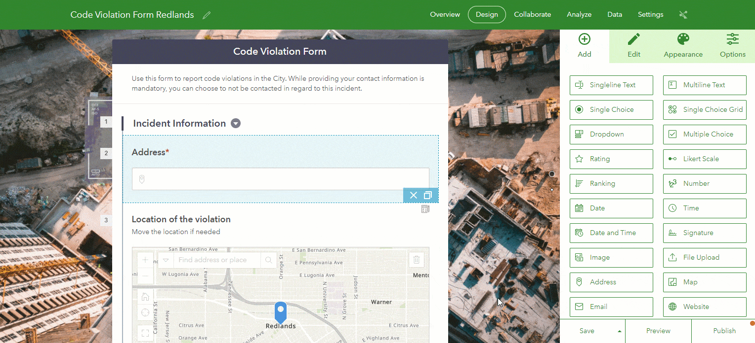

The Survey123 web designer helps you visually create smart forms, right from a web browser. In recent updates we added support for the new Address question type, introduced calculations, and added options to permanently hide questions in your form.
This release brings more enhancements to the Map and Address question types.

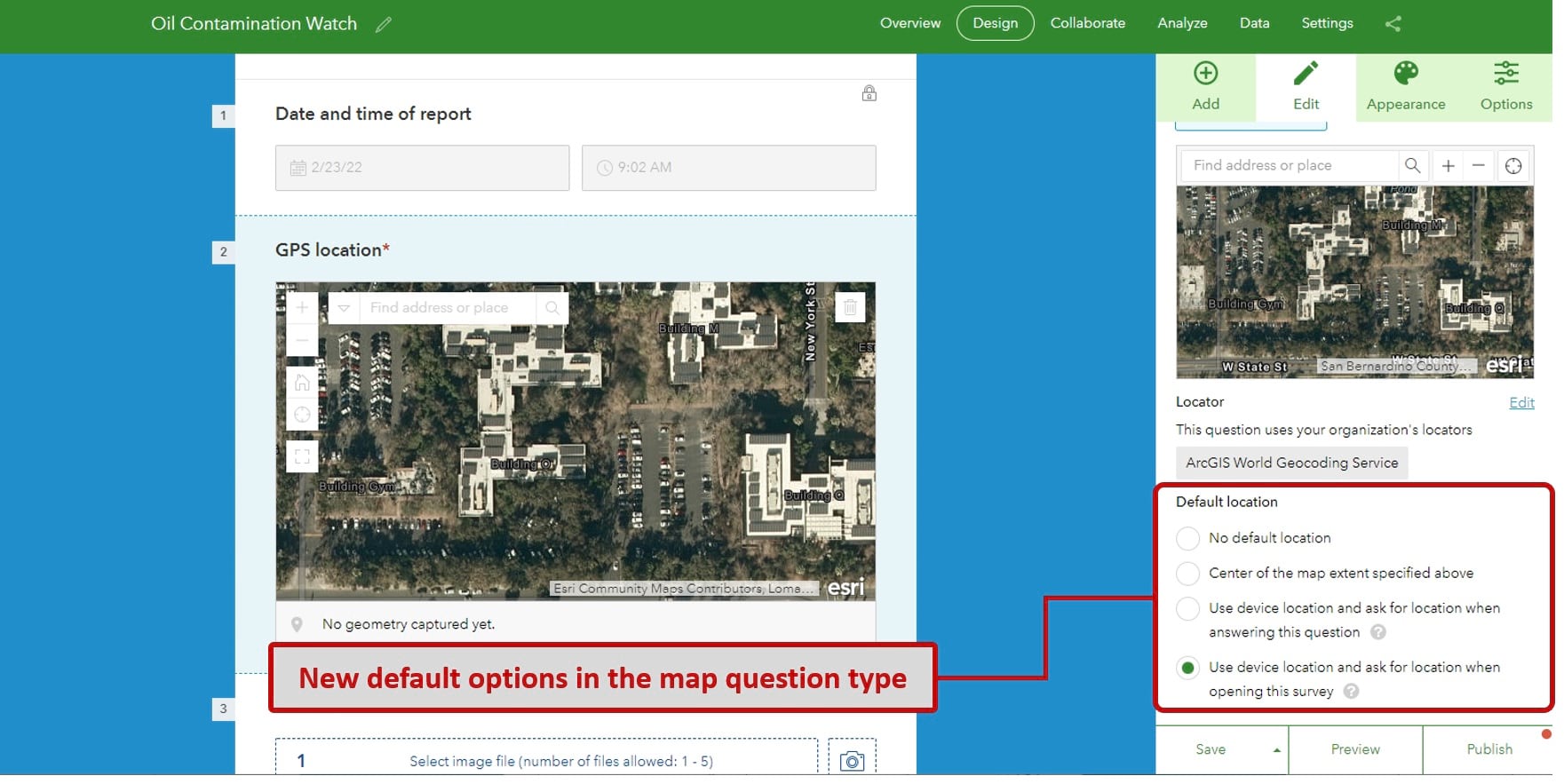

Have your survey automatically get the respondent’s location
Map questions now support various options to determine the default location. Use these options to specify the behavior of your map: Should the map automatically center when the survey is opened? Or when the user interacts with the map? What if instead the map should be centered at a predetermined location?
![New default map locations in designer New default map locations in designer](https://www.esri.com/arcgis-blog/wp-content/uploads/2022/02/002-Designer-New-Default-Map-Location-Options.jpg)
Automatically centering the map when the form loads is something new for online surveys. Combined with calculations, it is a powerful option because it makes your smart forms location-aware.
Say, for example, you create a survey to report issues in your city. Since you know where the user is, you can automatically populate questions such as city, postal code or address where the incident happens.

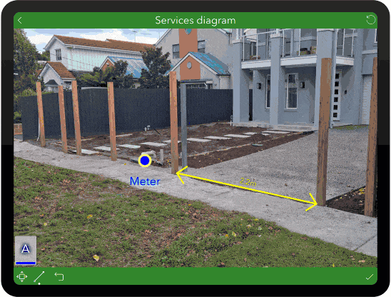

Markup photos, maps and diagrams with custom markup tool palettes
Survey123 includes image annotation tools. With them, users can markup photos, diagrams and maps. We gave these tools an overhaul in late 2021. This update introduces the concept of custom annotation tool palettes.
![Survey123 markup tools Survey123 markup tools](https://www.esri.com/arcgis-blog/wp-content/uploads/2022/02/004-Survey123-markup-tools.gif)

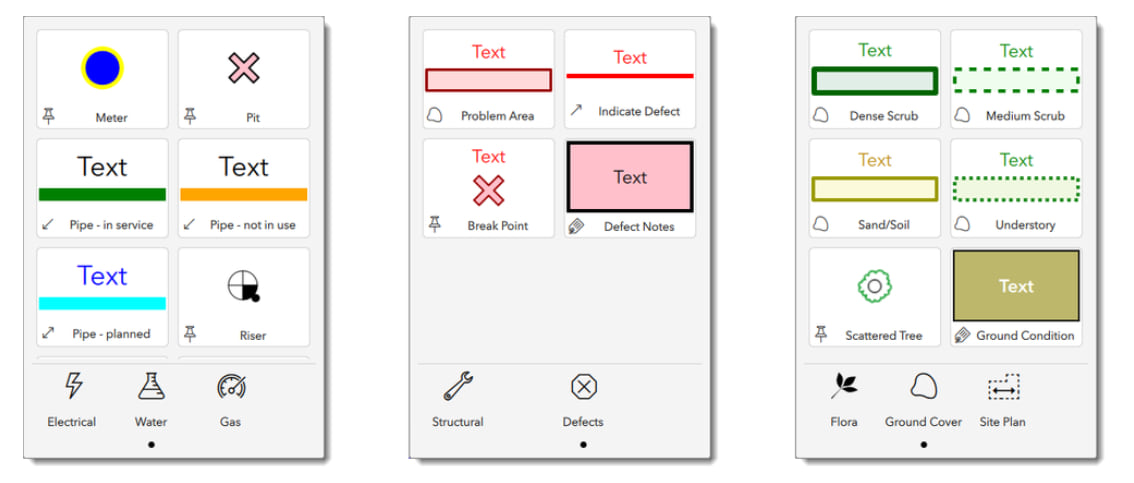

While Survey123 comes with its own annotation tools, you may want to tailor the user experience, so it best fits your workflows. For example, if you are supporting an effort where you know users will markup in a photo the location of existing water and gas meters, you will want to create markup tools for these two features, and nothing else.
Below are some examples of custom annotation tool palettes. Note that each of the tools has its own meaning. They are all categorized logically into separate groups.
![Survey123 custom annotation tools Survey123 custom annotation tools](https://www.esri.com/arcgis-blog/wp-content/uploads/2022/02/004-Survey123-Custom-Annotation-tools-1.png)
Custom annotation tools make image markup more intuitive, but they also help generate more consistent image annotations.
Find more about custom annotation tools, in our documentation and this blog post.
