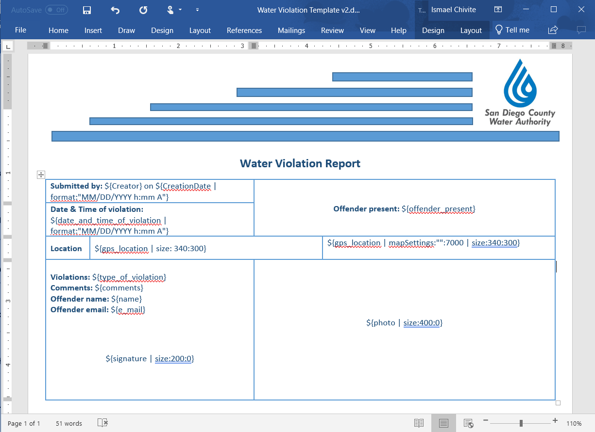

The way you configure your own report templates is quite simple, yet powerful. A Survey123 Feature Report template is essentially a Microsoft Word document with some keywords referencing survey questions.
We chose Microsoft Word because it is a very popular tool that you likely know how to use. Who does not know how to set a header and a footer, arrange a table or define font formatting in Microsoft Word? You can put all your Microsoft Word tricks to work to ensure your report looks exactly as you want.
Templates include certain keywords referencing questions in your survey. These keywords will ultimately be replaced with the data from the survey records you want to report. This is what a report template looks like:
![Survey123 Report Template Example Survey123 Report Template Example](https://www.esri.com/arcgis-blog/wp-content/uploads/2019/09/Water_Violatioin_Template2.png)
The Survey123 Report Template syntax allows you to simply reference data in your survey but also do other more interesting things. For example, you can build conditional logic to incorporate or hide certain portions of your survey record. You can build repeatable sections to loop through related records, and even extract data from attachments and display that information within your report.

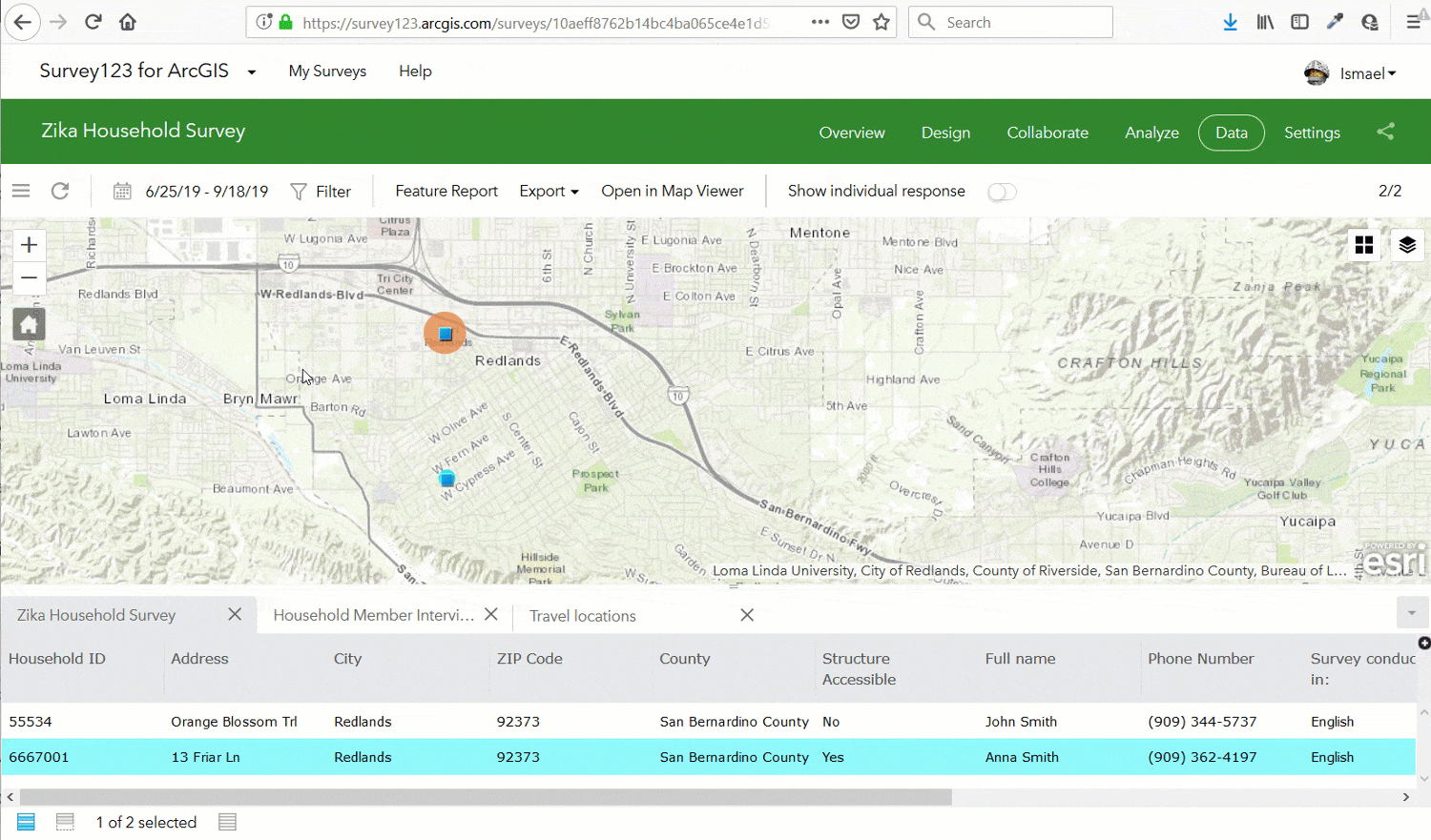

Once your survey has been associated with one or more report templates, you can create reports right from within the Survey123 website. The output file is a Microsoft Word document (pdf outputs coming before end of 2019), which will be stored in your own content. For your convenience you will also be able to download right away the report from your browser.
![Generating a Survey123 Feature Report Generating a Survey123 Feature Report](https://www.esri.com/arcgis-blog/wp-content/uploads/2019/09/Print-from-web.gif)
You can choose to generate feature reports in bulk selecting multiple records or applying a filter to your Survey123 data.
