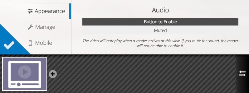

- In Cascade Builder, the audio configuration options for immersive background videos are now Button to Enable and Mute. (Previously, the options were On and Mute.)

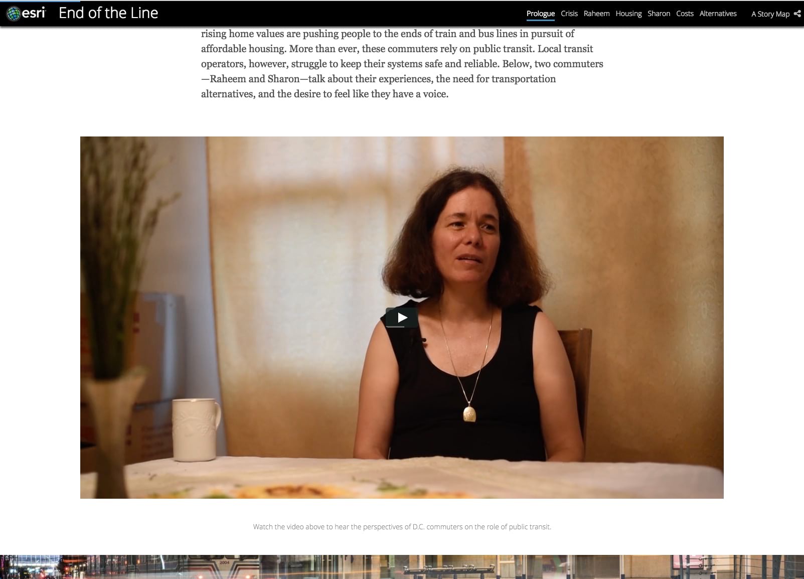

If you have a video with speech or narration, it’s recommended you use it in a narrative section or panel. This is especially true if the speech begins immediately at the start of the video. Videos in narrative sections require readers to click to begin playback, which ensures they won’t miss anything important at the beginning of the video. For example, this story about commuting in Washington DC features video testimonials in narrative sections.
