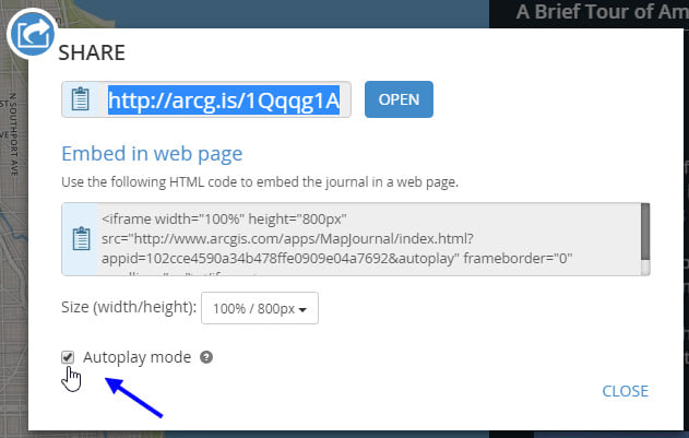

If the Story Map includes a Share link, you can also enable autoplay by clicking the share link
and checking the box.
Checking the box will add &autoplay to both the short link and the embed HTML.

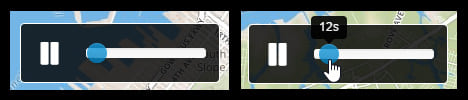

Autoplay control
When autoplay is enabled, the autoplay control appears on the Story Map. Click to pause or play, or grab the slider to adjust the time interval.
When paused, you can interact with the Story Map normally, then click play to resume.
