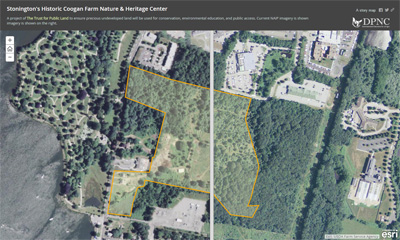

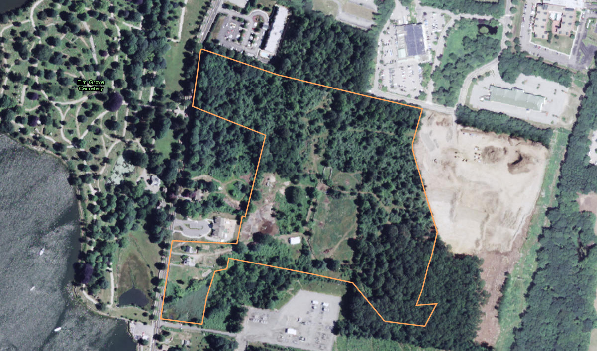

The historic Coogan Farm is an undeveloped 34-acre parcel located near Stonington, Connecticut. In 2013 The Trust for Public Land (TPL) partnered with the Denison Pequotsepos Nature Center (DPNC) to purchase the farm, ensuring it will be protected. The landscape is changing all around the Nature Center, with construction on adjacent properties that can be seen in this screen capture showing current NAIP imagery and the Coogan Farm outlined in orange.
Our goal was to create an easy-to-use, publicly accessible application to show the change around the Nature Center over the past few years. To accomplish these goals the NAIP imagery services and the Story Map Swipe & Spyglass were chosen.

Click to view the completed Story Map.

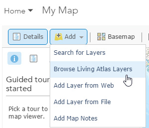

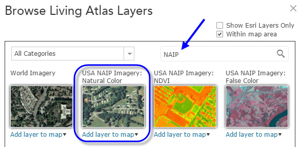

Click Add, then choose Browse Living Atlas Layers:
In Browse Living Atlas Layers enter NAIP in the Search box:

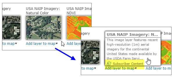

The layer we were interested in was USA NAIP Imagery: Natural Color. Hover over the thumbnail to learn more:
Highlighted in yellow is a note that this is a layer available as subscription content only, meaning that an ArcGIS account login is needed to use or view this layer. To enable use of subscription content for public access, see Step 9 below.

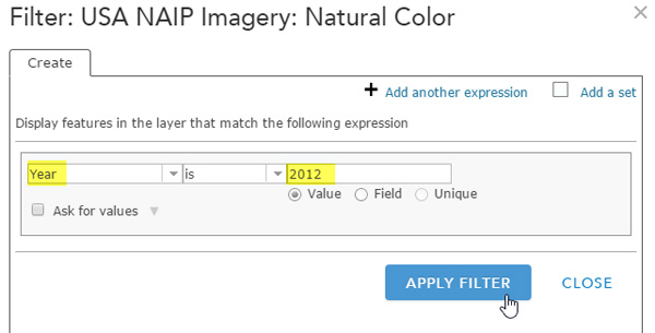

In the NAIP operational layer (the other NAIP layer is the basemap), click the filter icon to open the Filter dialog:
In the Filter dialog, choose Year from the dropdown list of NAIP attributes, and complete the expression by entering the desired year, in this case 2012, then click Apply Filter:
This filter expression will display only the 2012 acquired imagery in the NAIP layer.

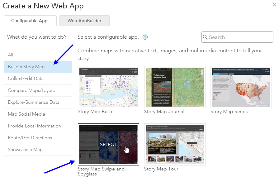

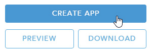

In the Share dialog, click Create A Web App to open the Create A New Web App dialog. Choose Build a Story Map, and select Story Map Swipe and Spyglass.
Once selected, choose Create App:

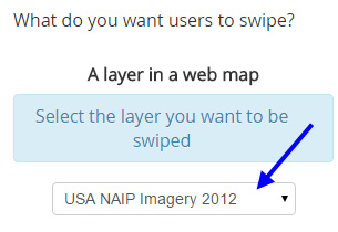

The NAIP layer with the 2012 query filter applied for the swipe layer:

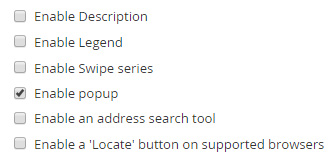

And the following settings choices:

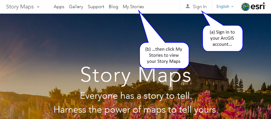

Step 9: Enable public access to subscriber content.

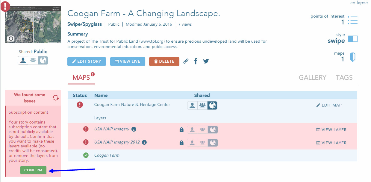

The NAIP imagery services in the Living Atlas are subscriber content, meaning that you need to be logged in using and ArcGIS subscription account (not a public account) to use or view the NAIP imagery (see Step 2 above). To enable public access to the Story Map without a login, go to storymaps.arcgis.com, login with your account, and click My Stories:
In My Stories, click the title of the Story Map, in this case Coogan Farm – A Changing Landscape. The story map will be scanned for errors, and any found will be highlighted. In this case subscriber content is highlighted. Click Confirm to enable public use:

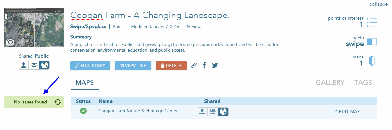

Once confirmed, a No Issue Found message will indicate your Story Map is ready to share with a public audience:
