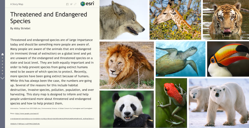

The opening section of a story map created by one of the author's students.
Threatened and Endangered Species is just one example of the great work Mark's students have done with the classic Story Maps.

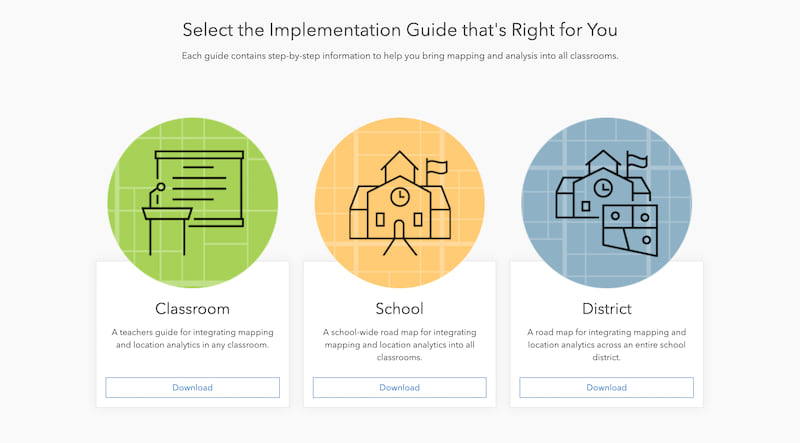

The gallery of options available in Teach with GIS, including classroom, school, and district-level materials
Esri's Teach with GIS implementation guides contain step-by-step information to help bring mapping and analysis into all classrooms.
