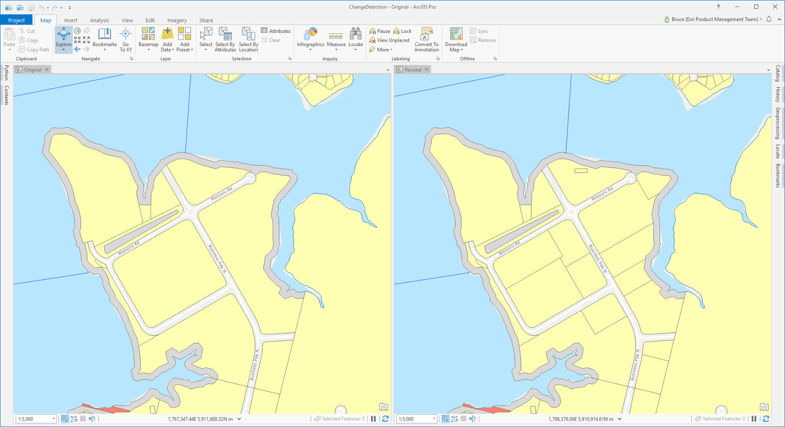

My first example datasets are two parcel feature classes, where one has been revised with survey and subdivision work, but without any edit tracking fields — the data is not managed in ArcGIS. The maps are named for their content, Original has the old data, Revised has the new data.

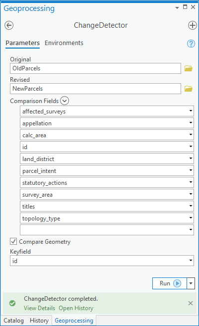

For my parcel data I chose all the attributes to be considered as well as geometry:
![Choosing the attributes and geometry to be considered. Choosing the attributes and geometry to be considered.](https://www.esri.com/arcgis-blog/wp-content/uploads/2019/12/DatasetManagement2.png)

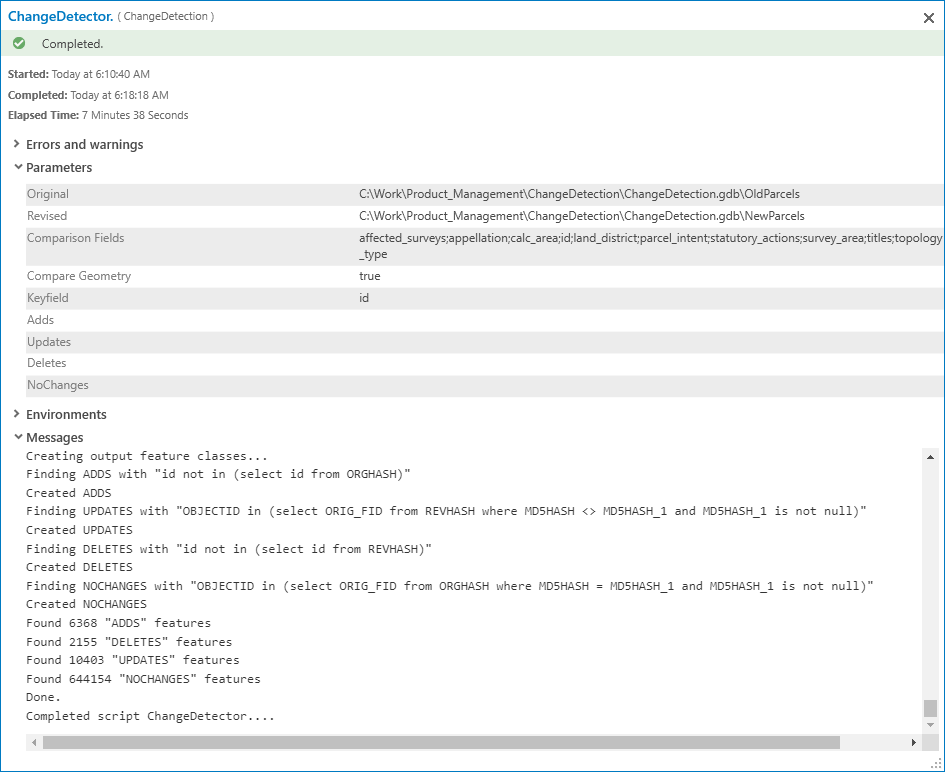

Then 7 1/2minutes later after comparing ~650,000 features per input, I had my change sets:
![](https://www.esri.com/arcgis-blog/wp-content/uploads/2020/01/data3.png)

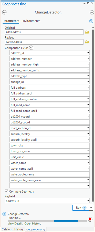

For a second example, I decided to “go big” and compare two street address datasets each with about 2 million features and a lot of attributes:
![](https://www.esri.com/arcgis-blog/wp-content/uploads/2020/01/data4.png)

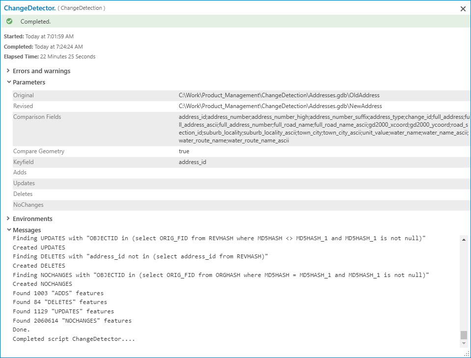

Now, it’s 22 minutes to find a couple of thousand changes to 2 million features:
![](https://www.esri.com/arcgis-blog/wp-content/uploads/2020/01/data5.png)

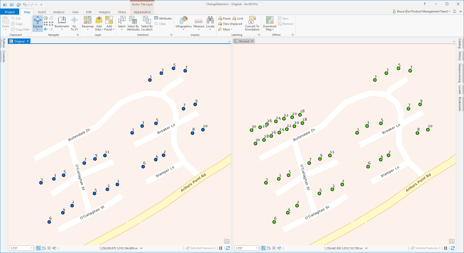

…and in the map, it is easy to find a locality where subdivision has resulted in new addresses being created — see the extra address points in the Revised map:
![](https://www.esri.com/arcgis-blog/wp-content/uploads/2020/01/data6.png)

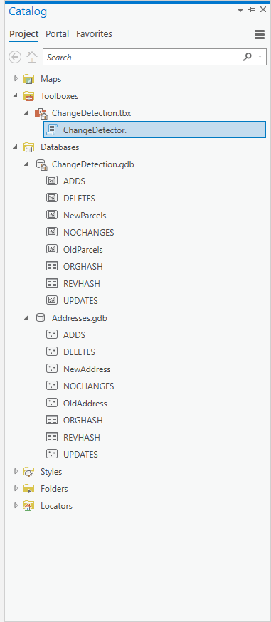

To use the tool, your data must be in a single File Geodatabase. Here is how my Catalog pane looks, note, to preserve my change sets, I used two separate databases in the Project.
![](https://www.esri.com/arcgis-blog/wp-content/uploads/2020/01/data7.png)
