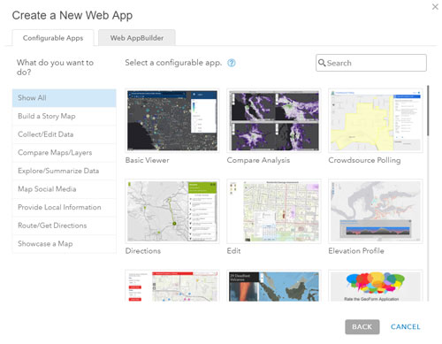

About Create a New Web App gallery
When you save and share a web map, click Create A Web App.
This displays the current gallery of configurable apps. The default collection of configurable apps is authored and hosted by Esri.

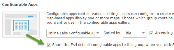

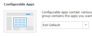

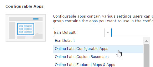

One of the organization settings that can be applied by an Administrator is which apps appear in the Configurable Apps gallery. From the Administrator home page, click My Organization, then Edit Settings, and click Map to view the current settings.
By default, the Esri Default apps are displayed.
You can use other configurable apps by creating a group, adding the configurable apps you’ve created to the group, then choosing the group from the dropdown list. Below Online Labs Custom App Templates is the name of the group containing the custom configurable apps we want to use in our organization.
Note that you can replace, or include, the Esri default apps by checking the box.

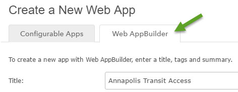

In Create A New Web App, choose Web AppBuilder.
Enter the required inputs, then click Get Started to build your app by selecting a theme, style, and layout. Then add widgets and configure them as desired.

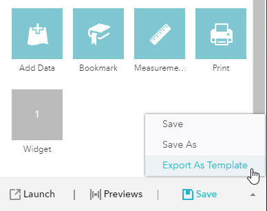

Step 3. Export your app as a template.
When finished building your app, Save the app and click the arrow next to Save and choose Export As Template. The original app used to create the template must not be deleted.

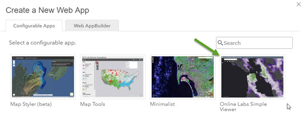

If your organization uses a custom collection of configurable apps (i.e., is not using the Esri default apps), and you have appropriate privileges to add items to your organization’s configurable apps group, the new template will automatically be added and is ready to use. If not, you will see a warning message and the owner of the configurable apps group will need to add your template in order for it to be displayed in the gallery.
Once in the gallery, the new configurable app will be available along with other apps you’ve added.

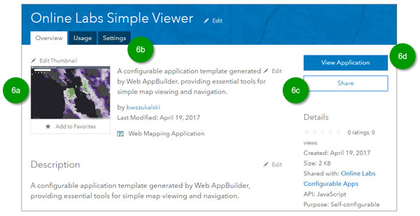

Step 6. Finalize your work.
6a. It’s a best practice to complete the item details for your configurable app template, replacing the default thumbnail, and adding a good summary and description.
6b. Under Settings, set Delete Protection so the item is not accidentally deleted. See How to prevent accidental deletion for more information.
6c. Ensure that the template is shared publicly, so public apps can be made using it.
6d. View Application will open the app using the map that you used while configuring the template. It’s a good practice to ensure that the map’s item details have been completed, and that Delete Protection is enabled for the map.
Note: The app used to create the template must not be deleted. Use Delete Protection to ensure it is not accidentally removed.

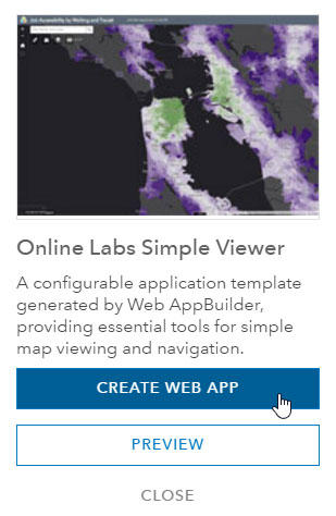

The new configurable app will appear in the gallery.
Click the app thumbnail to choose it, and learn more.
Click Preview, or choose Create Web App to configure the app.Choosing Create Web App opens the app with the configuration panel on the left, showing options as configured in Step 4 above.
