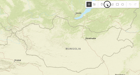

Sketching
The Sketch widget provides a simple UI for creating and updating graphics in a 2D MapView. It is intended to be used with graphics stored in its layer property. By default, the Sketch widget provides out-of-the-box tools for creating and updating graphics with point, polyline, polygon, rectangle and circle geometries. The widget allows users to undo and redo edits, as well as select and edit multiple graphics at once. See the Sketch widget sample to learn more about Sketch widget.
![](https://www.esri.com/arcgis-blog/wp-content/uploads/2018/12/sketch-widget.gif)

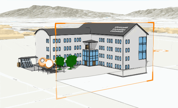

3D BuildingSceneLayer and Slice Widget
Explore the fine details of buildings using the new BuildingSceneLayer. These building models are usually exported from Building Information Modeling (BIM) projects. This new layer allows you to display and hide exterior and interior structures like facades, walls, doors and mechanical systems.
One great way to experience the BuildingSceneLayer is with the Slice widget, which is a 3D analysis tool that can be used to reveal occluded content in a SceneView. The slice widget can be applied to any layer type, making it possible to see inside buildings or to explore geological surfaces. See the BuildingSceneLayer with Slice widget sample for more details.
![](https://www.esri.com/arcgis-blog/wp-content/uploads/2018/12/slice_widget.gif)

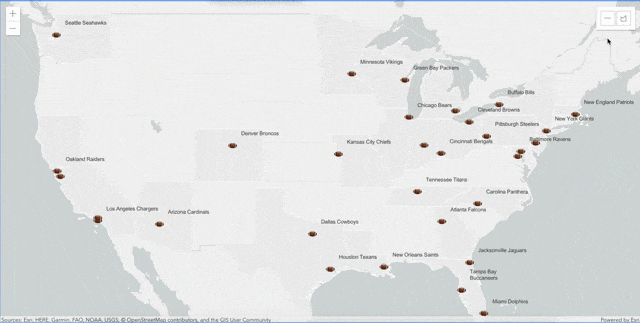

Better Labeling Support
In this release, we added support for labeling lines in 2D MapViews. We also improved the labeling behavior when working with visual variables, and enhanced the labeling priority in 2D MapViews to better match the layer ordering. Lastly, if the TextSymbol3DLayer.size property is not set, the font.size property will now be honored in 3D SceneViews.
