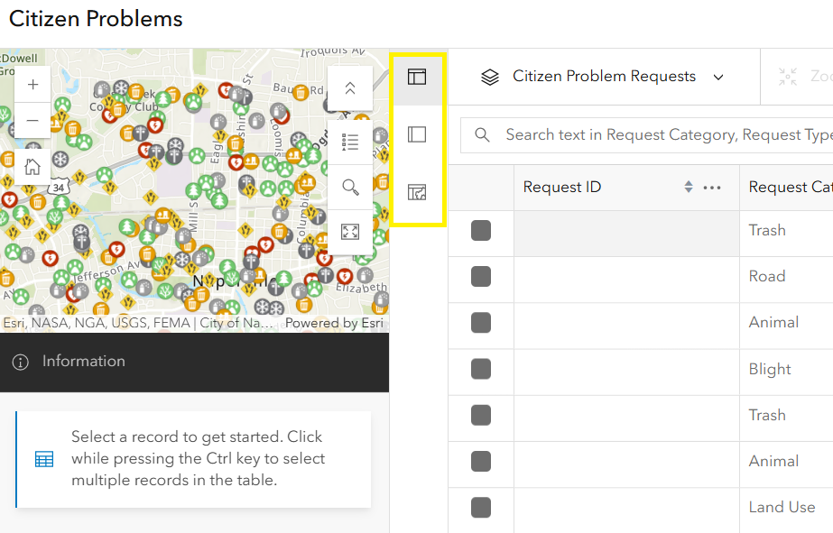

  • The app opens in Split View by default, displaying the map, attribute table, and information panel simultaneously. Users can switch between Split View, Map View, or Table View using the toggle buttons.

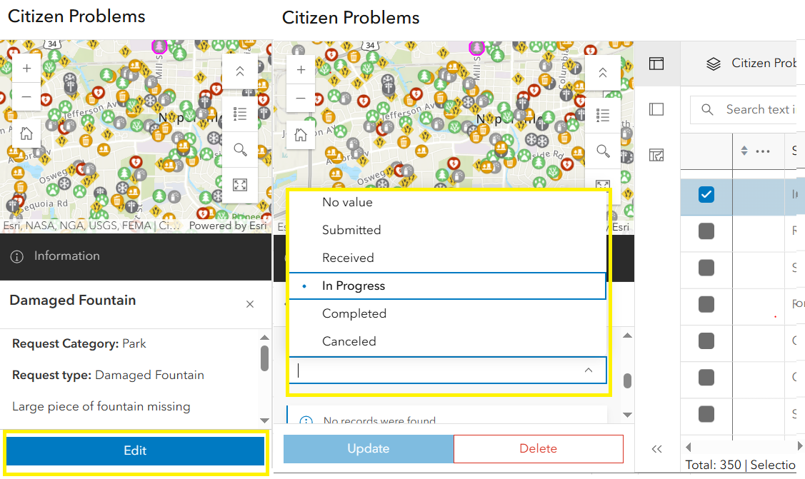

  • To access a specific report, click the feature on the map or select it from the table. A popup will appear with details, including any submitted attachments or photos.
  • To update the attributes, click the Edit button in the popup. For example, change the status of the repaired fountain from In Progress to Completed. Updates are reflected instantly in both the table and popup.

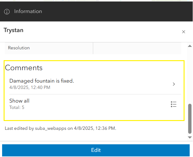

  • To add a comment, make sure you’re in edit mode. Scroll down and click the Add record button. This opens the related records form. Fill in the required fields and click Create. The new entry will appear in edit mode and the popup.

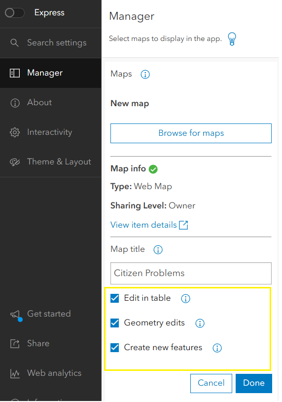

For the workflows described below, app authors can enable the necessary settings from the configuration panel. Select each added map and click the ellipsis (three dots) in the map panel to access options:
  • Edit in table.
  • Geometry edits.
  • Create new features.

  • Enable Edit in table in the app’s configuration settings.

  • Enable Geometry edits in the app’s configuration settings.

  • Enable the Create new features option in the configuration settings.

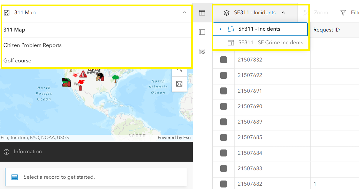

A standout capability of the Manager App is its support for up to 20 web maps within a single configuration. This makes it well-suited for organizations working with a variety of spatial data sources.
  • Users can toggle between web maps using the dropdown located in the map panel, making it seamless to switch contexts without leaving the app.
  • Each web map can include multiple layers, which can be switched using the layer selector in the table panel. Only the layers and tables configured within the selected web map will be displayed.

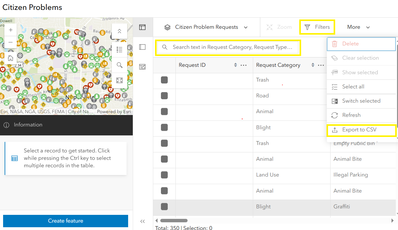

  • Use the search bar to find records based on specific keywords or values, such as a request category. To leverage this functionality, the layer must support full-text search, which is configured on at least one string field. Follow Esri’s documentation under the section “Add a full-text index to string attribute fields” to learn how to set this up. Once configured, users will see a search textbox with placeholder text indicating the searchable field used to filter through the reports
  • Apply attribute filters to refine the data shown in the table and map. For example, filter reports to only show those where Public Access is set to Yes.
  • App users can export the results to a CSV file with just a few clicks—perfect for reporting, sharing insights, or performing additional offline analysis.
