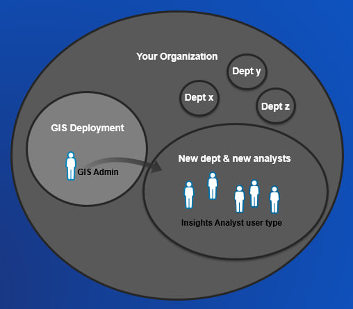

1. Break free from silos
Identify who’s who and break free from silos. As a GIS admin of your ArcGIS Online or ArcGIS Enterprise organization, you hold the keys to GIS software and data access. But the people in other divisions and departments may not know that. Help these other departmental managers understand that you are willing and able to work with them. You can enable them, rather than being seen as gatekeepers. One goal could be to provide an analyst within their division with “self-service location analytics” (aka Insights), rather than your GIS team supporting one-off map or data export requests.
Next, within that new department, who are the analysts that will be using Insights? You can create an account for these folks, and assign them the Insights Analyst user type, which is designed and priced to provide access to just Insights, and that’s it.

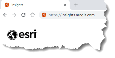

2. Shortcut to Insights
Point new analysts to insights.arcgis.com, instead of going through the portal. When you point new users to ArcGIS Online or ArcGIS Enterprise, it might be a little overwhelming with all the apps and different options. Give your new analysts just one simplified user experience and app, no need to overwhelm a new user with a ton of apps.

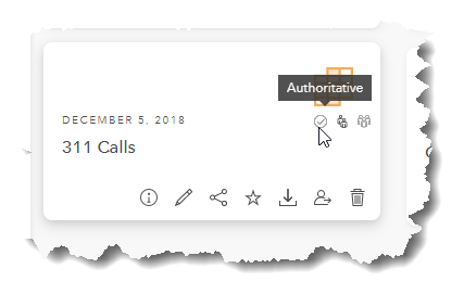

3. Make GIS data accessible
Catalog your organization’s data. Invite these new users to groups, and share data appropriately with those groups, so that when they open Insights, data is immediately there. The GIS content is a hidden treasure chest of data that they have never been able to access before. Previously they’d have to ask you in the GIS group to export them a shapefile – not any more. Remember marking data as authoritative also helps – Insights shows this on the data item cards.

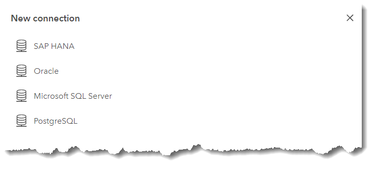

4. Make business data accessible
Create a databse connection and share it as an item to the other analysts. The other analysts can then simply add that connection, rather than trying to type in tedious connection information. This video shows how to create and share connections. Also, work with your database administrator to make sure that the connection properties provide access to the right business tables and data. Insights honors database views that the DBA can create. Also, indexes are important for performance.

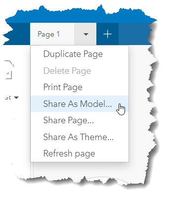

5. Create & share models
Create an Insights model and share it for other analysts to use and learn from. This example should show the value of spatial and do something above and beyond what they were doing in their traditional software analysis package. Some example tools include: geo-enable tabular business data, geo-enrich, spatial filter, spatial aggregation, calculate density, find nearest, create buffer/drive time, and link analysis. Additionally, identify technical subject matter experts within that new division that can continue to create new models and share with the rest of their division.

7. Create & share a theme
Create a theme, and share it. The theme should have the organization’s branding and authoritative look. The new analysts can then simply apply the theme to their pages and workbooks. This also creates consistency among shared reports, so that they are immediately recognizable and familiar.

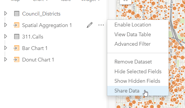

9. Export resulting datasets, for reuse
Emphasize that resulting datasets from analysis can be exported and used in other business systems. Once you share a result dataset as a feature layer, just export it as a .csv or .shp from the Insights home page. Identify some broader workflows where Insights could be an analysis link in the information chain. Data into Insights –> analysis results out –> off to a larger system or process.
